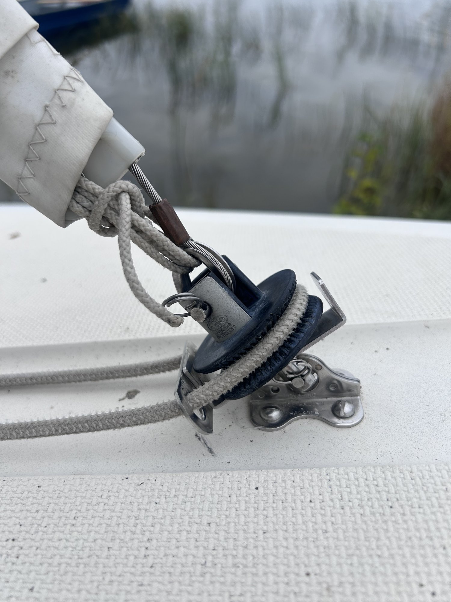

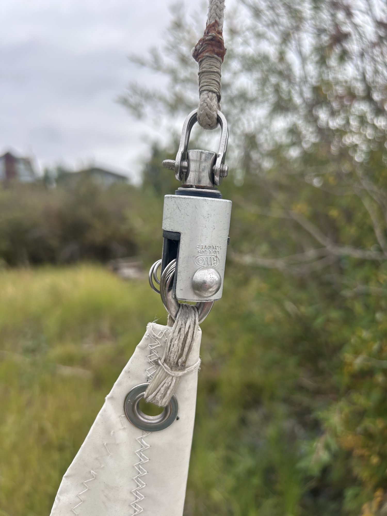

Thanks everybody for your advice - looking more closely I think the forestay is incorporated into the Jib Furler - at the boat there isn't really an extra place to attach the forestay, and there is a metal line in the furler. The only thing that is a bit weird is that means that it is the jib haylard that raises the forestay instead of it being directly connected to the mast. See photos

That is a continuous line furler which is a different style than many of us are used to. The forestay is integrated with the sail. There is probably a wire luff in the sail which serves as the forestay.
