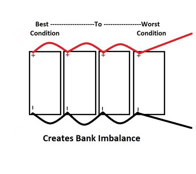

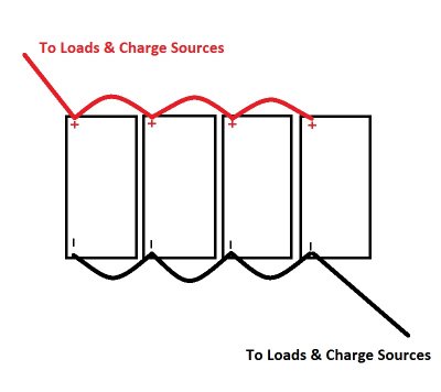

Just thinking off the top of my head:
Suppose two 12V batteries, wired in parallel with heavy gauge wire, one positioned towards the front of the cabin, and another towards the aft. Then the runs to equipment only have to go to the closest battery, which reduces line drop and allows smaller gauge wire.
What are the cons (other than finding places to put the batteries)?
Feb 6, 1998
11,709
If the positive and negative wires are not taken off opposite ends of a parallel bank you will wind up with an unbalanced bank or an intrabank imbalance.
