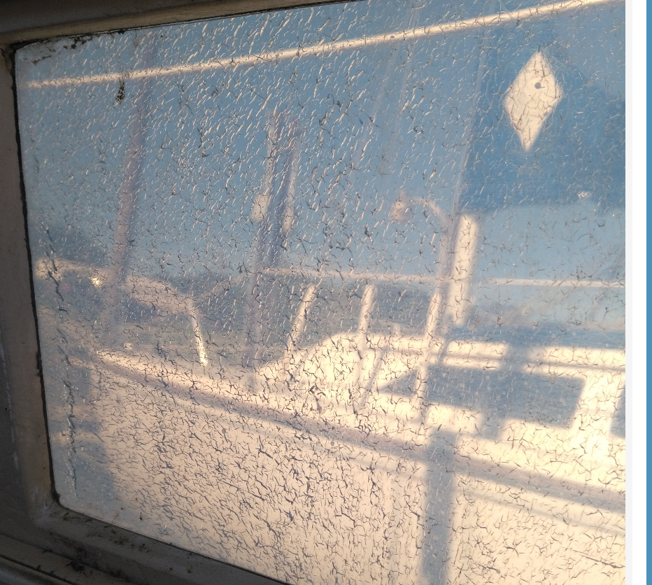

I would suggest being very careful of Simple Green and any other cleaner/degreaser that has petroleum products in it. It ruined my port lights, causing them to become completely crazed over the course of one summer after I used it to wash my boat. Many others have experienced the same. If you go to their web site, they say that it is not suitable for acrylic. Many others have reported the same. https://forums.sailboatowners.com/index.php?threads/simple-green-is-not-simple-it-is-evil.187665/
