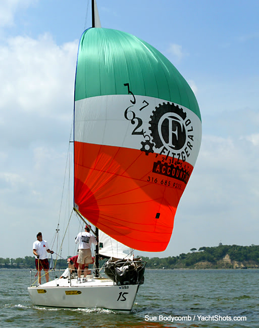

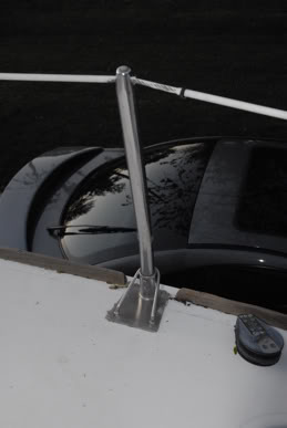

That's great! Hope you enjoy sailing it as much as I did mine for 30 years. What's the hull number? You might consider quarter inch aluminum backing plates for the stations. Especially if they are the "old style" stantions (small base). The old ones had a tendency to cave in the deck if pulled inwards too hard, like when you broach and the 200 # crew member grabs it high (leverage) to hold on up on the high side. I replaced all of my bases with the "new style" that has a bigger footprint. When I did that, I made some backing plates from quarter inch sheet aluminum to further widen out the load under the deck. Never had a problem with them moving or tearing up the deck after that. You can see in the picture the backing plate on the ceiling and I included a picture of the new style stantion base. And added a little eye candy for you to motivate you to get that chute out of the bag!

And, it doesn't get much better than downwind, kite up in a blow with a following sea. Rooster tails off the beam! :D
