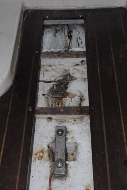

I had my 1979 J 24 for 30 years and loved it. Should have kept it as a second boat for racing. We did the sump job. Mine was rock hard on the surface but had cracks and when we chiseled it out, found some of the vermiculite was mushy beneath the surface. We bought the "kit" from J Boats (now get it from their builder) to repair/reinforce the sump area and replace the cut out floor section with a teak and holly sole. It's not a particularly difficult or technical job but I elected to have "my fiberglass guy" do the work. Never regretted doing it and felt better about having all that sump area exposed where it was easy to keep clean and inspected.

I second the idea of having a survey. If that deck has not been cared for along the way, you will surely have mushy balsa core between the deck and the liner. Can be fixed from the inside relatively easily with no evidence of the repair when viewed from the outside. You can do a "poor man's" survey of the deck by tapping it with the handle of a screwdriver. A good solid deck will "ring"/sound solid but a wet one will sound like you are thumping a watermelon - dull thud and a wet deck when bounced on will feel like the trampoline the previous poster mentioned. Same test on the forward bulkhead up near where the chainplates are attached. You are looking for a wet bulkhead or one that has been wet and is dry rotted. I fixed the problem by installing an aluminum plate on the forward side and through bolting it to spread the load from the shrouds over a larger area on the bulkhead. I did this before the wet/soft bulkhead showed up so in my case, I never had to replace the bulkhead.
Recommend you go to the J24 Class association website and search for the "Buyers Guide/tips for buyers". There should be some documents there that list the things to look for and look out for when buying a 24. Great boat, for sure. Much better than the C22 based on my experience. The buyers guide will list all the modifications that should have been made along the way as J Boats and owners figured out what was underbuilt or could have been built better. Good luck and if you find the boat acceptable, enjoy.
