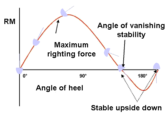

ANY boat will reach an angle (AVS) where it wants to capsize (invert). And stay that way.
True rules say that but any boat will stay totally inverted unless helped by wind, waves, or people. Like in this case.
RACING. Go faster than the other boats. Like any form of racing it entails risk. The crew knew what they were doing.
Nov 8, 2010
11,386
AVS.
You can see that for most boats, at about 110 degrees of heel (AVS) that a boat would rather go over. Once over it is very happy sitting like that, unless forces push it back. At about 160 you get an angle of max INVERTED stability; going back upright you have to REALLY push hard to get it back past this point.

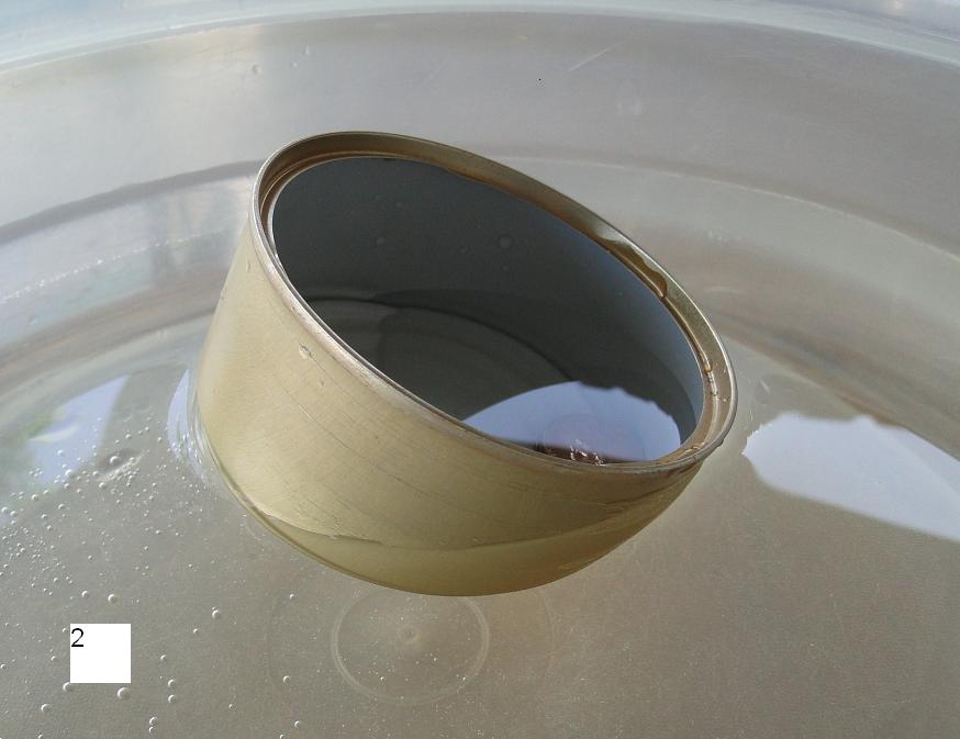

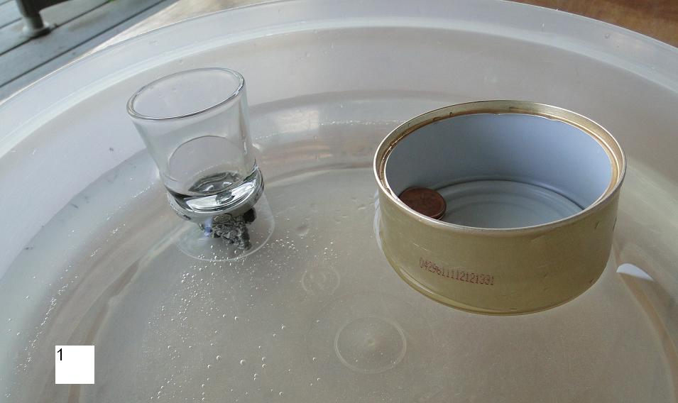

There is another aspect to stability and that is free water inside the hull is very de-stabilizing. I have capsized a dingy and the first time I did this I let a lot of water get inside the hull through a hatch somewhat similar to a companionway hatch. I uprighted the boat but the water inside the hull just destroyed any righting moment. If a boat design allows water to come through the companionway in a knock down, a completely closed hatch is a very good idea.
A couple pictures of a simple experiment show this. The first picture below is a tin can with a penny over to one side. In the second picture, the shot glass was filled and dumped into the can and you can see how the stability was affected.
