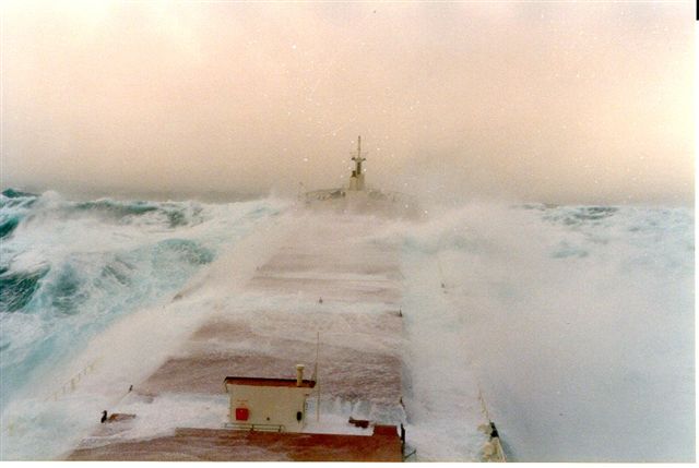

Re. 8 to 12
Have to agree with Maine Sail. Anyone that thinks 8 to 12 is "nothing" has never sailed on the Great Lakes.
Oh, and the forecast:
...GALE WARNING IN EFFECT THROUGH MONDAY MORNING...
...HEAVY FREEZING SPRAY WARNING IN EFFECT THROUGH MONDAY
MORNING...
...LOW WATER ADVISORY IN EFFECT UNTIL NOON EST MONDAY...
.THIS AFTERNOON...WEST WINDS TO 30 KNOTS INCREASING TO GALES TO
45 KNOTS THIS AFTERNOON. WIDESPREAD HEAVY FREEZING SPRAY. A
CHANCE OF SNOW SHOWERS. WAVES 3 TO 5 FEET BUILDING TO 9 TO 12
FEET.
.TONIGHT...WEST GALES TO 45 KNOTS DIMINISHING TO 35 KNOTS.
WIDESPREAD HEAVY FREEZING SPRAY. A CHANCE OF SNOW SHOWERS. WAVES 9 TO 12 FEET.
While the Great Lakes can indeed be quite rough, the photo of the lake freighter in Ed's post is actually not from the Great Lakes. The photo circulated around the web as such. The boat is the Spruce Glen, which normally sails the lakes, but in this case it was on a trip from Florida to Belgium.
http://www.boatnerd.com/
