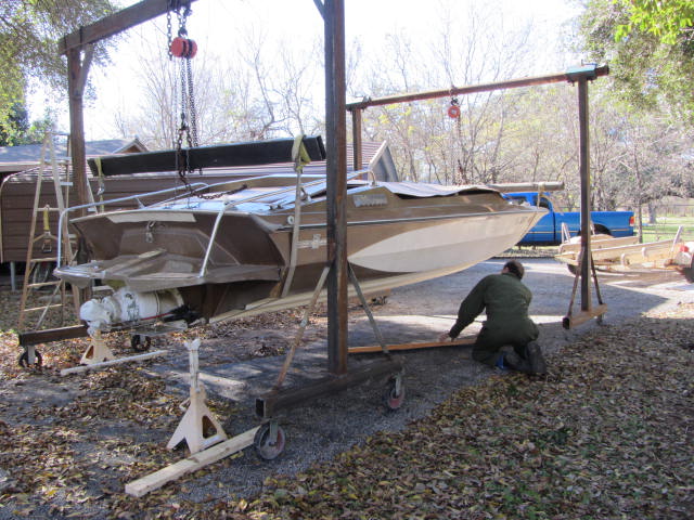

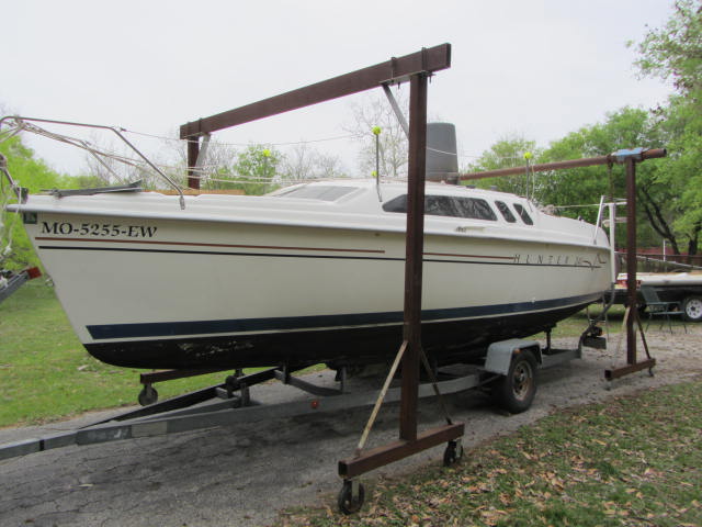

My lift...originally w/ 2ea 1-ton chain hoists for lifting power boats that can be placed on automotive style jackstands. With this boat the trailer must be lifted, the boat secured with 10K tow straps followed by lowering/rolling out the trailer and placing 4X6 beams fore and aft on short cinderblock pedestals shimmed to contact hull. Photo is as the boat sits now, awaiting the second attempt at curing the bracket/roller pin placement question and eliminating the binding interference caused by the suggested lowermost rollerpin position...more to follow

Google "crane spreader bar" for images then make yours to suit the load dimension...steel drill pipe works really well with 10K towing straps under your load
. Always remember to erect the best available pedestal support .. such as timbers and cinder block prior to working underneath.
