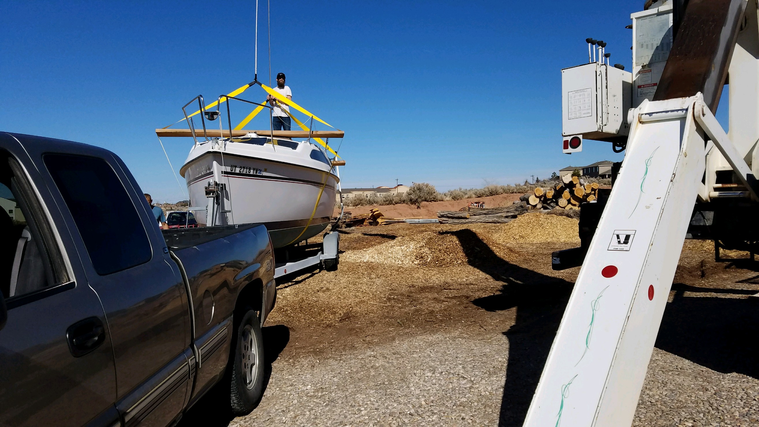

I used some rough cut lumber to spread the straps on the deck use some padding of some kind between boat and lumber. Crazy Dave talked me through some of this process and was a lot of help.

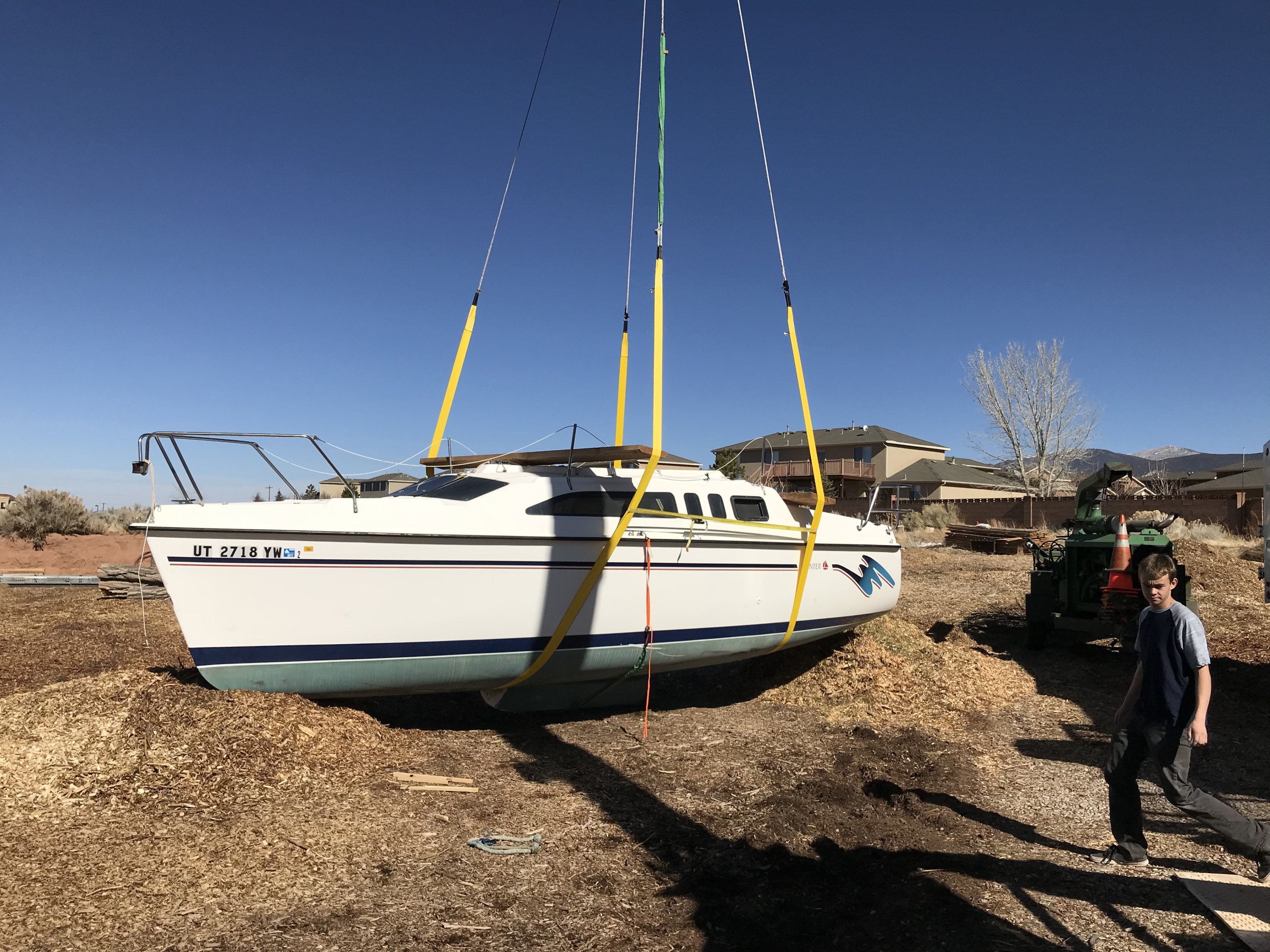

This was kind of scary way to lift but it was all I had.

Don’t rig like this! way to much stress on spreader boards. tried this first and boards started cracking.

Lets see….
A little quick figuring off the top of my head….
I see about a 30⁰ angle on the top of the board to the straps there. Tangent of 30 is about .577. Force towards center therefore = about (1/.577)( down force on the strap). The boat weight is divided across both sides of the strap that goes under the boat, & force from the right = force from the left, so W(1/.577)/2. Therefore, for every 1,000 pounds of boat weight on the strap, the board is seeing about 866 pounds of compression. Sailboatdata says about 3600 pounds for that boat. Assuming that each of the two straps carries equal load, that gives 3.6(866)/2= about 1,500pounds of compression stress on that spreader board. That’s just from the top side of the board. Since the strap doesn’t go straight down from there, the bottom part of the strap adds more stress in addition to that.
Yep, the board might be a bit overloaded. I think that I might have gone with steel tube or at least screwed a couple of boards together to make a composite beam if it were me.

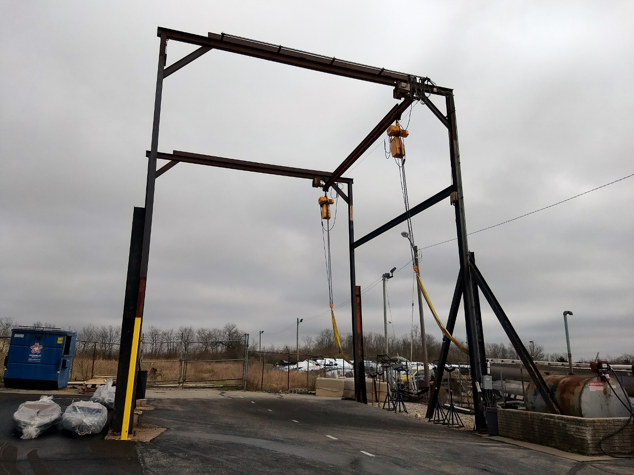

Ruled this lift out after talking to the owner. No spreader bars, and they will not allow any makeshift spreaders to be used. Photo attached. Guess I will drive a couple hours to the closest travelift. Crazy Dave- no need to talk now, but will be in touch, thanks for the offer.

I will make a few comments. First, I would never take a strap around any boat to a single lift point unless the straps are so long that they will not crush the hull in. I have done that just like Jimmy above did with a Hunter 26. Please note the straps were tied together so the straps would not slip from beneath the hull as the bow and stern are curved.
Jimmy also pointed out in the other photo not to put boards out spreading the straps one in front and the other in the rear. Why for several reasons. First it is unstable using two lift points not attached to one another. I would use a metal reinforced rectangular spreader to prevent from crushing the hull in with two straps and again tied together from one lifting point or again only using long straps just like Jimmy did so the hull will not be crushed by the straps. In addition one lift point and of course with a spreader it is more of balancing if anything. I have successfully launched boats much bigger just like the set up with Jimmy over bulkheads and even bridges (permission from highway dept and police of course) with masts up.
Caverun, thank you for the photo. I would have too been concerned just like you but worth a shot. I think a little higher and possibly could have been done like Jimmy. PM Jimmy to see from the deck of the boat to the lift point was when he lifted his boat and then go back and look at that rig again. If close, that of course would be your call.
