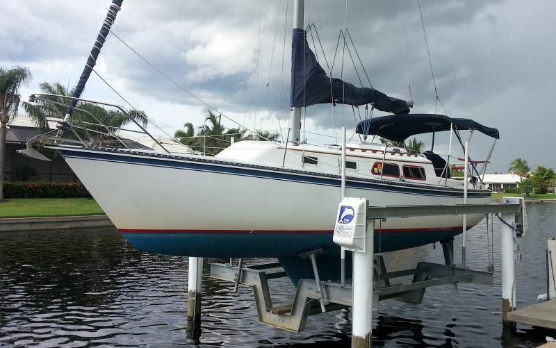

Our lift is similar but actually made for a sailboat. I don't think you can see it but under the board (under the keel) is a medal beam. You can also see the stanchions on the sides that stabilize the boat. As you said most of the weight is on the keel. I have seen people convert existing power boat lifts (like yours) over to sailboats. (no cut down for the keel) In this case they usually put a support beam like you are suggesting (usually medal with a board on top) then they would have longer stanchions than ours to stabilize the boat. I am not an engineer, you just need to be sure that the the boards turned on end would support the boat. I would think that you would want something bigger than 2"x4", Maybe at least 2"x6"s - 2x10"s
Good luck.

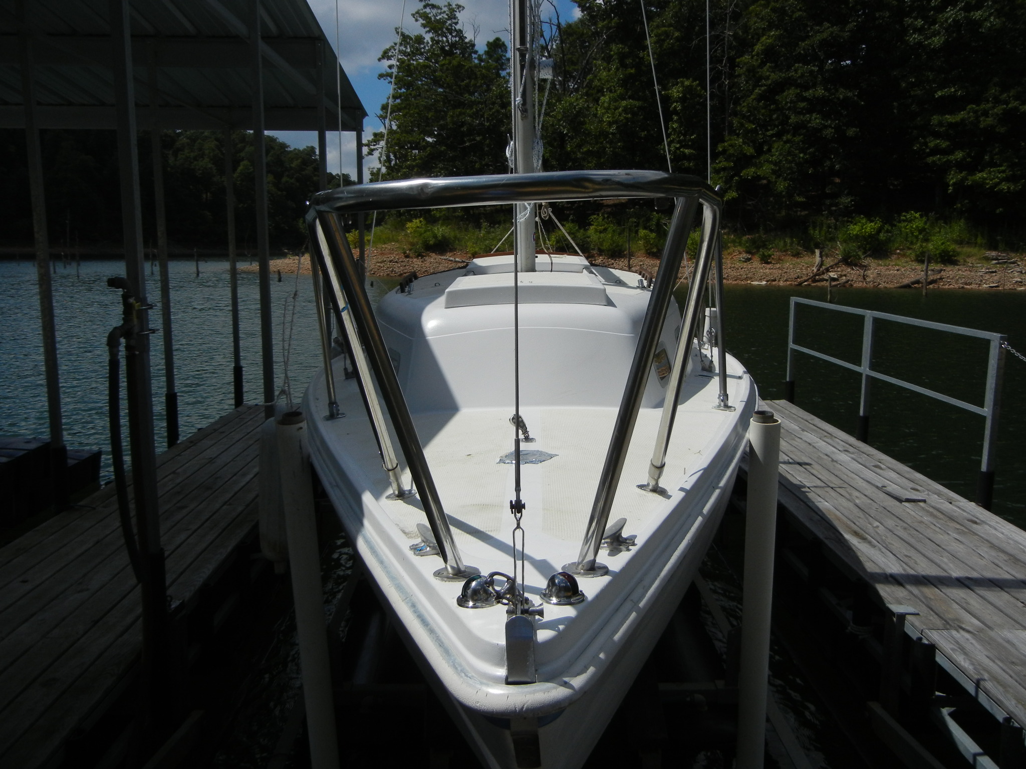

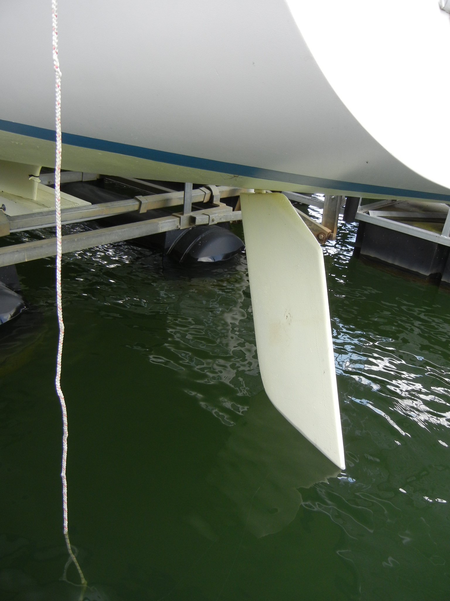

Looking at your drawings added to the photo of the existing boat lift, I would say that 2x4s on end would be over kill if the keel bottom is the size and shape as your drawing and in almost the same location drawn. The two angle iron cross members attached to the outside frame and carrying the whole load of the present lift sitting on the inflatable tubes should carry the load so, that just two 2x10 bolted flat on these cross members would be enough, if these two cross members are of the same weight as the outside frame.
You are correct in thinking the weight of the boat sits on the bottom of the keel. With the keel sitting across the lifts crossmembers then they become the weakest point in this whole sit up. Additional crossmembers would transfer the load to the tubes and the outside framework.

Thank you for your response and photo, McIntoshUSA. I used a calculation chart to determine the weight bearing of the 2X4s turned on their sides and laminated. I got the idea from a sailboat trailer I saw online. According the chart I used, the boards should be adequate for the boat weight, but I will double check that again, just to be sure.
Great photo of your lift. Our lift does not have the recess, and the boat will sit high above the waterline. I hope that does not present a problem. The only way for us to get into the boat while on the lift would be to use a ladder. We will probably lower the boat before getting on board.

I would modify the entry end cross beam to something similar to MacIntosh's mechanical lift, This would allow you to lower the keel block to sit between the cylinders, rather than above them, It should add stability and reduce the pressure on the bunkboards.
You would have to build a channel to guide the keel into position.

Thank you for your response and suggestion, Joe. That channel would certainly be more ideal, but that modification would be difficult to do with the lift already in the water. At least three cross members would have to be cut and new V-channel steel welded in place. Also, we may need that space between the tanks to add additional flotation to the lift. I think we may
I have a neighbor with a setup like you are proposing. It is not a problem. It just means that your stanchions to support the sides of the hull need to be longer.

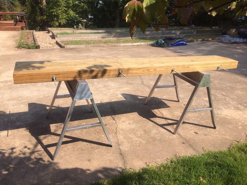

Stub keel support platform
Here is a photo of the stub keel support platform we will attaching to the center of the lift. I went with four 4x4 treated posts instead of 2x4s. Glued and bolted together. It has to support 3000 pounds. This platform will sit on 2.5 inch angle steel spaced 53 inches apart.
