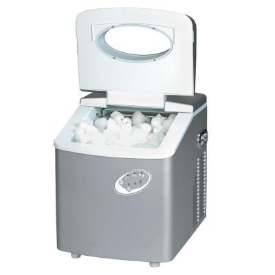

Anybody who adds weight to a boat that is NOT a battery has some serious rethinkin' to do! :)
Absolute nonsense!
The only sane way to counterbalance a list is to add this essential equipment on the opposite side:D:D
weighing 46 lbs, it makes 35 lbs of ice/day. "Worth it's weight..."

Absolute nonsense!
Ach, you're SOOOO right, Don.
Always room for a better mousetrap, as long as it's not the head! :)
7,994
The only sane way to counterbalance a list is to add this essential equipment on the opposite side:D:D weighing 46 lbs, it makes 35 lbs of ice/day. "Worth it's weight..."
Amen. Considering the tons of ice I've hauled to boats over 30 years, that is an essential piece of equipment. "Cut the ends off your toothbrush, Honey, we've got an ice maker!"
