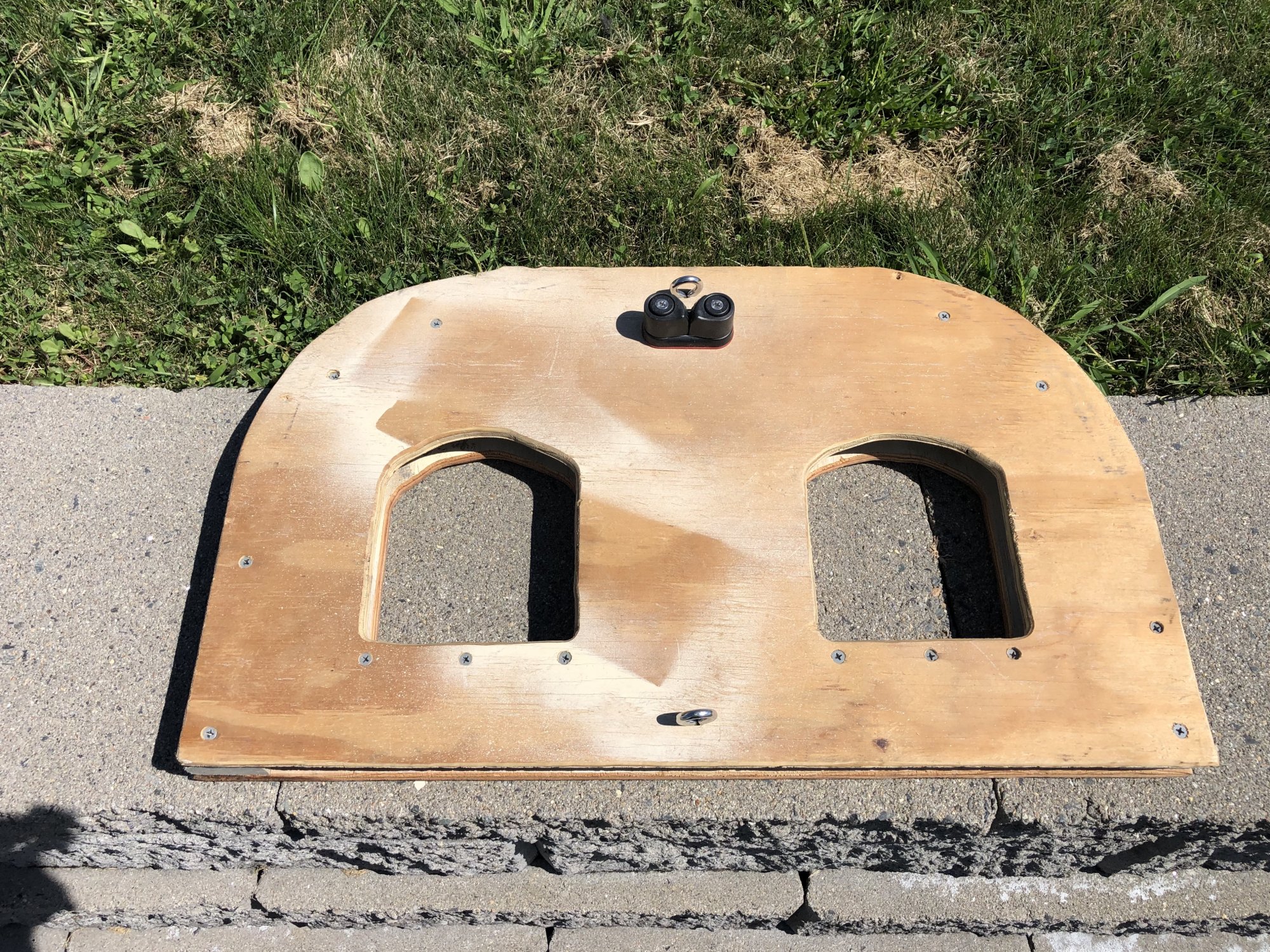

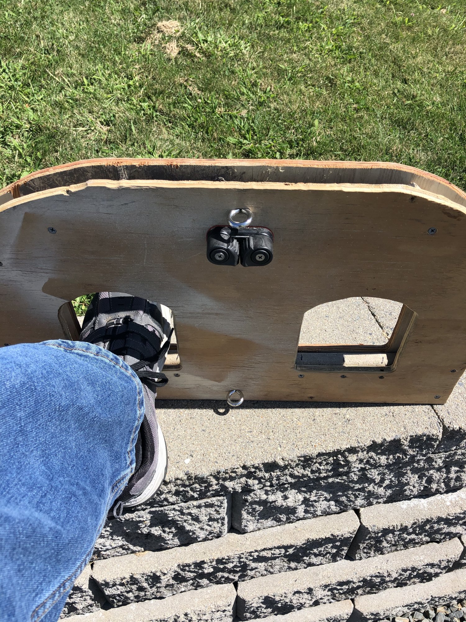

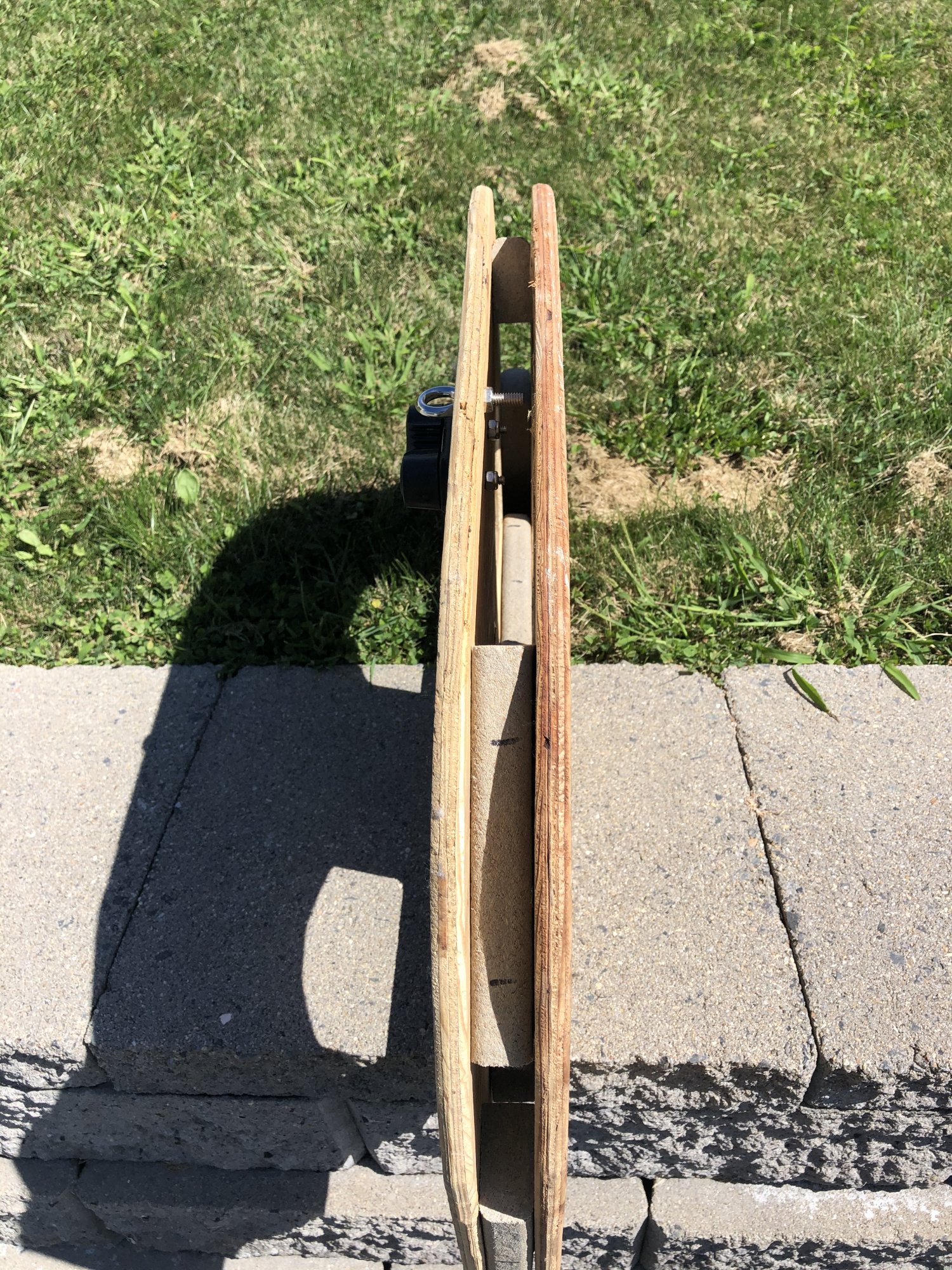

My text did't attach... So, top pic is the climbing board showing foot cut outs, eye bolt above cam cleat and eye bolt bottom of board. 2nd pic is the width. Spaced with spare composition deck boards ripped down. This doubling adds stability AND protects the mast from the bolt threads. Last pic is a foot in the board.
How it works: Run a line ( halyard) thru the top eyebolt , into the cam cleat and thru the bottom eye bolt. Make the line fast and taut .Sit in a bosun chair with feet in cutouts of board. Lift the board with feet.Stand up and take up the slack in chair. SIT, raise feet again, stand, take up the chair slack, sit, raise board with feet....
You are using your legs to ascend the mast.
So you are basically free to swing around and slam into the mast or out around a shroud, because both your feet and arms are occupied?
