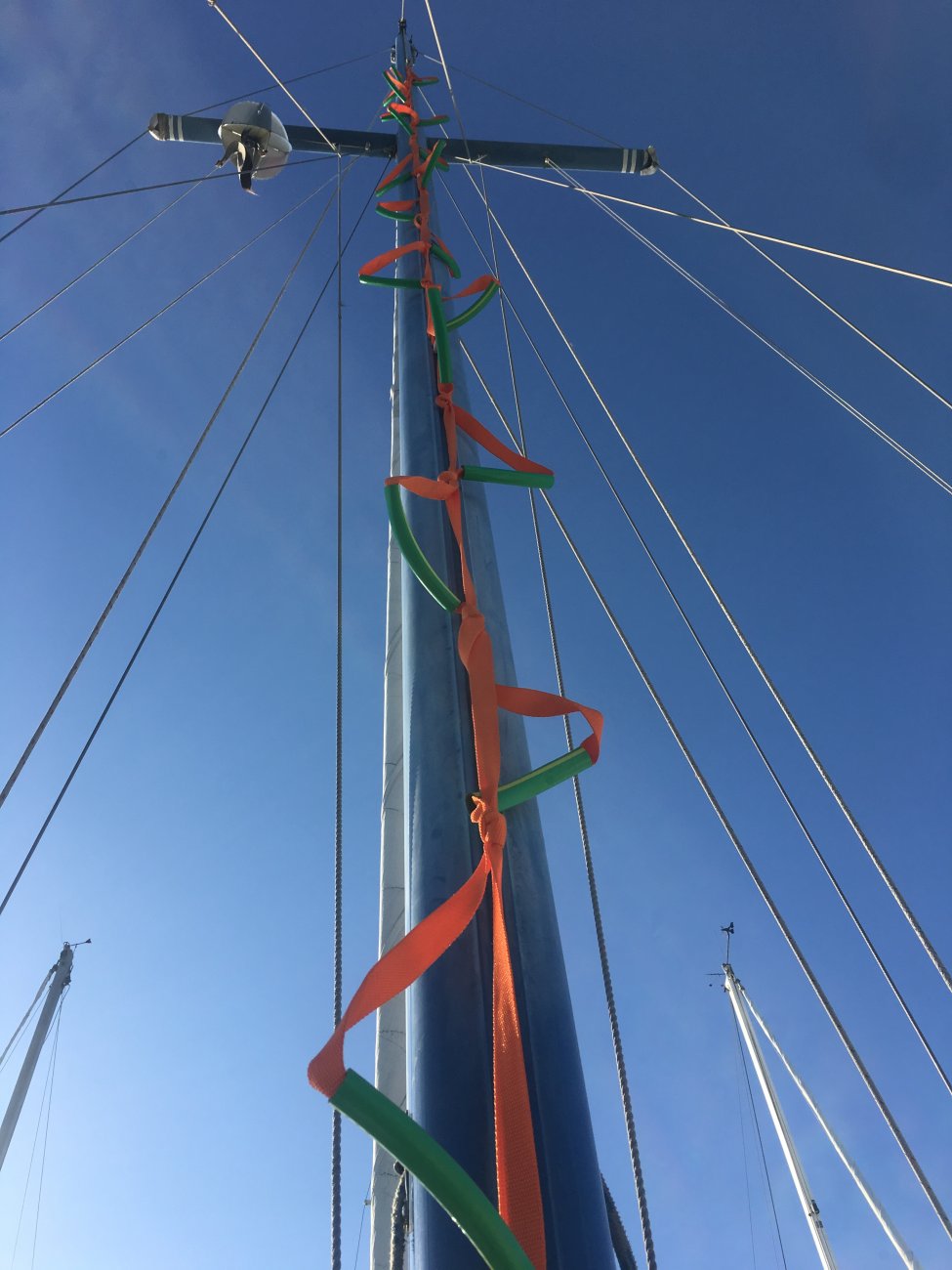

I’ve been reading and researching a lot and settled on a DIY “Mast Mate” style method. I used 1” webbing doubled up using the Etrier ladder instructions and some cheap garden hose as foot steps. I still need to add another ten feet of rungs to make it all the way to the top from the bottom, but it’s looking like it should work.
I’m planning on using both a harness and bosuns chair clipped to two different safety points on the way up, a Prusik knot for ascending and fall arrest, and another halyard attached with my wife at the bottom keeping it tight and cleated. It should solve the problem of having to be hoisted and the slow tedious work of trying to ascend a rope. 65D62BC5-706C-4EF6-B0C8-349E0E8A04A3.jpeg

Think about how your system is going to function after you load it if you fall/loose footing. The details were very basic so forgive me but cleating off the belay (what your wife will be handling) will require her to unload the rope enough to uncleat it in this case. Even if it is wrapped on a winch. Think about how she is going to raise you to get to the next upper step, unload the prusiks or lower you all the way down. Have a system that promotes safety going up, going down and rescues you in the event of a emergency. Again, forgive me if I'm preaching to the choir.

I've got this pretty well laid out. Maybe I didn't explain it very well (which is often the case!)
Mast Ladder is just the main method of effort to ascend or descend.
Prusik attachment to harness/chair on another fixed halyard - My own safety/fall arrester
Wife taking slack on a completely different halyard/winch. - Just an extra precaution.

Finally concluding the results of my DIY mast ladder. I actually tried it. I used a double harness for safety and two halyards with ascenders attached.
My finding was that having a sail slide every 5 feet NOT enough. In between the sail slides (about 5 feet in my case) caused the web ladder to be able to move away from the mast too much and was very scary trying to find your footing.
So, as is, it was a TON of work to get up to the top, very daunting, and I wouldn't want to do it again like that. I have decided that if every step had it's own sail slide, it would be much easier to climb, and a waist lanyard like the telephone pole guys have, would allow your hands to be free and still hang-on so you can rest on the way up.
I plan on re-doing my ladder with sail slides and trying the waist lanyard next time I do it.
