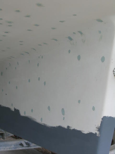

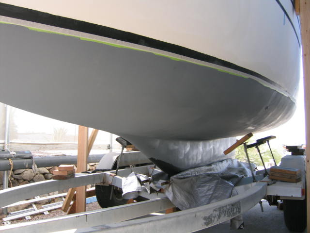

One persons blister problem is another persons entertainment. Of course we did buy this boat for $1000 and enjoy bringing boats back to life.
