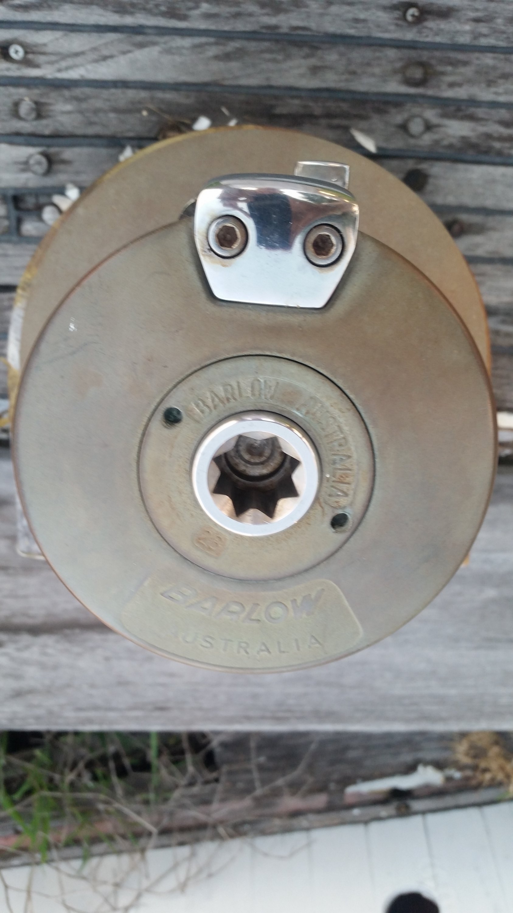

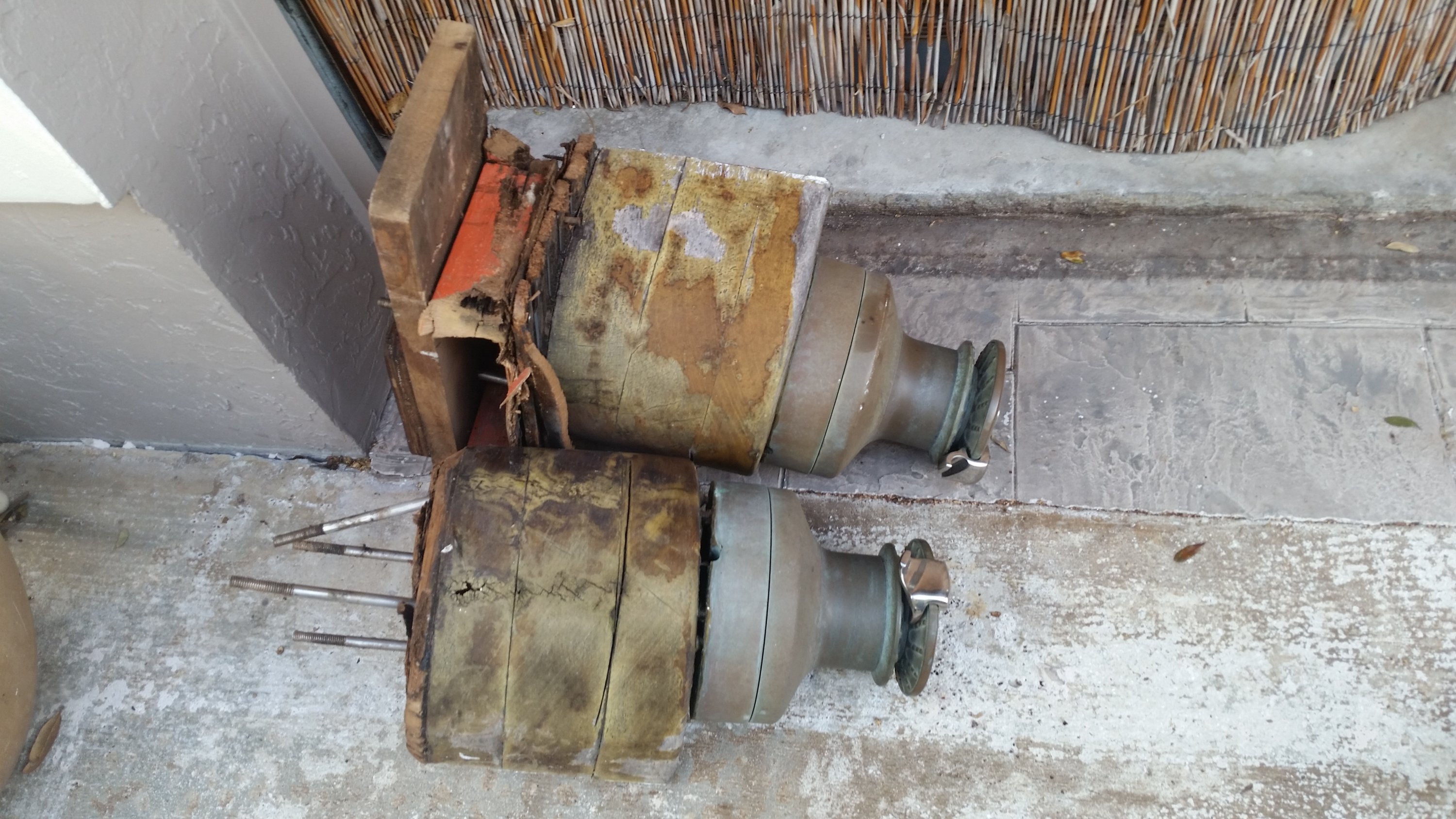

I just measured them, and the bases are 8" across. I need to check if they will fit my boat (1983 H31) they may be a little too big. If they wont fit I will restore/refurbish to sell, and use that money to buy self tailers that do fit. They seem to work perfectly and spin easy. I will probably just clean them and repack the bearings. If I am going to use them myself, I am going to buff/polish them up. But if I need to sell them do you think it would be better to polish, or leave patina?

BTW.... I can't tell the size from the pics but they look big.
Barlow 25s are indeed big. Two speed and about 30 lbs each, the size of a current Lewmar 44.
That is one of the first self tailing winches.... IIRC the wiper and the top of tailer are fixed, making the whole deal a lot less efficient at holding. Later designs with floating wipers are much better. But nice find!
Jackdaw,
These are 28s not 25s and they weigh a lot. I cant even find pictures of them online, let alone specs or manuals. Someone on Ebay has a pair of Chrome ones listed, but no real specs

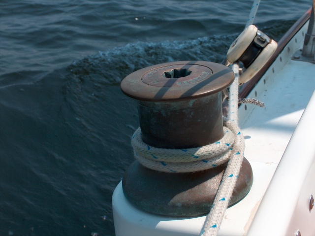

Funny how perspectives change. When I was younger, I wanted bronze to look new and shiny, but it's impossible to keep it that way on a boat, unless you polish it incessantly. Granddad tried to spray clear coat of various types sometimes, or varnish right over, but it never lasted long.
Now, I look at the brown patina on bronze, and I rather like it.
As for the OP's purpose with that winch, I think fully cleaned and restored to working order, and for the intended indoor purpose, polished as it is, it looks very nice. And I fully appreciate the work to get it to that place.

Crap, I measured the boat over the weekend. The bases on these winches are 8" and I only have 7" of deck width to mount on so it looks like I will be restoring them to sell, and using the money to buy some self-tailers that actually fit my boat.

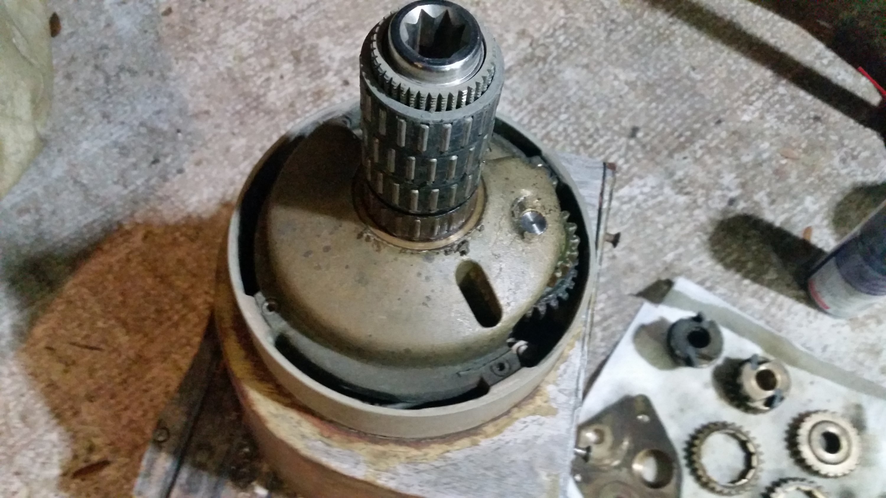

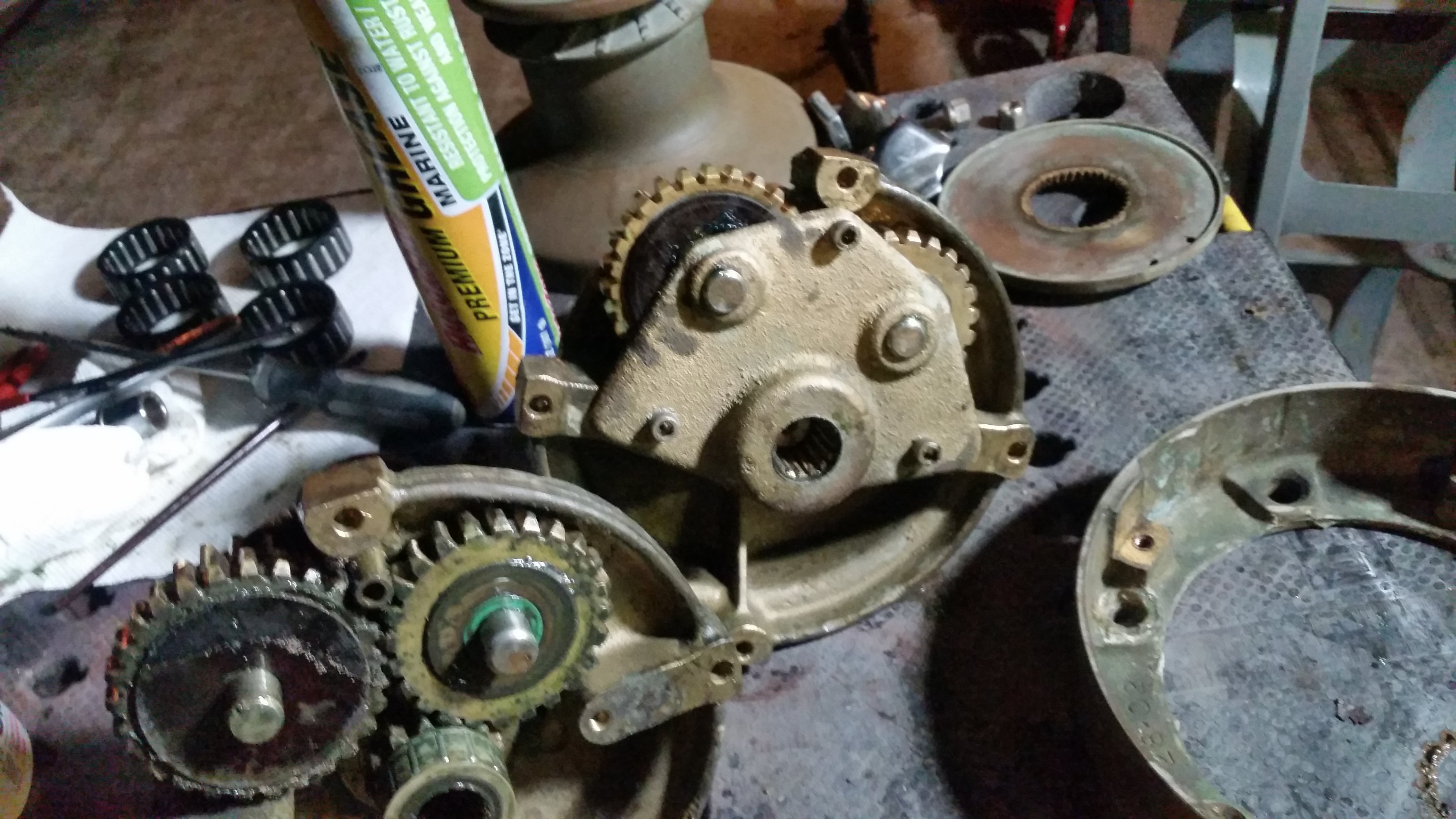

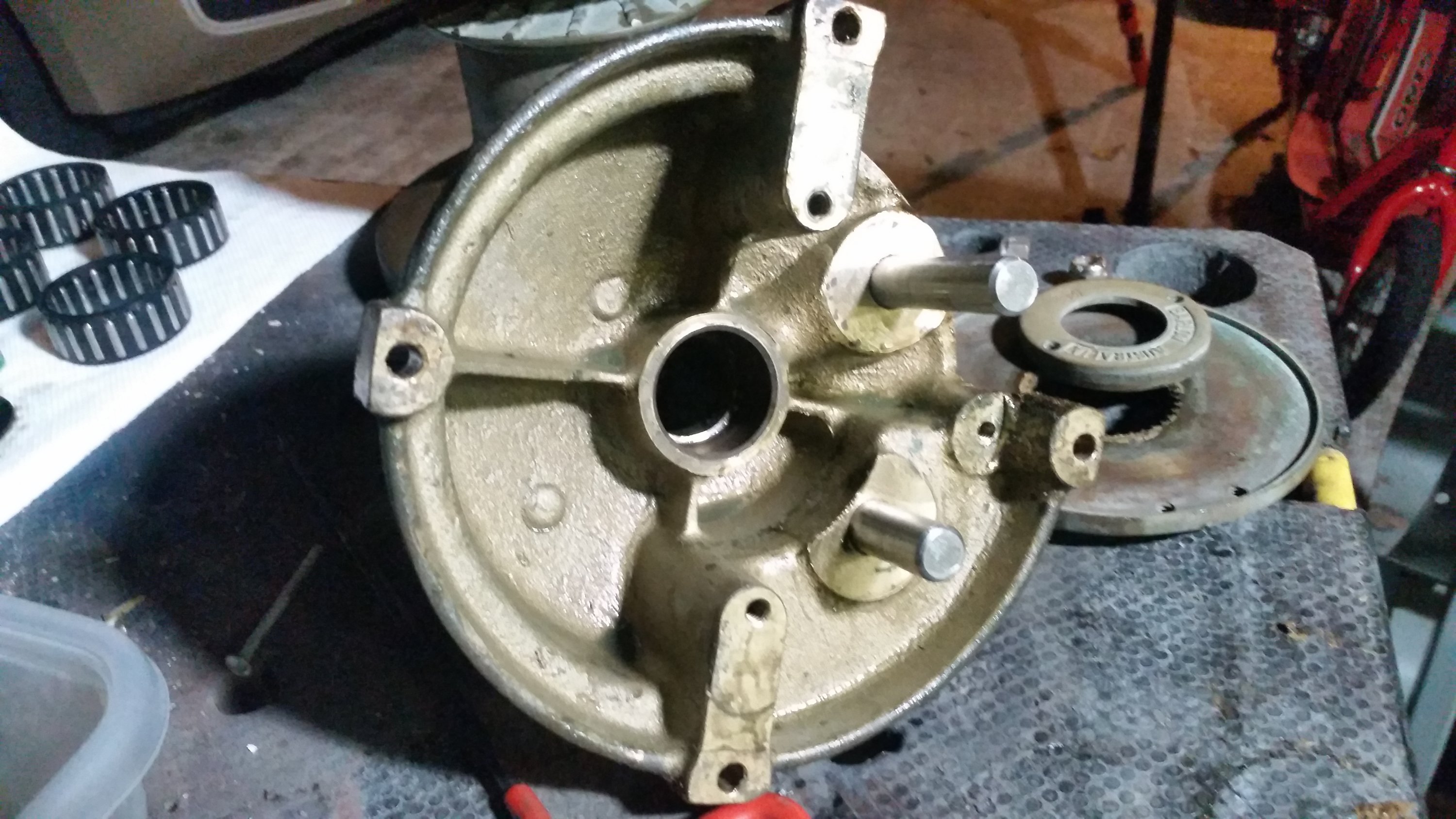

So I got time Wednesday to pull them apart and service them.

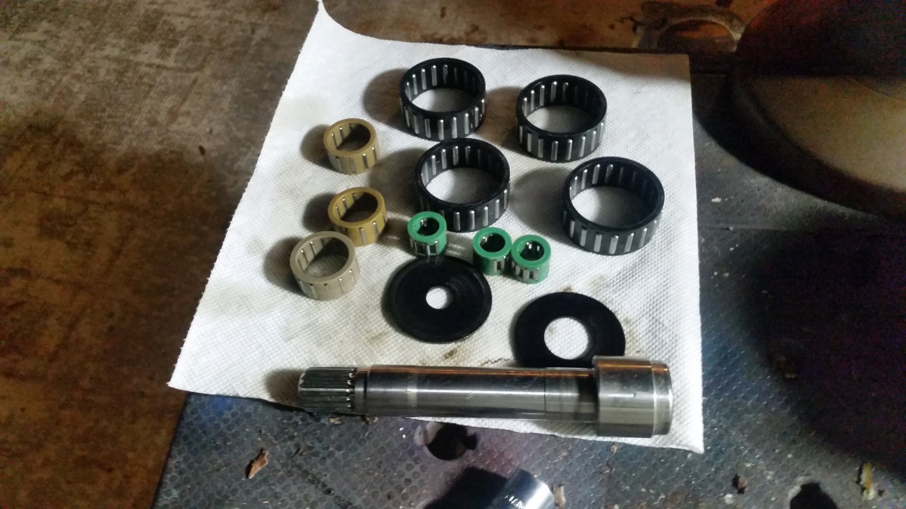

Gears and bearings were in great shape, just needed cleaning
They went back together very easy. I did them one at a time so that I had a reference for reassembly.

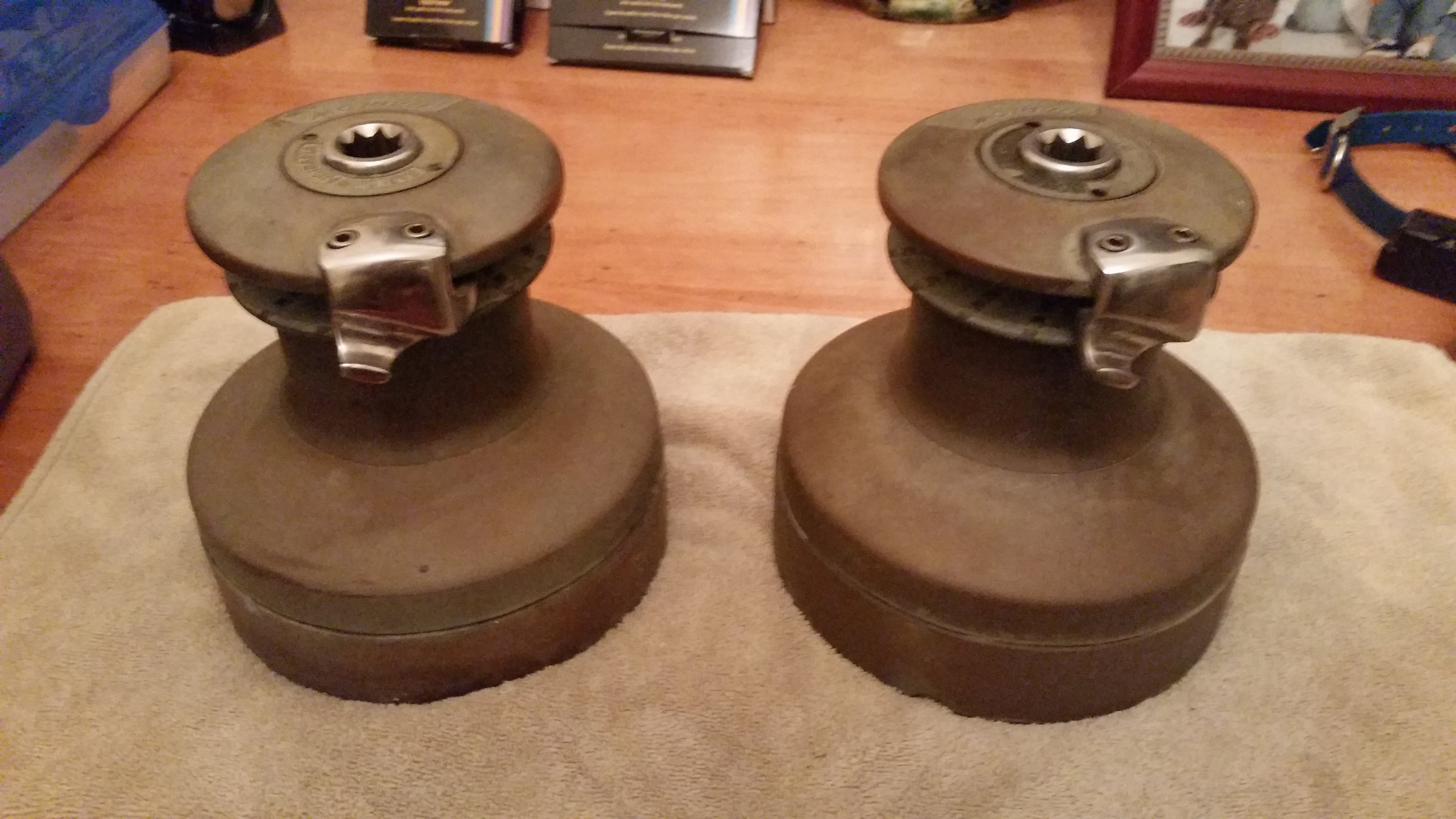

They turned out nice.
I think they would polish up wonderfully, but I will leave that decision to the next owner. Putting them up in the SBO Classifieds.
