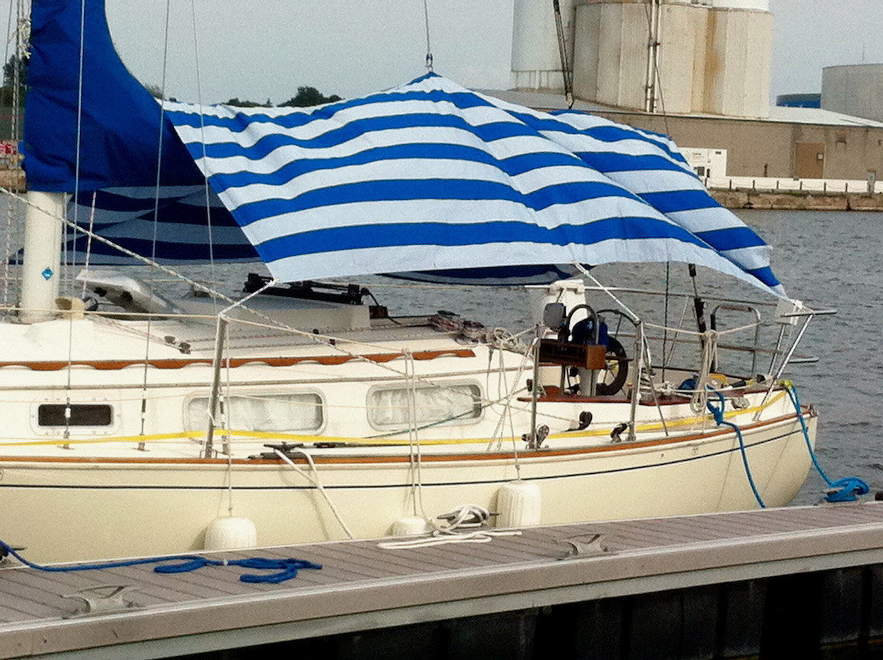

Do you want shade while sailing or shade while at anchor? or both?
For shade while sailing a Bimini is hard to beat, however, as you note on some boats this limits head room in the cockpit and leaves much of the cockpit exposed.
For shade at anchor or at the dock, consider a boom tent. This is a tarp stretched over the top of the boom and can extend from the mast aft to the back stay. A boom tent really helps to keep the cabin and cockpit cool, but you can't sail with one up. The attached photo shows one I made. It is not yet complete, just a test fit before adding spreader poles. When it was completed there were 2 aluminum poles at the fore and aft ends to hold it out.

I guess it depends whether you spend more time sailing than sitting in the cockpit at the dock. As nice as it is to have a cover at the dock, that blue and white one looks like more of a pain in the ass to crawl in and out of, than the shade is worth, especially if you aren't 22.
if you are going to have a dockside or at anchor shade, spend a few extra bucks and make it easy to get in and out of. I sailed for years w/o a bimini (before they were invented) and would never willingly do it again. After 50 years in the tropical sun, I assumed I was pretty much immune to skin cancer. I assumed wrong.
That is a great idea. I am mostly concerned about shade in the harbor. I was looking at the halyard shades as well today. They are kinda neat as well.

14,056
As rigged in the photo, is it a PITA to crawl under. The photo was from an initial fitting. Three poles were added that ran athwartship which made access much easier.
