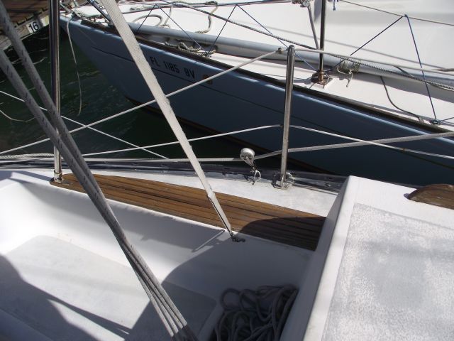

Jorge, on my 30 the straps (white) extend from the bow through slots in the canvas and clip to the stern pulpit on the top railing with eyes attached to the top of the rail. The forward straps clip to the toe rail, both with SS strap clips. I think the pic shows the approach angle forward (but not the actual attachment).

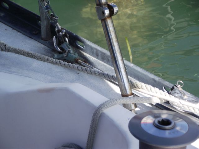

On my 33 the back of the bimini is attached to the stern top rail and the front is attached to two small "u" brackets screwed into the cockpit seat backs near the front of the cockpit. Don't put them to close to the front as you need room to step out of the cockpit onto the deck from the side. I will take a few pictures when I am next at the boat and also show how the safety lines are attached low to make boarding easier.

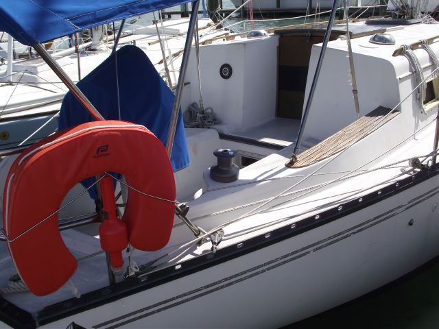

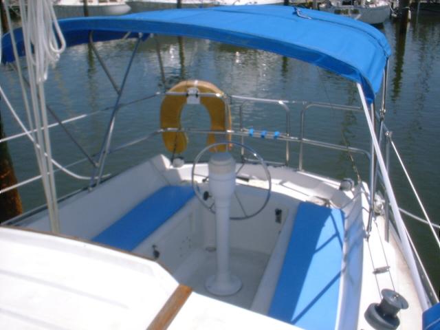

Here is a picture of my brand new bimini. The front straps clip onto the toerail and the aft straps hook to the stern railing. Ed H

Ed H
Wish I could blow up your picture for a closer view

Here is a picture of the small "u" bracket that is used to attach the bimini strap. Also two of where the life lines are attached lower in the stern for easier boarding and docking of the boat.

Ed H
I am not sure why the picture is so small. You can see a larger version at my photo album on this site. Ed H

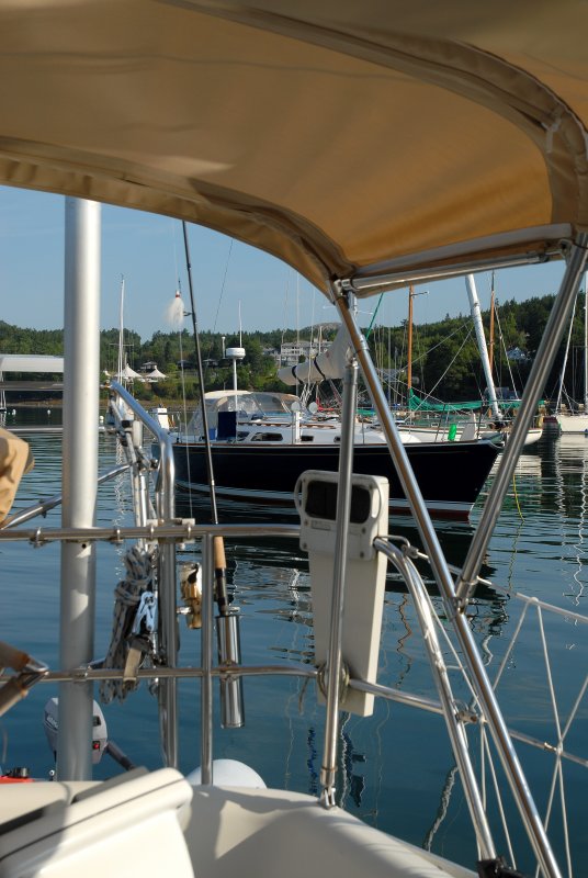

Ours is strapless, stronger, stiffer, better support for the connector piece and side curtains and no straps to get in the way. This is a very easy DIY project and can be done on just about any boat. You can often do it with "scraps" of SS tubing from your local canvas shop. They often have no use for those "short" pieces and will give them to you or sell them quite inexpensively..

Maine Sail,
Great pictures: so you mean I could construct a support fitted vertically like yours, and then a horizontal piece at the top like in the picture?
Any chance of more pictures so I can see how you did on all 4 corners?
I can get lots of stainless steel tubing for free, and can also get the connections
Someone wrote on this link" maybe I can go strapless," I thought he was kidding, but I really like it!
