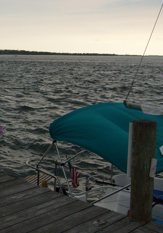

Here is the bimini setup on my previously owned 23.5. Pretty sure it was a stock bimini, installed by the dealer when I bought the boat. Sorry I'm not sure of the type, but it was pretty big. The stern rail seats were usable whether the bimini was deployed or not. However when it was deployed, the mainsheet had to be attached to a bail farther forward on the boom, and the boom had to be supported a little by the topping lift to keep from hitting the bimini when tacking. I will try to find a pict of the bimini deployed...
Thanks. The Bimini in the pic looks like this one. Does look like the Bimini intrudes on the SRS tho.

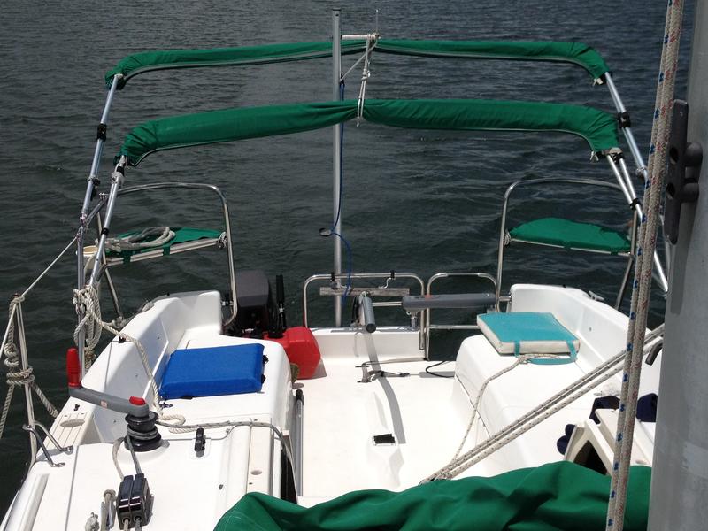

Well, that is a two piece bimini, mine was only one piece. Here is another picture from the front showing the width... the length was almost to the companionway... Still looking for a picture with it open...

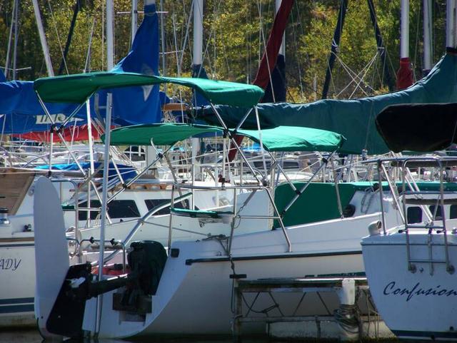

Stern seat mounted bimini
Hi,
The picture in this post is my boat. The stern mounted bimini is one I made. It clears the stern seats while deployed or stowed and positions just aft of the boom giving standing headroom underneath.
The origonal bimini I shortened and moved to the forward leg of the stern rail. It is positioned under the boom.
If you still have an interest send me a PM and we can discuss it. Happy sails!

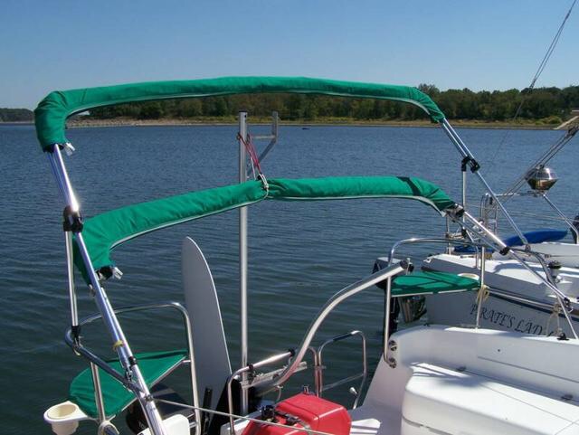

Here are a couple of images with the bimini open. The back end of the bimini is about head height when sitting in the stern rail seat, but it is forward of where you head is so not in the way.
