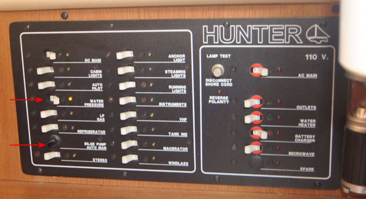

IMO, I'm thinking, specualting, contemplating, whatever, that a more likely place to find your previous owner's (PO) wiring error is behind your 12V wiring panel. The reason I say this is that the physical wiring to the one single bilge pump and the one single water pump are likely separated by a good many feet. I can't see accidently running the water pump wiring over to the bilge pump wiring unless the PO was out on a day pass.
If your 1992 12V panel is similar to my 1999 panel (guessing here), pull it out and locate the OFF/ON circuit breaker switches for both the bilge pump and the water pump :
My suspicion is that you will find the load wires coming off the water pressure breaker have a take off leading to the load wires of the manual bilge pump breaker or switch or whatever you want to call it. This is what causes the water pump switch to always deliver power to the bilge pump when turned on.

Your shower drains directly into the bilge so there is likely a switch in the Head to bypassing the bilge pump float switch, so the pump comes on when someone is using the shower.
Since your bilge pump comes on when the water pump is turned on points to there being a separate switch in the circuit for the reason above.

The fact that the pump ran around the same time the fresh water was turned on is too coincidental for me. And an original wiring diagram might help, but after 34 years who knows if that’ll be right or just more misleading. My guesses are:
  1. There’s a manual switch somewhere on or near the panel that accidentally got bumped when turning on the water pump
  2. There’s a manual switch elsewhere, like in the shower that BrianQ alluded to, that’s powered by the fresh water circuit and accidentally got bumped
  3. There’s some sort of short between the water pump circuit and the bilge pump circuit
I'm also starting to lean towards your idea of a hidden "mystery switch" which the OP has not seen or discovered yet after owning the boat for several years. What the OP is seeing is not some random broken wire or badly corroded connection which just appeared in the curcuitry prior to his anchoring out as mentioned in post #1.
Exactly. It certainly looks like the bilge pump receives its power from the potable water pump circuitry. The other problem that this little happenstance points to is that the bilge pump is inoperable when the water pump breaker is in the OFF position.

I'd check behind the panel to see if the bilge pump wire is touching something on the water pump circuit

I did look behind the panel. One of the wires close to the fresh water switch was loose. I reattached the wire and all is good.
