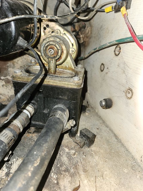

My ancient Jabsco remote diaphragm bilge pump has stopped pumping. Motor still runs but won't take a suction.
My boat is a 1977 year production and I suspect the pump is original to the boat
Looks pretty much like this one but I can find no identifying labels on the old pump.
Since I haven't yet been able to positively ID the old pump and I have not yet pulled and disassembled the old pump to see if it is viable for a rebuild, I'm reluctant to order a rebuild kit.
Cheap enough to go with a "in-bilge' type pump but that would require a complete rewire and replumb. Not a big job but a bit of a pain in the butt.

Those are pretty much the standard of the industry. I have two of them, albeit newer versions, in our boat. They do not back-syphon like the centrifugal pumps. The current model does not look quite like yours, but it's close.

The tiniest bit of bilge debris in either of the valves can cause it to run but not pump. I recommend opening it up and evaluating the valves and diaphragm. They may have gotten hard over time and are not working correctly.

Since the pump isn't working you might as well disassemble it. You may find the problem is something simple like the diaphragm has torn or cracked. Replacing something like that is much cheaper and easier than replacing the entire pump. If you do need a new pump be sure to find one that has same size input and output as your current pump. Changing hoses is a real PITA.

I pulled out the pump this morning and disassembled it. Should be an easy rebuild. Not really dirty in side but the rubber parts were almost as hard as Chinese algebra.
I'll also be replacing the rubber mounts, they're shot.
The pump was installed "right". Maybe 5' of vertical from the bottom of the the black hole that serves as my bilge to the through hull outlet. It has a pressure switch for automatic operation and can be turned on manually at the breaker panel and the hoses are good, I do not believe they are the original 1977 installed hoses.

I just finished this little issue. I contacted customer support and he said to email him fours pics and he could tell me what model I had. Worked out well. I had a bunch of black crap mixed with the inlet valve. Leaned it out and replaced the hoses. I left the end of the inlet hose about 6” up from the bottom..

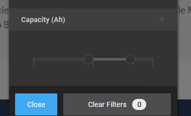

I was looking for a battery and could not figure out how filter for size or chemistry, instead I got a couple of pages of batteries to scroll through to find what I was looking for.
You mean this random "capacity" slider with no numbers or indication of scale isn't helpful??? :banghead:

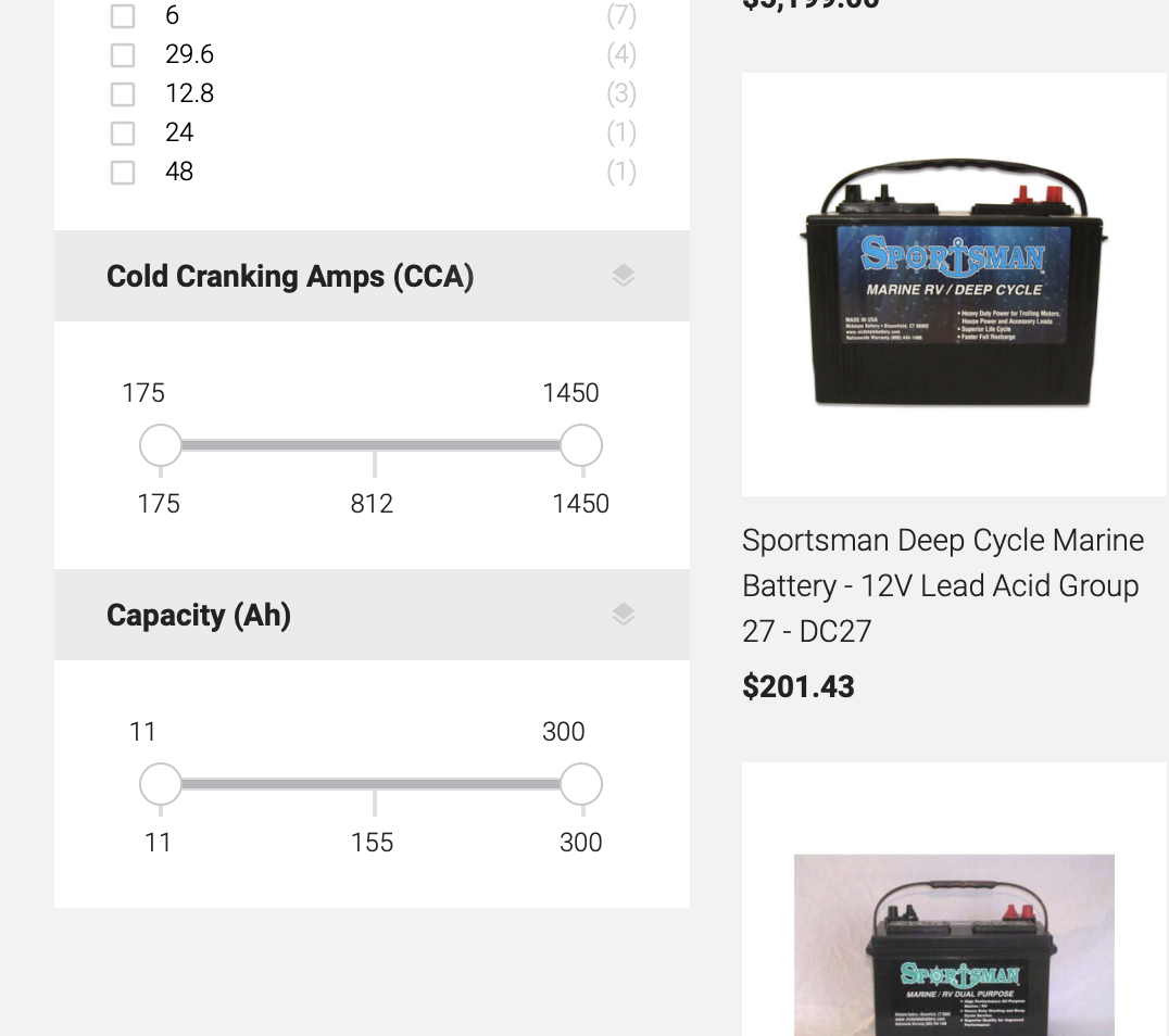

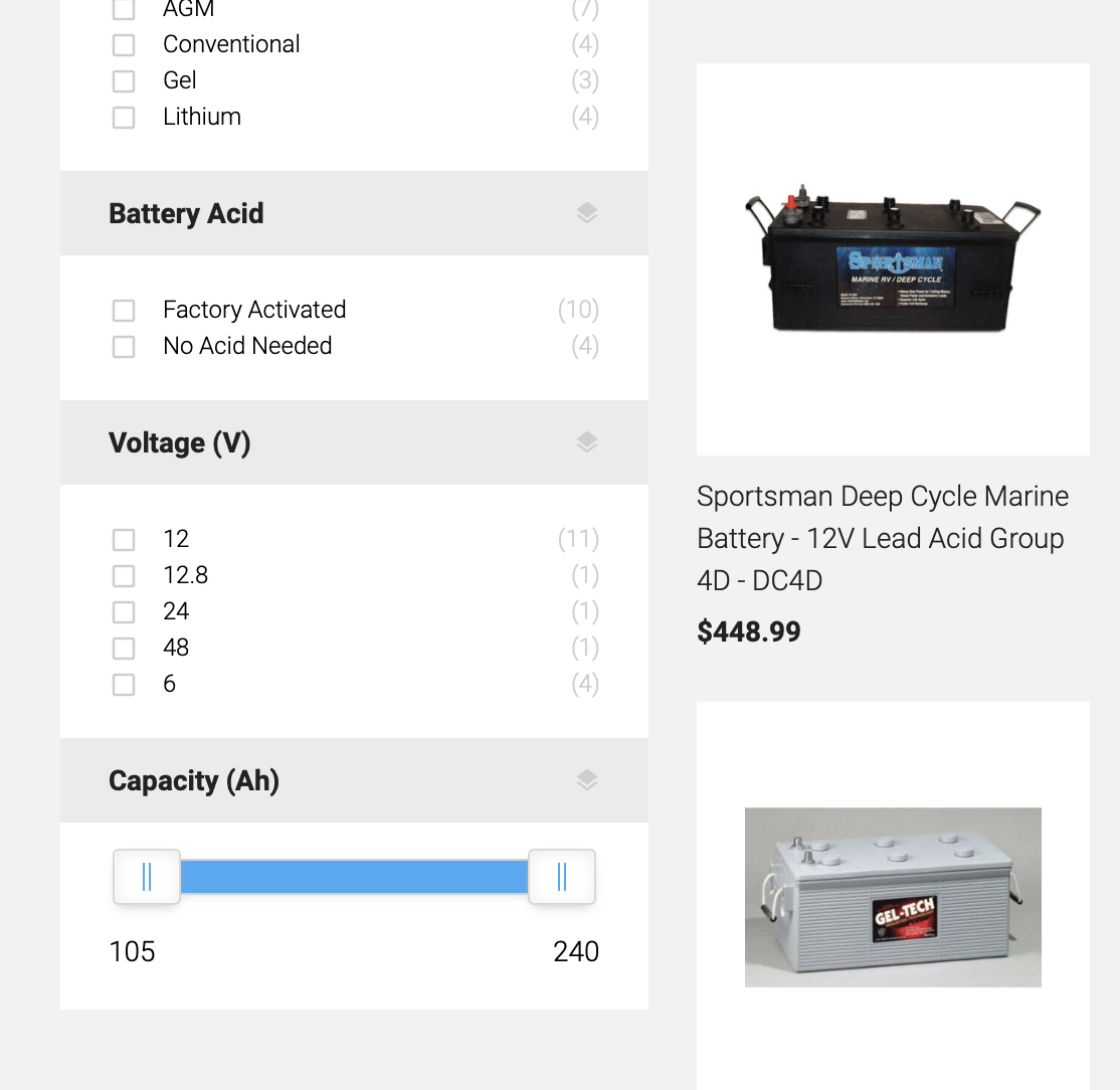

Interesting, just now I see there are filters on the battery page and depending on how I get to the battery page I get different filters. Search for batteries and I get one set of filters. Go to the battery page from the menu and I get a different set of filters. :facepalm:
