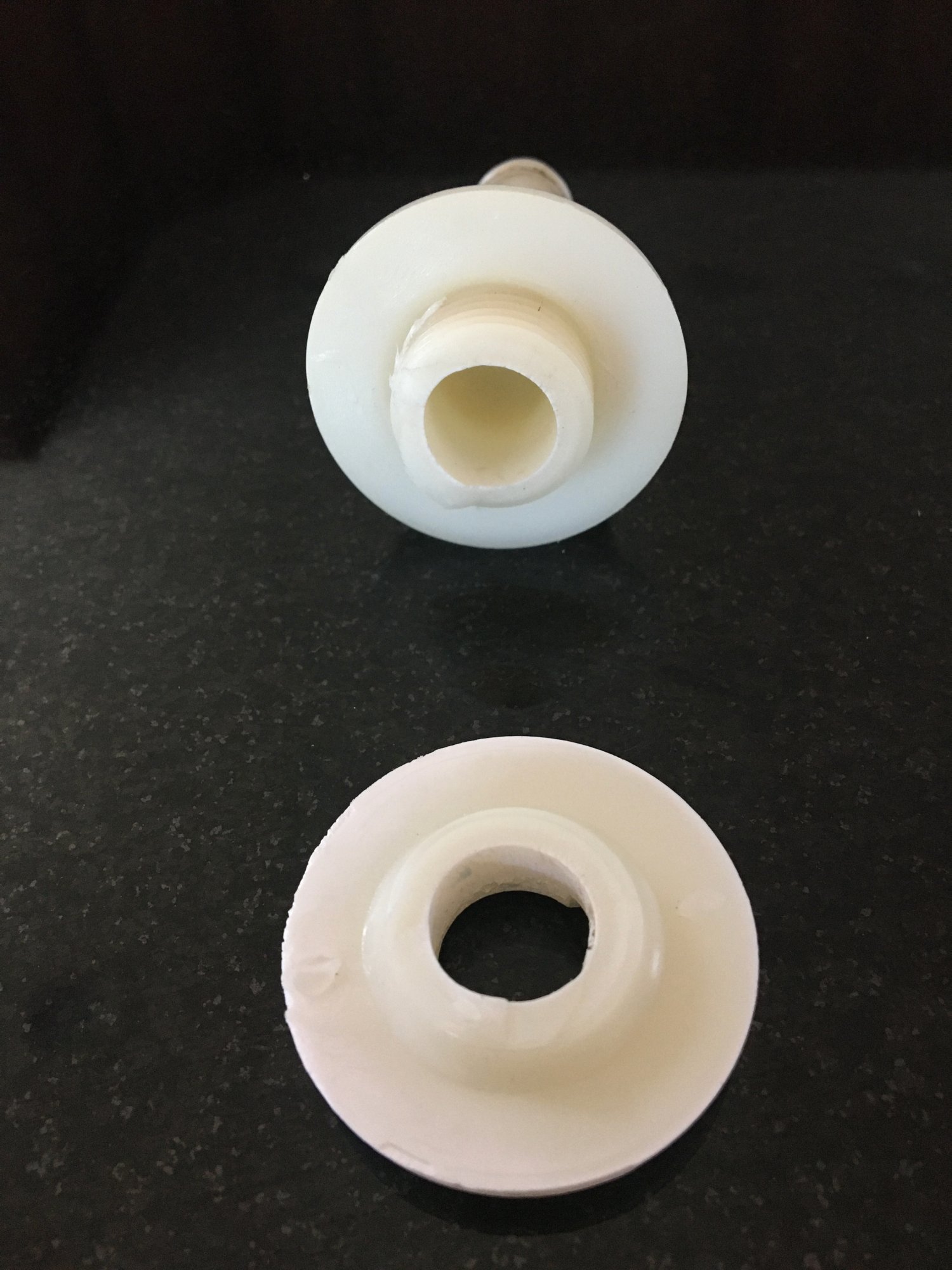

Finally, don't buy a plastic through hull fitting. Yes it will be above the water line, however they degrade and are easily broken. The one in this picture cracked with a half turn on the backing nut. It was being replaced with a SS one.

Agree with the advice to avoid (cast) plastic thru hulls, especially where they may face UV.
Use composite fittings (Marlon) or SS.
