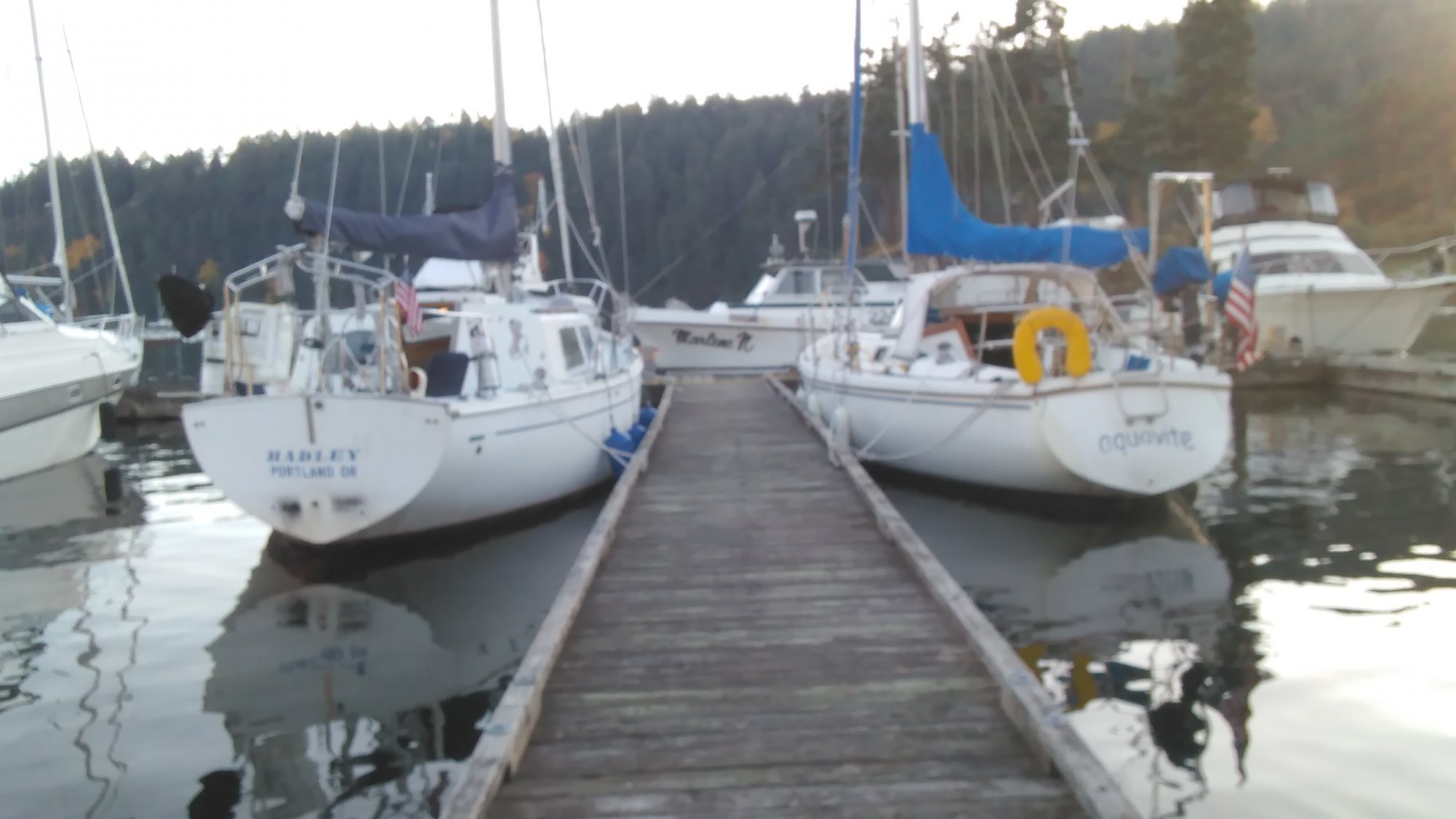

I ask Fred because you can see the water line. The line appears about 2-3 inches beneath the line of your bottom paint line around the boat. My boat is the one on the left in the image. You can see the 2 scupper, exhaust and bilge thru hulls across the transom.
