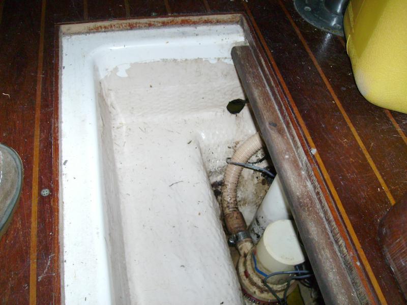

modified bilge
Here is a picture of my bilge and the modification is clearly evident.
Nov 8, 2010
11,386
Nice mods but an FYI to all, corrugated hose reduces your pump capacity by 30%.
