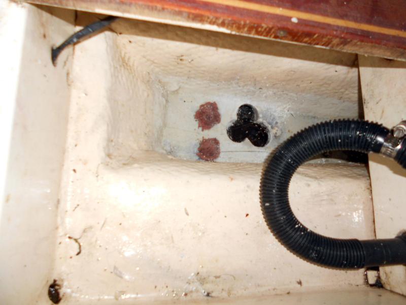

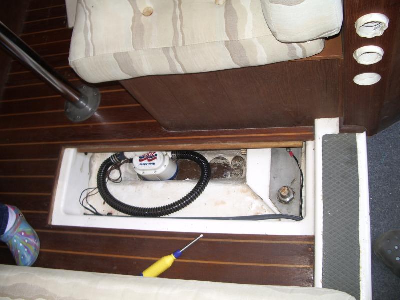

I recently completed the "False Bilge Alteration" that many recommended on this site for my 1986 Hunter H34.
I'm curious how others mounted their bilge pump and float switch after removing the liner from the bottom of the bilge. Do most just use screws like before and if so what size? How think is the hull here?

Nice job. What kind of paint did you use? I'm going to epoxy a piece of wood or something to screw into. I think someone said the hull is just over and inch thick maybe 1"3/16.

That came out very nice. That's one of the easier mods for our boats and very functional as well. A dry bilge really keeps the interior odor free. When I cut mine away the smell was awful. I thought I was going to find a corpse under there.
When we visited the Hunter factory back in 1986 they were still building our model and they told me the bottom was 1-3/8" thick. I used 1/2" screws to secure the bilge pump right to the bottom.

BTW, I see in your pictures there is still a little plywood left around the perimeter of the hole (I think). It only goes under another 1/2" or so. If it was like mine, it was rotten and smelled. You might want to get a wood chisel and break it away from the fiberglass and remove it. That shouldn't harm your nice paint job. I left mine natural. :D
Thanks for the info. I'll try 1/2" screws as well. I was thinking of installing some type of mounting base but it would appear thats not necessary.

Yes. Just the floor of the bilge. Its a pretty strait forward mod. Use the correct tools as it will save you a lot of time and headache. Also be very deliberate with your cutts. The best tool is a powerful Dremmel with a right angle cut off wheel. I also used a right angle grinder with a 4.50" cut off wheel and a oscillating multifunction tool with a straight blade. You'll also need a few prybars and maybe a small chisel. I also used a sander to finish the edge before cleaning and painting.

Mounted my bilge pump today with 3/4" SS screws (coarse thread). No issues to report.

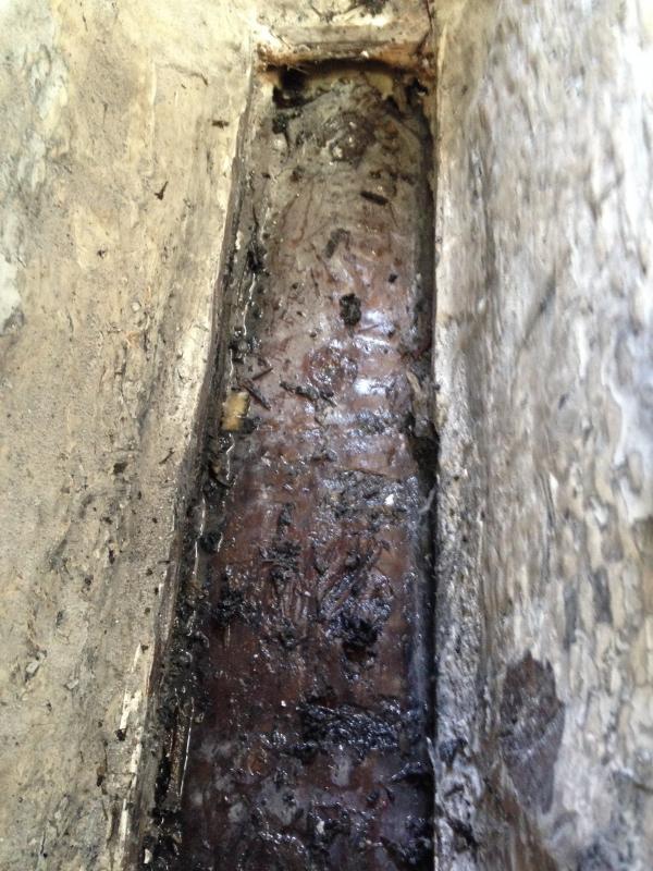

Christian, sooner or later you'll have to get rid of that false bilge. I'm loading up on info to tackle the project in the Spring. I understand you probably pitched the bow up 15˚ to make sure of water run-off towards the stern. However, when my 34 is in the water, it is level and water runs down each side to exit at the back. When I am on the hard I make sure the boat is level and water still runs down the sides. As as result of being level, the bilge is the lowest point and water will run there. With the particular predicaments of the false bilge, water finds it way there. In your case as you mentioned, because of the pitch it stays somewhat farther aft. On my boat the anchor locker does not let any water go to the bilge. Except for that as you surmised, water from everywhere else under the floor will get to the bilge and/or to the false bilge.

That's what I used last fall once the boat was on the hard. 3 holes 1 &1/2" pretty much in center of false bilge gave me access to enough rotten plywood to make me decide to do the job in the Spring. I pumped 4 gallons of water from there. I will remove the rest of that false bilge bottom, and reinstall bilge pump on real bottom as Allan and Blackacre did.
