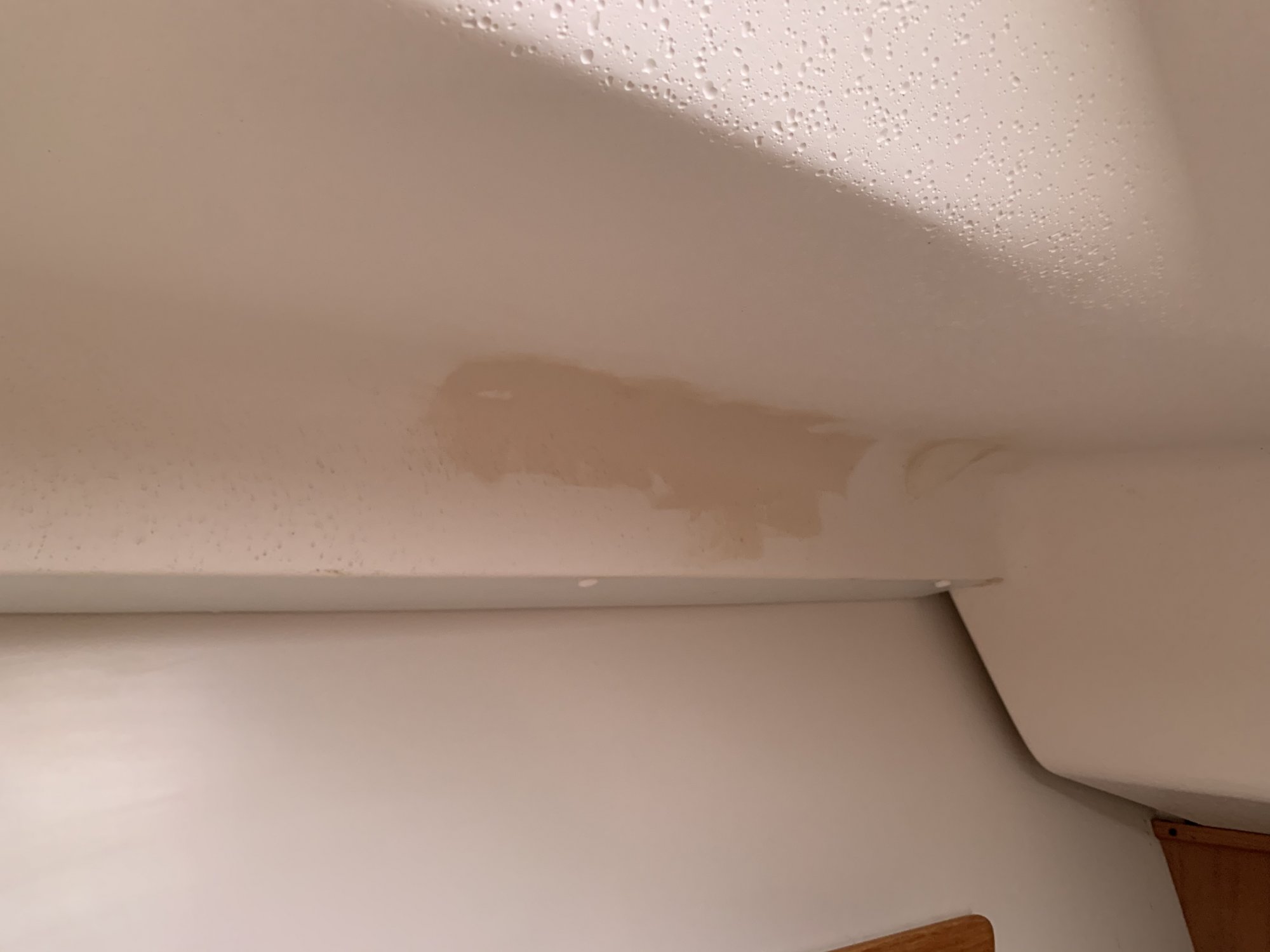

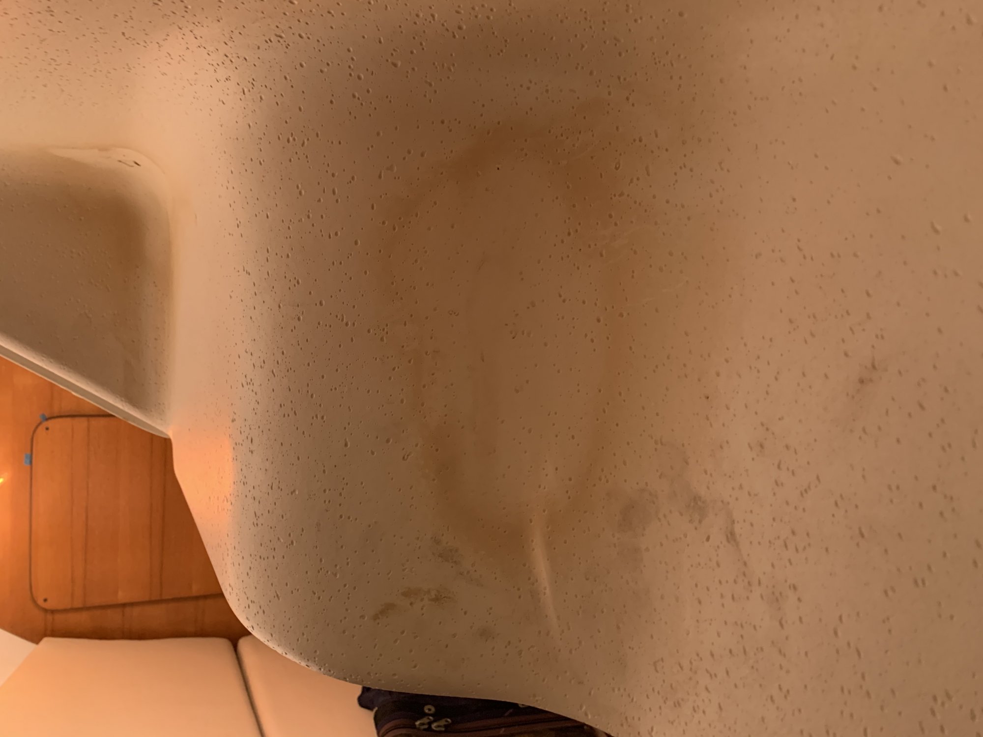

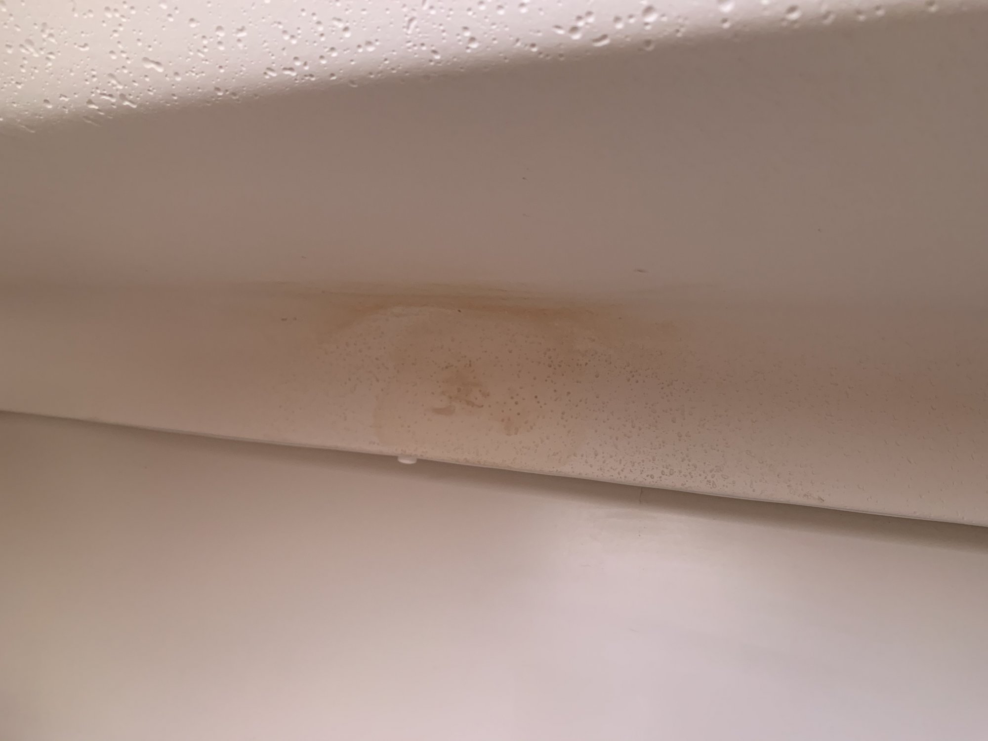

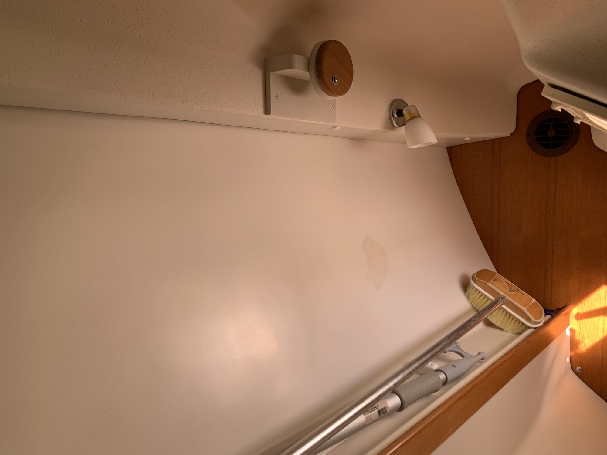

I've had my 2007 Catalina 309 for a year. When I purchased it there were to issues I've yet to figure out or repair. It was in great condition other wise but has some discoloration in various places around the cabin ceiling and walls. They are not in obvious water leaking areas and the boat has no obvious rain leaks. There is the usual seasonal condensation. Also the bilge covers in the floor are delaminating around the edges. They are obviously a synthetic of some kind and I wonder what adhesive product would be best for the repair. I'll post some pictures below.

Regarding the splotchy stains, we have the exact same. And I concur that they do NOT seem to be associated with water staining or leakage. I wonder if they could be some kind of mold or something from the back-side. I figured the only solution was going to be to eventually paint, but haven't gotten that close to the top of my to-do list yet.

Thanks Dave I'll attempt a contact cement of some kind on one of the lesser damaged boards before tackling the more visible ones. It was suggested to me by the surveyor and a former boat building friend that he blotchy areas may be a problem with the original resin or such when the boat was made. I reached out to Catalina for advice but have not heard back. I looked at the same year 350 model and it had none of these issues. I'll let you know what I try on the floor boards and whether it worked.
2,466
Catalina 320 Dana Point
The cause of those discolorations has often been attributed to too much mold release agent, I have a couple small spots on my 320 Nothing as noticeable as yours.
My first inclination would also be contact cement. Have you tried contacting the factory (nicely) send them some pics of your floorboards and solicited their assistance ? They used to be pretty good about problems like this.

I also have the exact same discoloration on my 387. Around the two bulkheads mainly. I've replaced all the lights, so now have to match the liner gelcoat to fill screw holes.
I'm with Calif Ted. The factory is really good - you may wish to ask them how to glue down the vinyl again. (I also agree googling Lonseal)

I contacted Gerry at Catalina:
From: Gerry Douglas
Sent: Wednesday, January 6, 2021 3:59 PM
To: marklauer@aol.com
Subject: RE: Catalina 309 Hull #65
Mark,
The cabin sole is a product called “loncoin “ it can be reattached with contact cement.
The discoloration can be removed with “ soft Scrub with bleach and a Dobie pad.
Hope this helps.
Gerry Douglas

Catalina 30 Mk II Barnegat, NJ
