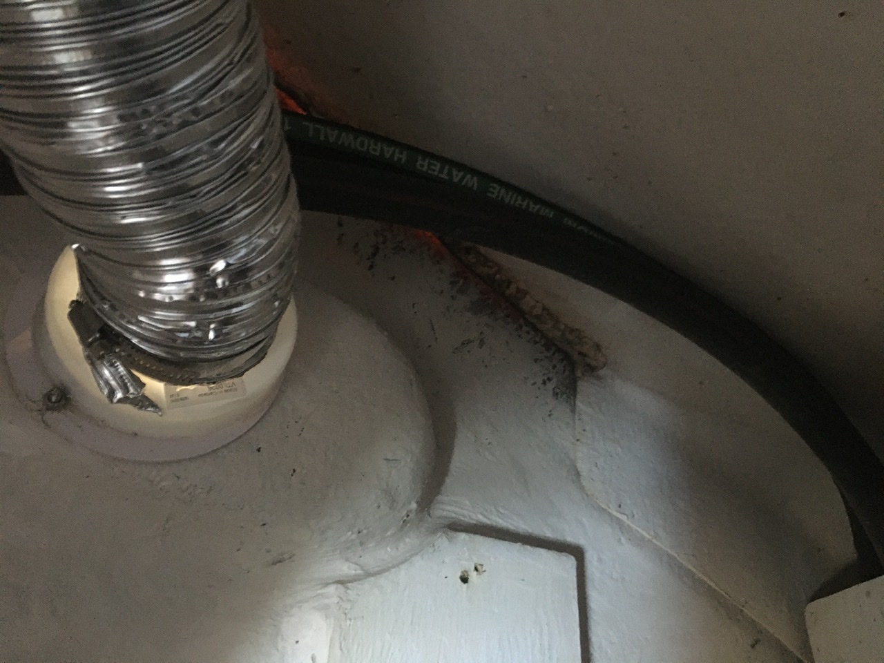

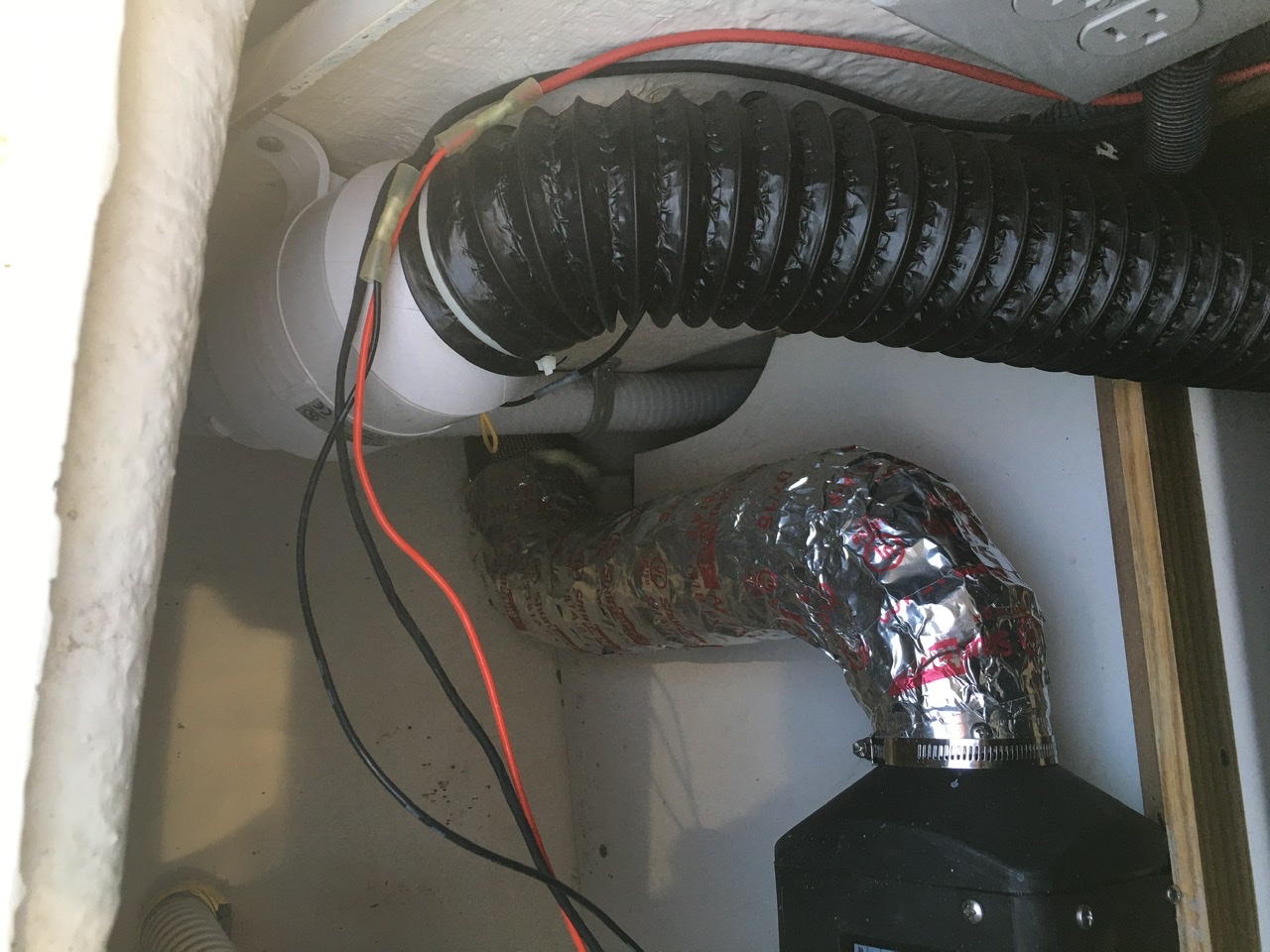

The one on the starboard side provides fresh air to your engine compartment. The one on the port side is connected to a blower to pull air out of the engine compartment. If they’d not have hoses on them then you have the same problem I have: cheap plastic hoses deteriorated. The blower has a toggle switch on the bottom of the instrument panel.
I can’t get to the inside of the aft vents to replace the hoses. So today, I got a 4” to 3” plastic adapter and used Gorilla Glue clear to glue it and the new aluminum hose to it. Good to go now.
