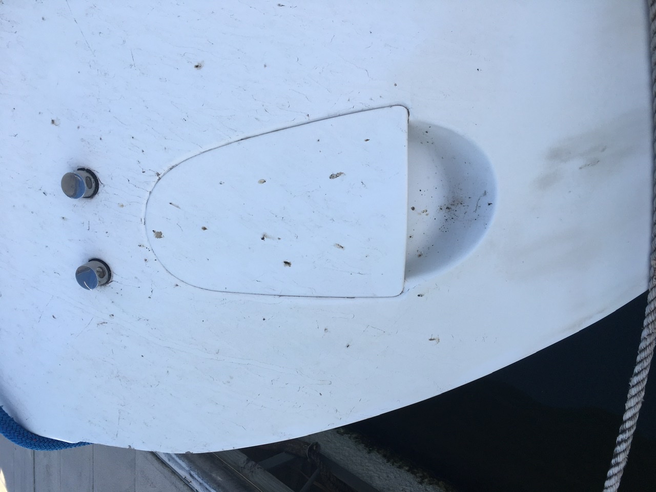

My bilge hoses are shot. Catalina installed the bilge blower at the far back of the boat. I got it loose and moved it to the forward bulkhead right under the port aft hatch. Have all the duct run to the blower but how in the world am I going to get it attached to the transom vent? Seems I could if I could remove the vent. I've got a 2004 with the plastic vents. Any thoughts?

No worries. I’m just trying to find someone who’s taken the back vent off so I can attach the hose to a place I can’t reach.

I replaced one of the vents years ago. I don't remember it as being too difficult, though. If you don't see any screws visible, there might be a cover that snaps off.

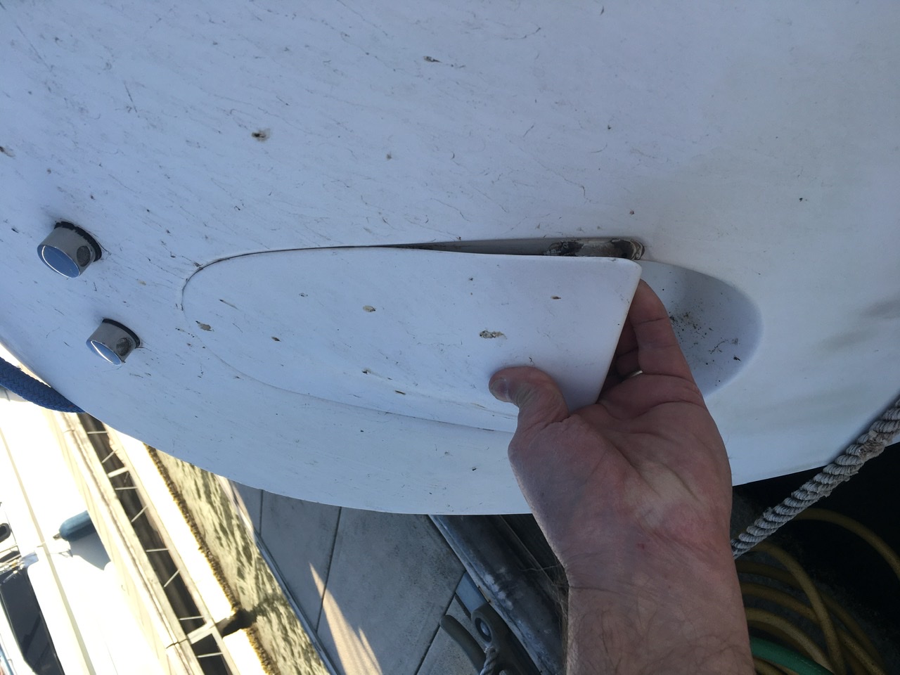

Hi - I did this exact job - I have a 2004 310 also, and did this job last year. Replaced the Detmar blower with same, as well as the cheap venting hose to the transom. I did not have to take the transom cover off - it attaches quite easily by just carefully threading onto the outlet. Luckily I'm just small enough to fit into the space and with a lot of boat yoga and swearing, got it done. Good luck.

Well, I’m 6’ 2” and 225. I can’t reach it so I’ll hope the cover pops off. Thanks for the reply

Thank you for clarifying what I am asking about. I am going to the boat today to see if I can get the cover for the aft vent off so I can get at the hose attachment from the outside as I can’t get at it from the inside. My six year old granddaughter will be here in a couple of weeks. If I can’t get it from the outside, I’ll send her in there.
