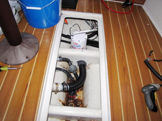

Finished installing new bildge pump today......this should give me a few minutes to repair a leak.
