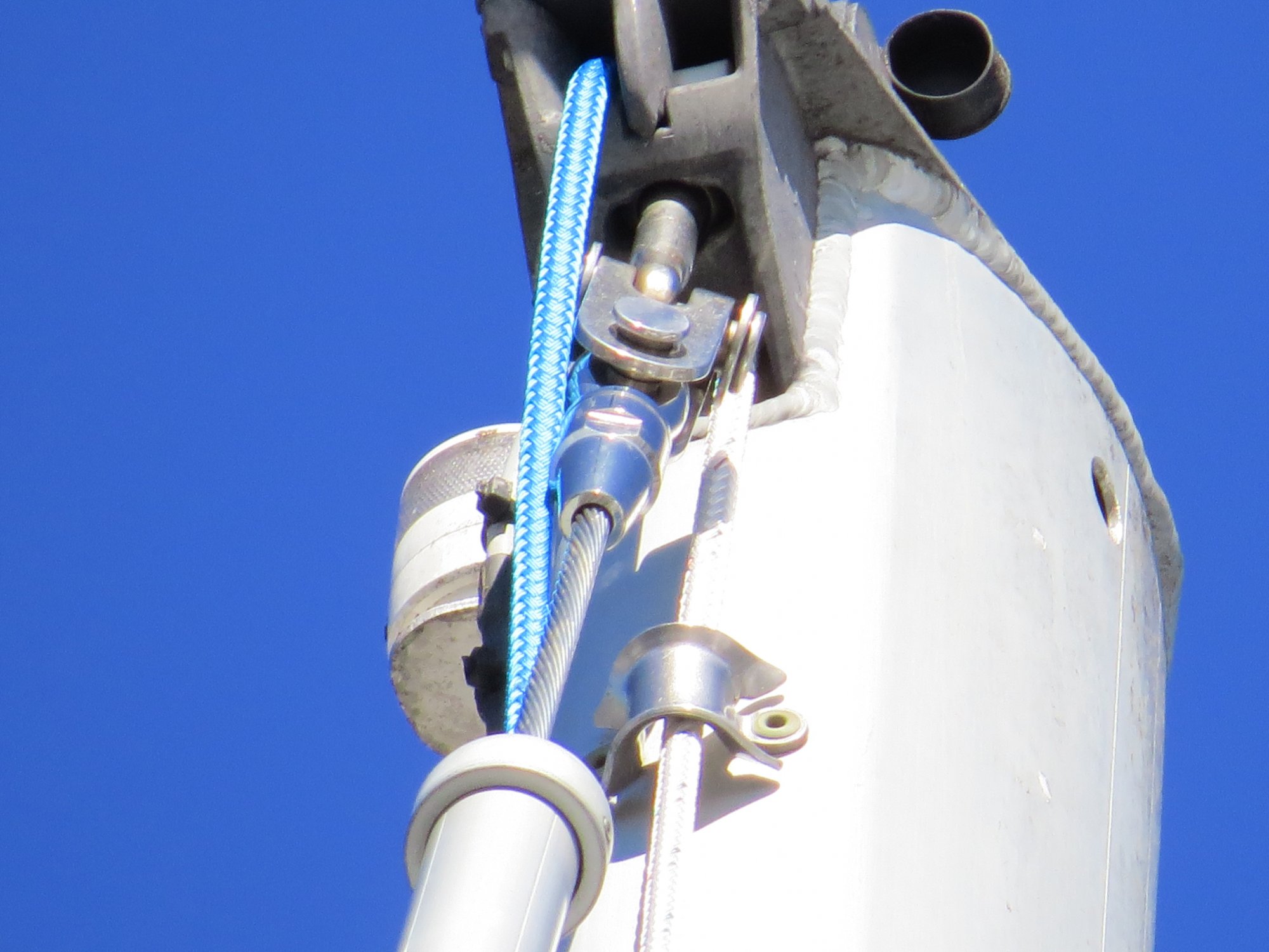

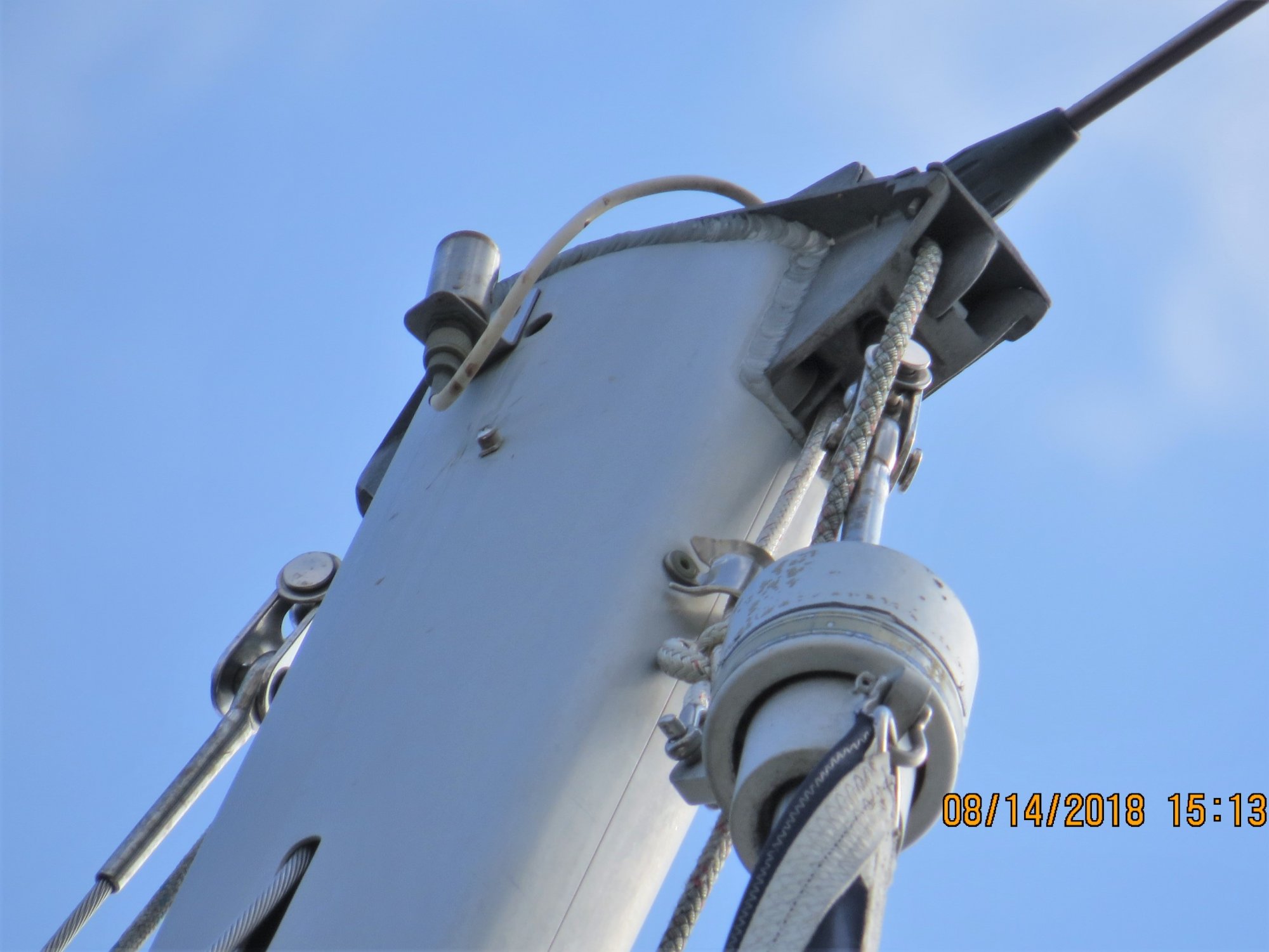

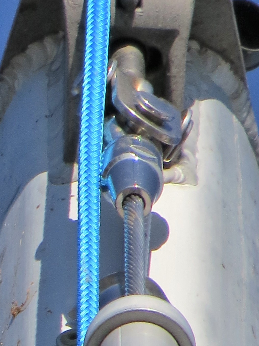

When I hauled out my 2003 Catalina 310 in the fall of 2018, I decided to replace all the standing rigging, including the forestay. The next season, I noticed that I couldn't quite get all the slack out of the luff of the genoa. After hauling the boat in 2019, I decided to investigate. I noticed that the foils had been cut down slightly by the boatyard because they stated that the swivel was almost rubbing against the halyard guide at the top of the mast. This was verified by pictures I took before and after the rigging was replaced. Zooming in on the masthead where the new forestay was attached, I noticed what appeared to be a crack running the length of the Norseman fitting. I was about to call the yard and cuss them out. At the advice of a photography teacher, I went back and took another photo at a different time of the day. The "crack" had moved over towards the center, clearly indicating a reflection from the nearby halyard tucked against the mast. Saved me from the expense of paying a drone pilot to inspect the fitting, as well as unfairly blaming my boatyard

I used a Canon SX50 bridge camera with a 1200 mm zoom to get those shots, and digitally cropped them a bit. IMHO, a 400mm lens would not have gotten close enough to see the "crack" , especially if used on a full frame camera body. Now that I don't have to pay the drone pilot, or replace the stay, I think I am going to go out and buy the new Nikon P1000 bridge camera. That sucker goes out to 3000 mm. Could probably make out a mosquito perched at the top of the mast. BTW, here is a picture of the original headstay before replacement, which led to this wild goose chase.

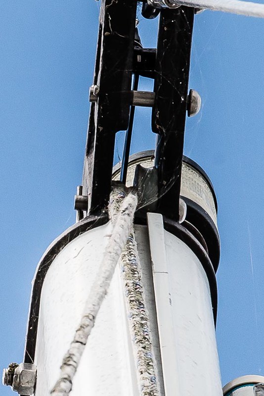

You got closer than I thought with a lens of moderate focal length. From what I see, it looks like you could use a new set of halyards, and one of them looks like it slipped out of the sheave. Based on their overall condition, I would be hesitant to use them to support my weight on a bosuns chair. Also, your shot is missing quite a bit of detail. It might be partially due to digital cropping, but more likely, overexposure is the main culprit. It is better to underexpose these shots a bit, especially in bright sunlight. It is far easier to recover lost shadows than blown out highlights in Post processing. A circular polarizer might also have been helpful. If you look at my shots. the darker one shows better detail. They were both shot with the same camera in bright sulight

What I was using was not a massive 1200 mm telephoto lens. There is one made by Canon for full frame DSLR. It weighs 36 pounds, costs over 120k, and is only made on special order. I was using a canon sx50hs "bridge" camera which is about the size and weight of an entry level DSLR/kit lens combo. Due to its small sensor, it can zoom from 24-1200 equivalent. My shots were done at full optical zoom with some digital cropping. The camera has built in ultrasonic image stabilization, but that is not sufficient to avoid blurry images at full zoom unless you up the iso and shutter speed and have very steady hands. For most, including myself, a tripod is a must. I placed the camera on it and adjusted it until the masthead was at the center of the frame. I then zoomed in all the way and snapped my shot. I also put the shutter on time exposure so that vibration caused by pressing the shutter would not spoil my shots.
