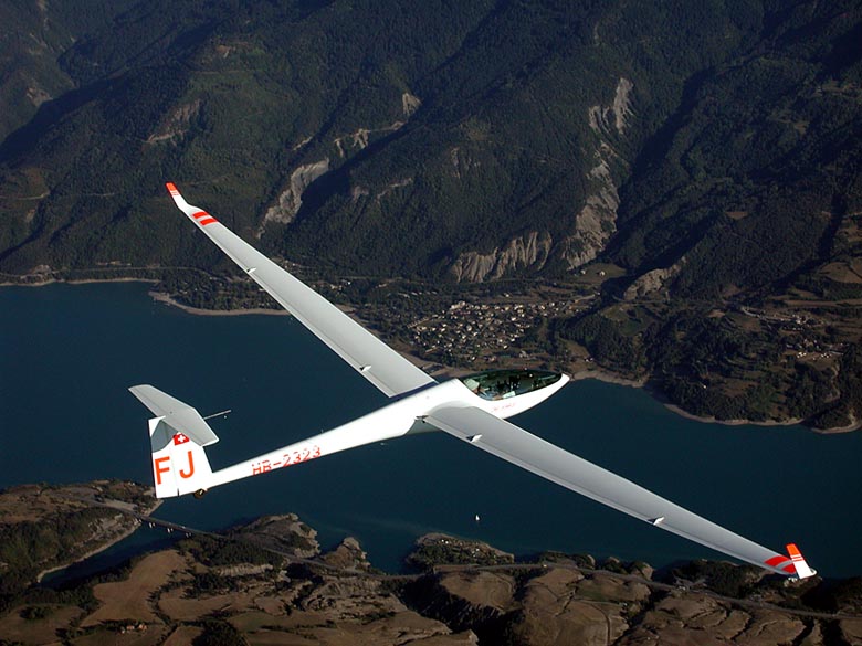

They look like:
Gliders!!!!
High aspect ratio wing keeps drag down to a minimum. Same for a sail. Choose the sail with the highest height to width ratio!

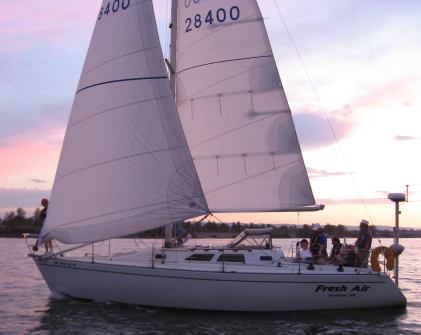

Headsail Heresy, Perhaps...
Our boat has a "balanced" rig, between main and jib. Perhaps not too different from the traditional Cat 30 rig. Maybe.
So, after 15 years of living with a 135 genoa, last summer we decided to go with a new 95% jib. Still roller furling, but with Vertical Battens. This gives an upper leach equal to about a regular 120%, to my untrained eye. Maybe.
Results are astounding. In anything over about 8 knots we go to weather Very Well, and can still point like a Meter Boat with one reef in the main at 18 kts true. Typical speed to weather is over 7 kts.
Of course tacking the boat is now easy. Very easy.
We have lost some speed in light air, but the trade off seems well worth it. And since our slowest direction now is DW or up to a close reach in light air, we are saving for a new A-sail with top-down furling. And that... will become our total inventory. The old tri-radial spinnaker will get retired -- great sail but it takes a while to set up and another while to put away.
Many 'right' answers, but at least this may give you something more to consider.
I will attach pics of the boat with the 135 and with the new 95; not on the same point of sail, so the comparison is not as easy to see as it should be.
