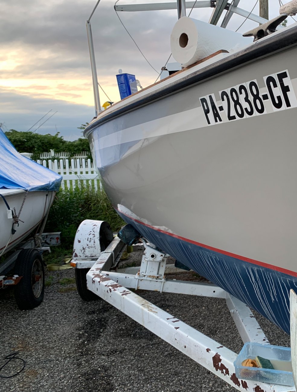

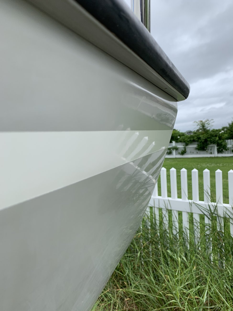

So I got a chance to do some testing trying to take that Poliglow off. Winning combination was Zep Floor Stripper, 1000 grit wet sand, 3M heavy duty compound, presta polish. Didn’t put wax on the test spot since I’m going to go over it all over again. You can see the spot I worked on.
Now that I know what will work, gotta get the right supplies to finish the job. Don’t have a day off for a while so my plan is to go section by section after work all week.

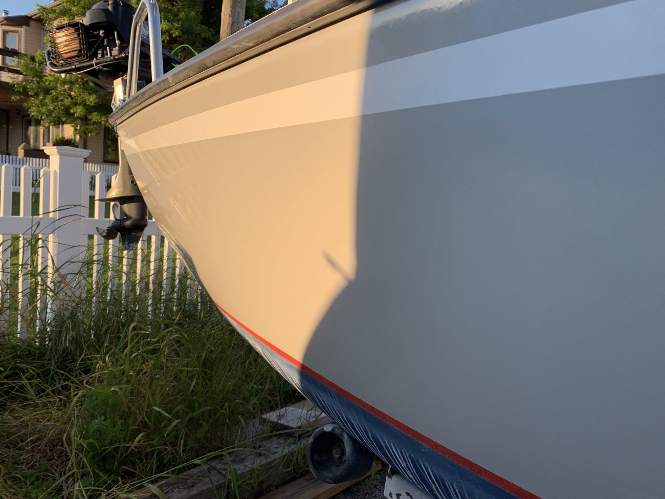

For anyone looking for the best way to remove poliglow in the future:
Get a plastic spackle knife.
Spray the area down with floor stripper, let it soak, scrub it with a sponge, then spray it again and immediately use the plastic spackle knife to scrape the Poliglow off the hull. Hold the knife by the tip ends of the blade so it conforms to the hull. Works perfectly.
After the spackle knife I sprayed it clean with water, wiped it with acetone, wet sanded with 1000 grit, compounded, polished, waxed and repeat for the next section. When I waxed I would go from my new area and recover the areas I did previously to build up a good coating of wax on the hull.

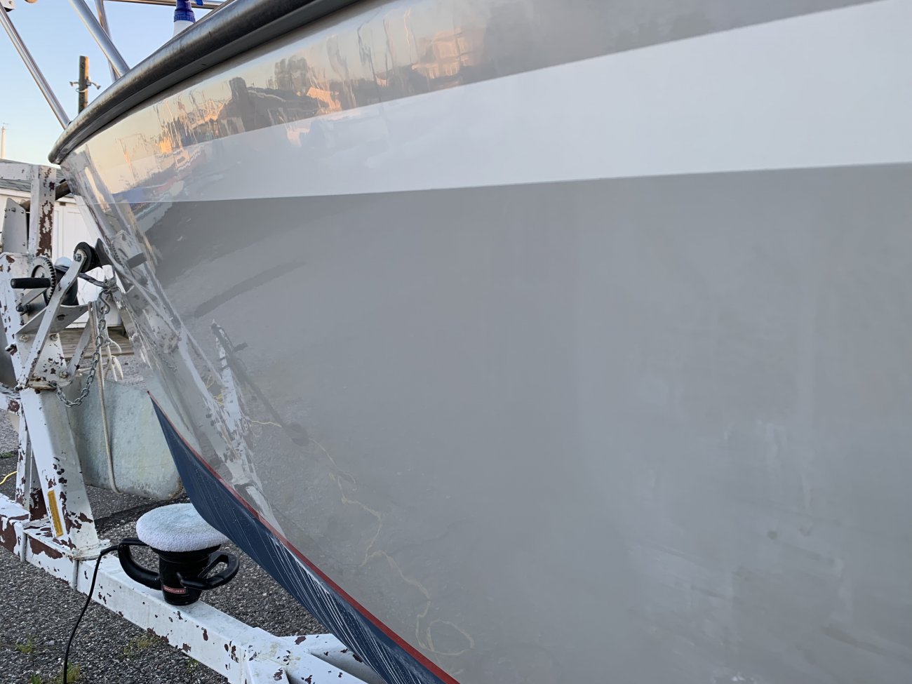

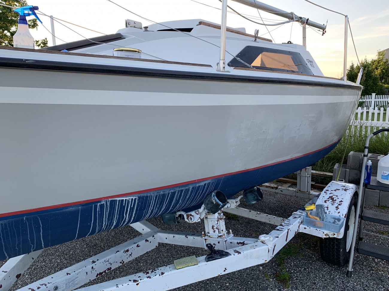

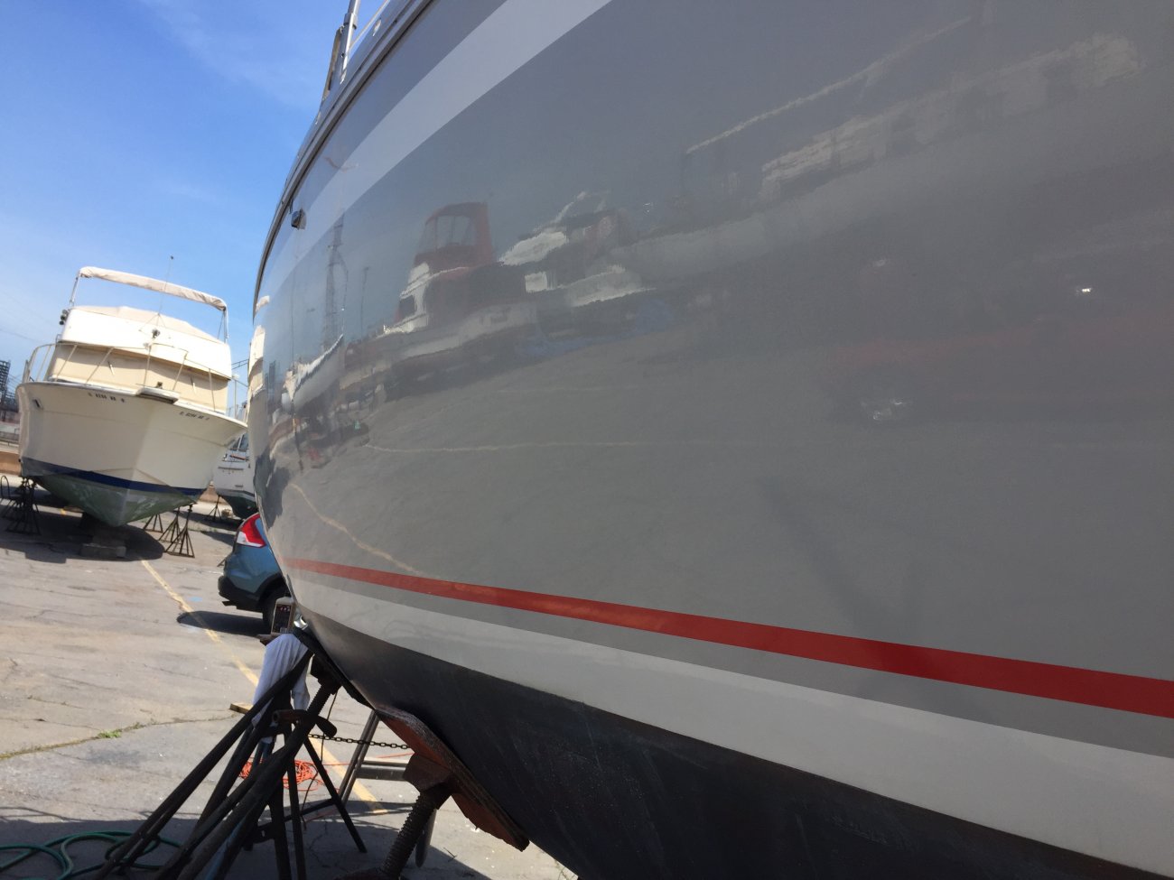

Here’s some shots of the progress:
GSBNY
May 9, 2019
138
O’Day 192 New York

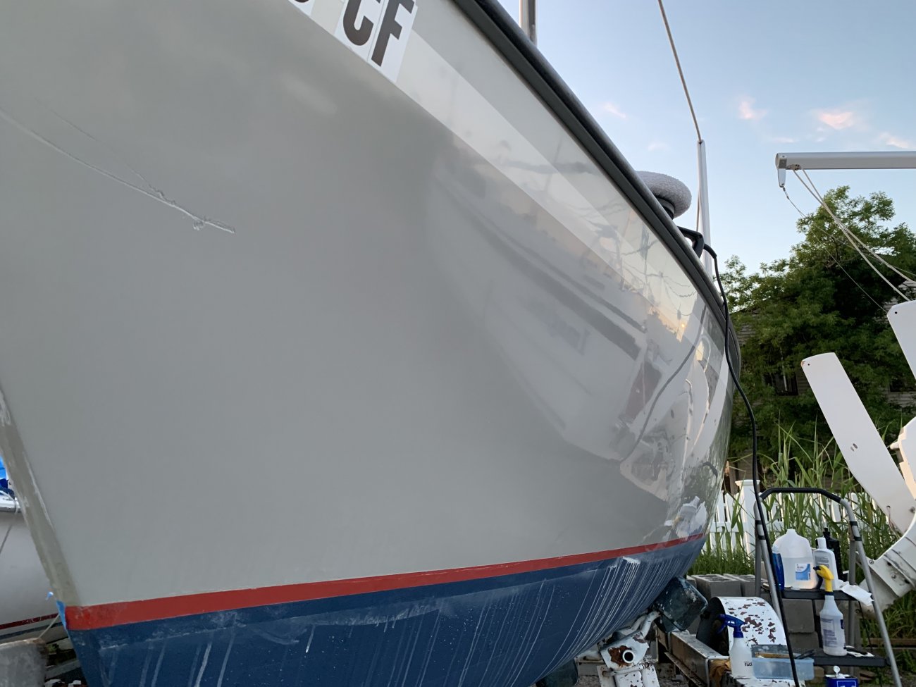

Got both sides done finally, just the small transom left. In total, it was about 6 hours of work over a few days.
Starboard side before and after:
Hopefully the weather holds out and I can get the mast up tomorrow. Then need to make a bridal so I can use the crane at the local yacht club to launch and retrieve.
