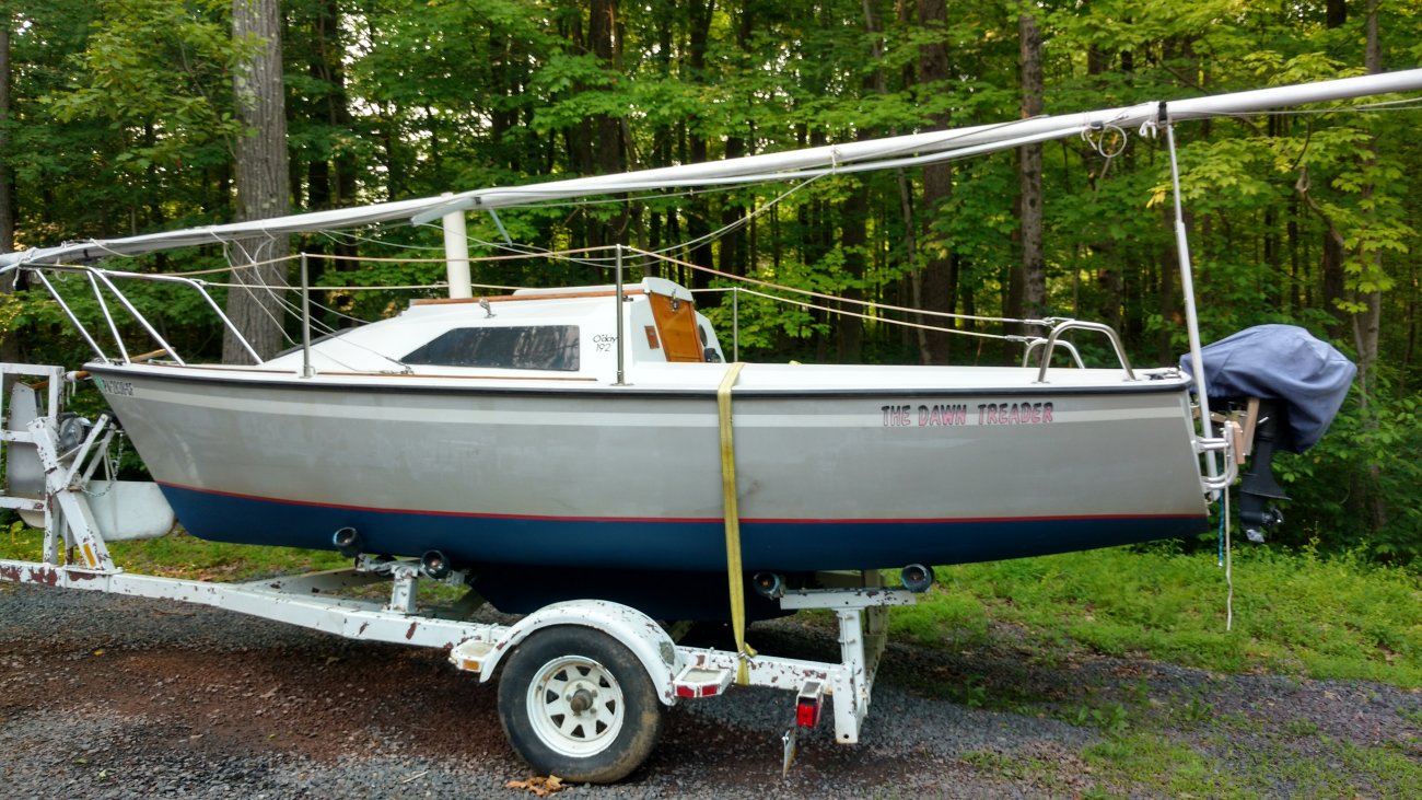

I finally bought a boat, a 1988 O’Day 192. Everything is in great shape except the grey hull has some oxidation on it. Any tips to get the gelcoat back to its original shine?
Hopefully the boat will be delivered on Saturday so I have some time to grab supplies.
Also, after researching and looking for an O’Day 192 this was the only one I saw that had an original gray hull. Anyone know of any others?

Before you do anything, verify whether it is gelcoat or paint. The difference is crucial in determining how to bring it back.

Spoke to someone about what’s going on and they think there’s a coat of old floor polish on the hull. I’ll have to use ammonia to remove that before starting the Mainesail directions.

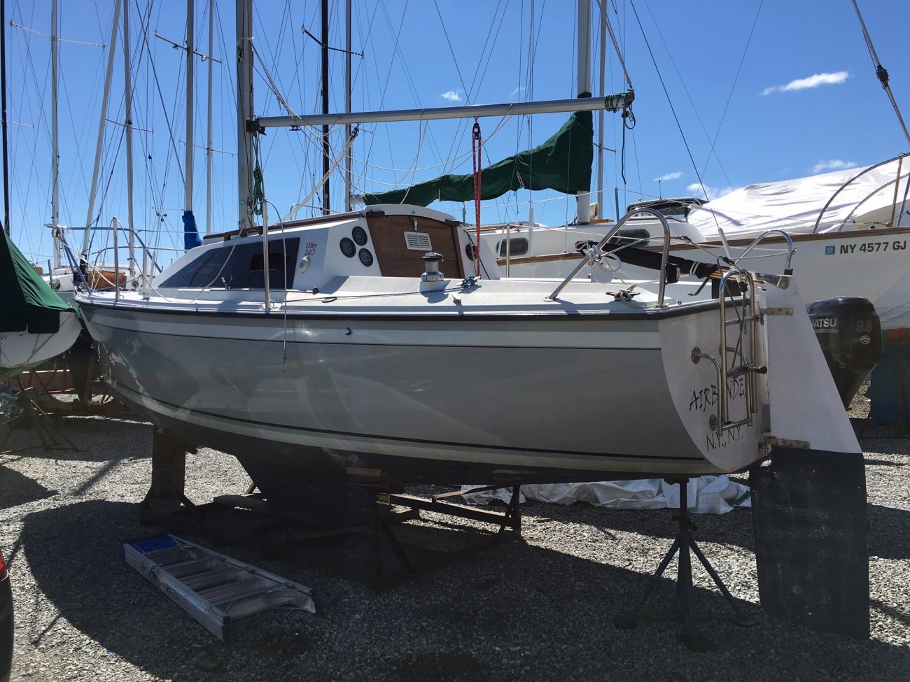

Nice looking boat. I didn’t know they made that model with the grey gelcoat. My last boat, O 240 had the grey gelcoat. I miss the color it was a head turner.

I spent the last 2 months looking at 192’s all over the place and this was the only gray one I saw. Doesn’t seem to be a common color.

Going to use that guide for sure but I think my first step will be removing what looks like floor wax on the hull.

What looks like floor wax is probably poliglow It is like a floor wax. Research the product. They make a solvent to remove it.

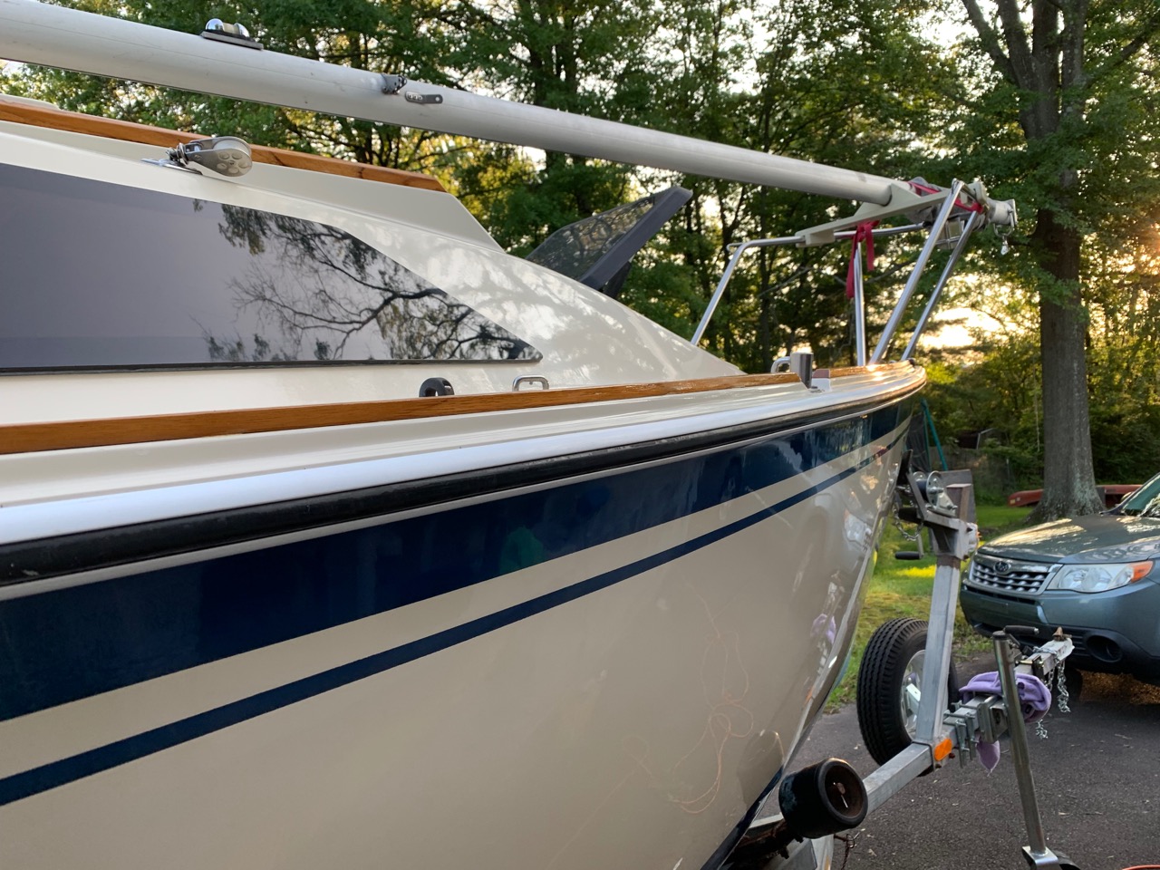

The grey hulls were built very late in the production run. Most were cream and blue. I prefer my cream and blue, but I'd be just fine moving up to a 240, which is also the grey color scheme. Actually, I'm not ok moving up to a 240, because then I'd have to start all over again fixing up a boat. Besides, I like my 192, and it's great for our lake. You'll get good results using Maine Sail's proper buff and wax tutorial. I started out mine with wet sanding, and then the Presta products, but I now prefer annual polish touch ups using 3M Finesse-it with the yellow wool pad. I just launched yesterday (FINALLY!)

My goal is to bring it to that level of shine. We’ll see if I need to wet sand or not (though it’s looking pretty likely at this point).
Couldn’t help but notice that Forester in the background. Do you use that to tow the 192? I have the same Forester and it would be nice it tow with it for short trips around town.

GSBNY, it is a 2011 Forester. I do tow with that, mostly 15 miles back and forth to the lake, and slowly. I'm super paranoid I'm gonna mess up the transmission somehow, even though I don't have to go up hills that require much downshifting. Depending on where you look up the tow specs, the Foz can do either 2,000 or 2,400 pounds, and the boat and trailer are most likely over that limit, because what production boat was ever at the listed displacement spec? Especially with a bunch of stuff in it like put in my boat! :yikes: I've been doing it for 5 years now, and the trans isn't dead yet... Like I said, I don't really exceed 50mph, and I'm mostly towing on back roads.
This fall, Subaru will be offering a turbo Outback that can tow 3,500 pounds. I'd really like to trade into that car. It kills me to take on a car payment again, but I have fantasies about towing the boat to the Chesapeake or Lake George, NY for vacations. I also know that realistically, I probably will never do these things, but I also wouldn't mind a newer, fancier car! :biggrin:

I got the boat today and I think it is poliglow unfortunately. Time to see how hard this stuff is to remove. Then after that it’ll be time to wet sand, compound, polish, and wax.
