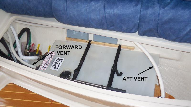

I like Rich's idea of using the "T" off the inlet hose for the second vent. Very straightforward. Suffereing from OCD, I was compelled to add a second vent off the front of the tank to ensure "optomal" cross ventilation from front to back. Monumental love of labour in removing all connecting hoses and tank, washing out the tank interior as best as possible, having a new threaded fitting friction welded in place, replacing tank and all hoses.
Use a "T" in the inlet hose :redface: ............. much easier.
The only thing I would add is to place the second thru hull for the new vent hose as far forward or aft as possible, away from the original vent thru hull. Ensure the new vent hose maintains a slight grade upwards from tank up to the vent to ensure no water "traps" are formed.
In this arrangement, as air flows over the hull, the pressure at the two vents will often be (at least in theory) slightly different due to the different air velocities. This encourages some positive ventilation.
Can't say I ever put much faith in the idea that a single short vent hose from the holding tank to the thru hull could ever contribute anything to the ventilation other than just pressure relief. Considering that H2S has a specific gravity of 1.2 (relative to air), it's not going up the vent and neither is any CO2 at 1.5. If you ever get into aerobic digestion, maybe any newly created methane (SG = 0.6) might assist in transporting some of the H2S up and out. But if you already have aerobic digestion, you have little H2S, and you don't have a problem.
I'm certainly open to any theories as to how a single vent hose can contribute any ventilation to a holding tank :confused: :confused: :confused:.
