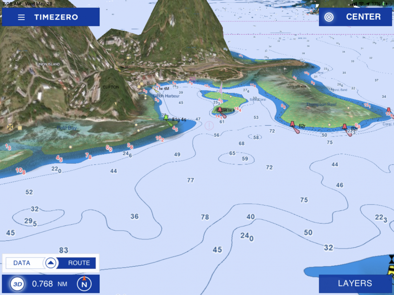

While not my fav, TimeZero is superb for SA, with land elevations and photo realistic views you can turn and tilt to get a water-level perspective.

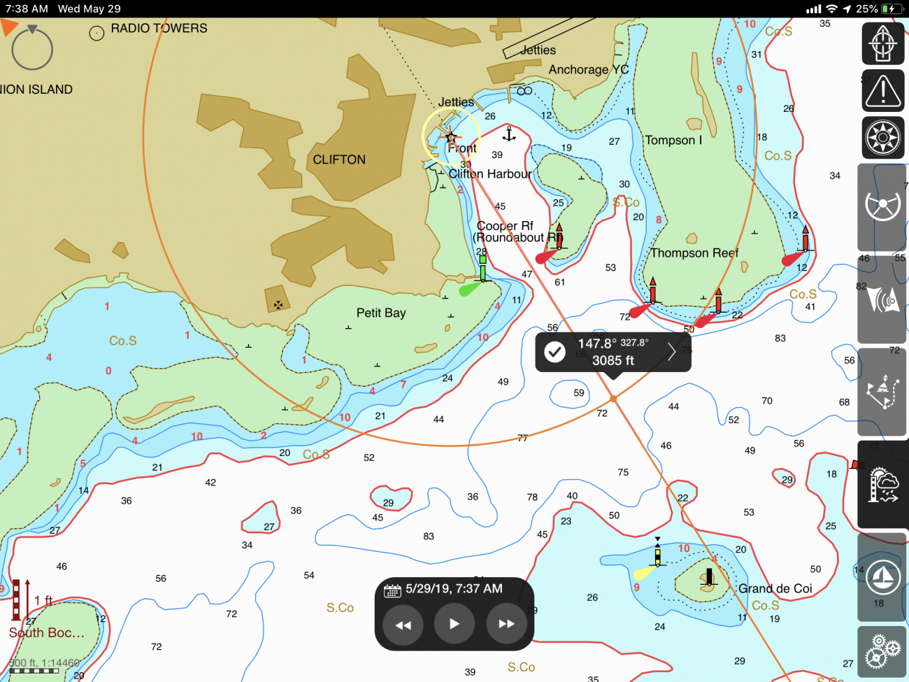

My go-to is iSailor, even though they pissed me off and changed the chart license policy. Anyway, they always have the best charting, and with overlayed tides and currents, makes a great way to know what to expect. Entering from the SW, expect to see what will seem like a straight line of starboard hand laterals in front of you before passing a west quadrant cardinal mark. It shows a couple of shallow mounts, but expect good water on the way. You can plan to turn when the light/day mark on the jetty hits 327 true on your bearing compass (adjust for dec!). Stay channel center passing between the two laterals at harbor entrance.
