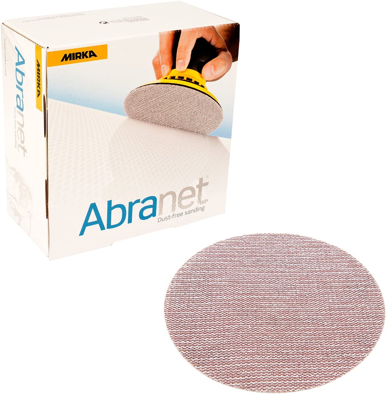

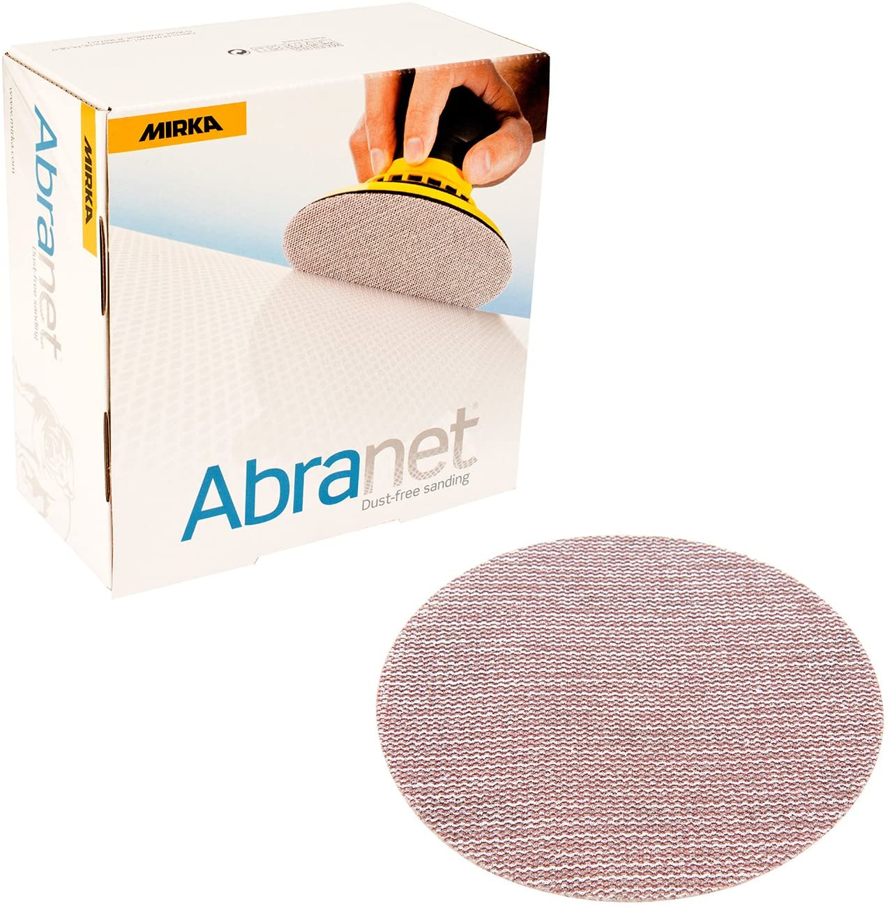

That is where a "sanding disk" on an orbital sander comes into play. Not just any disk. I saw this "Screen" on a youtube video of a guy in Europe, Sweden I think, sanding his fiberglass project with a sanding screen. They were lasting him much longer then the sanding disks do on my sander.
Here is the product. Mirka 9A-241-080 6-Inch 80 Grit Mesh Abrasive Dust Free Sanding Discs, Box of 50 Discs They are available from Amazon.
I plan on giving them a try on my next project. They may be helpful to you.
And you know that these must be good given that they are highly recommended by a guy who is know for the phrase "Oh, Glorious sanding"!
I have used a lot of sanding screens in construction for sanding T&G wood floors with a floor polisher but had not seen them for the 5" & 6" orbital sanders. They should also make the dust evac system work much better because they will let the air flow horizontally through the disk. I plan to build a pre-filter for my shop vac before the next bottom job.
