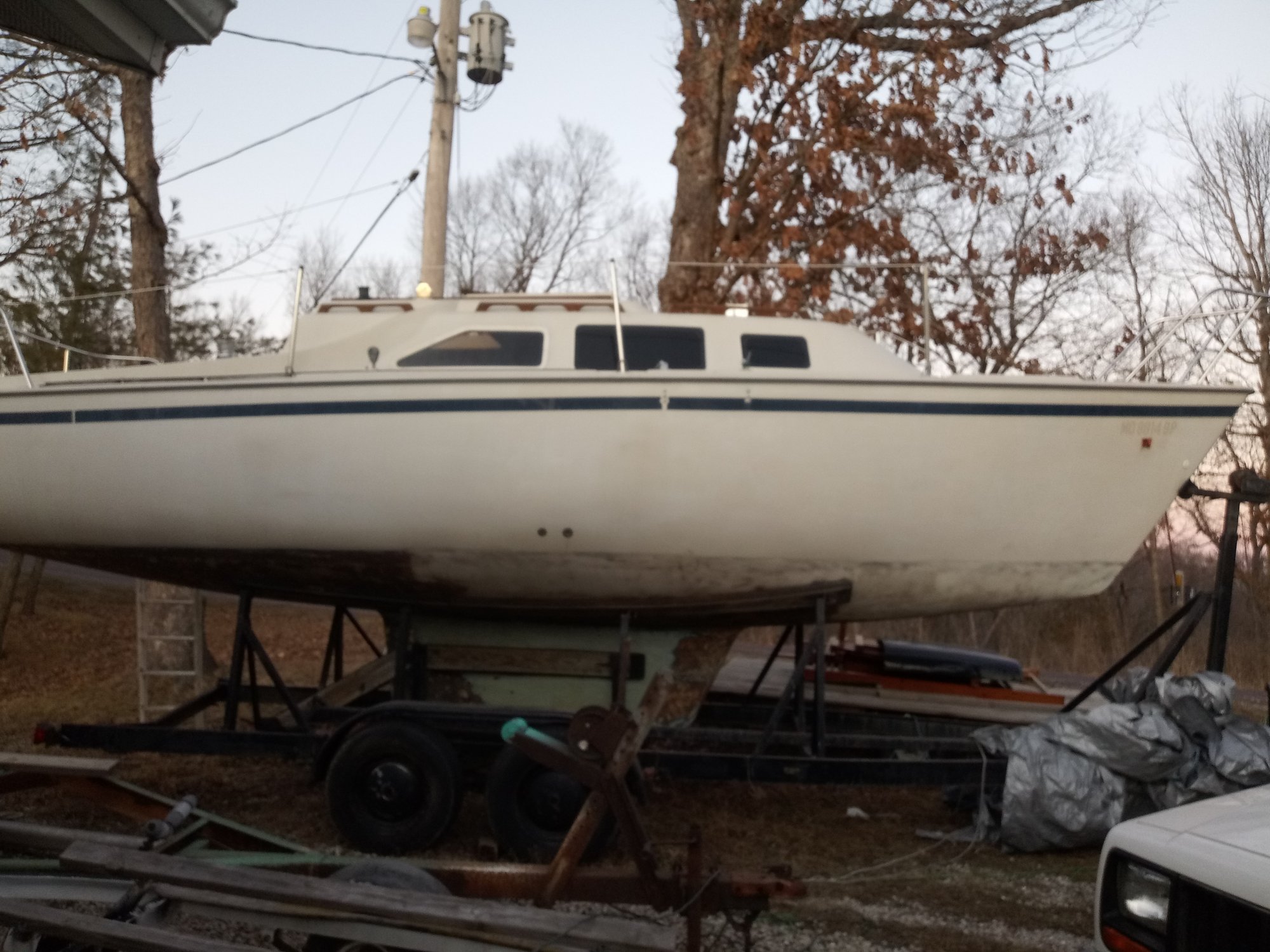

I had several layers of old flaky bottom paint. i found it faster to scrape it with a 4" razor scraper then sand. i am just sanding with 60 grit on a Wal-Mart special $20 orbital.
Aug 10, 2020
611
Catalina, Hunter C25 3559 Rocky Mount
I had 3 hours a 4 blades invested in the scraping. The sanding took about an hour and a half to do one side of a 26ft boat minus the keel. I have to take the keel bunks off before I get to that. You can see the end result in this picture from when I was working on it before the iceage moved in.

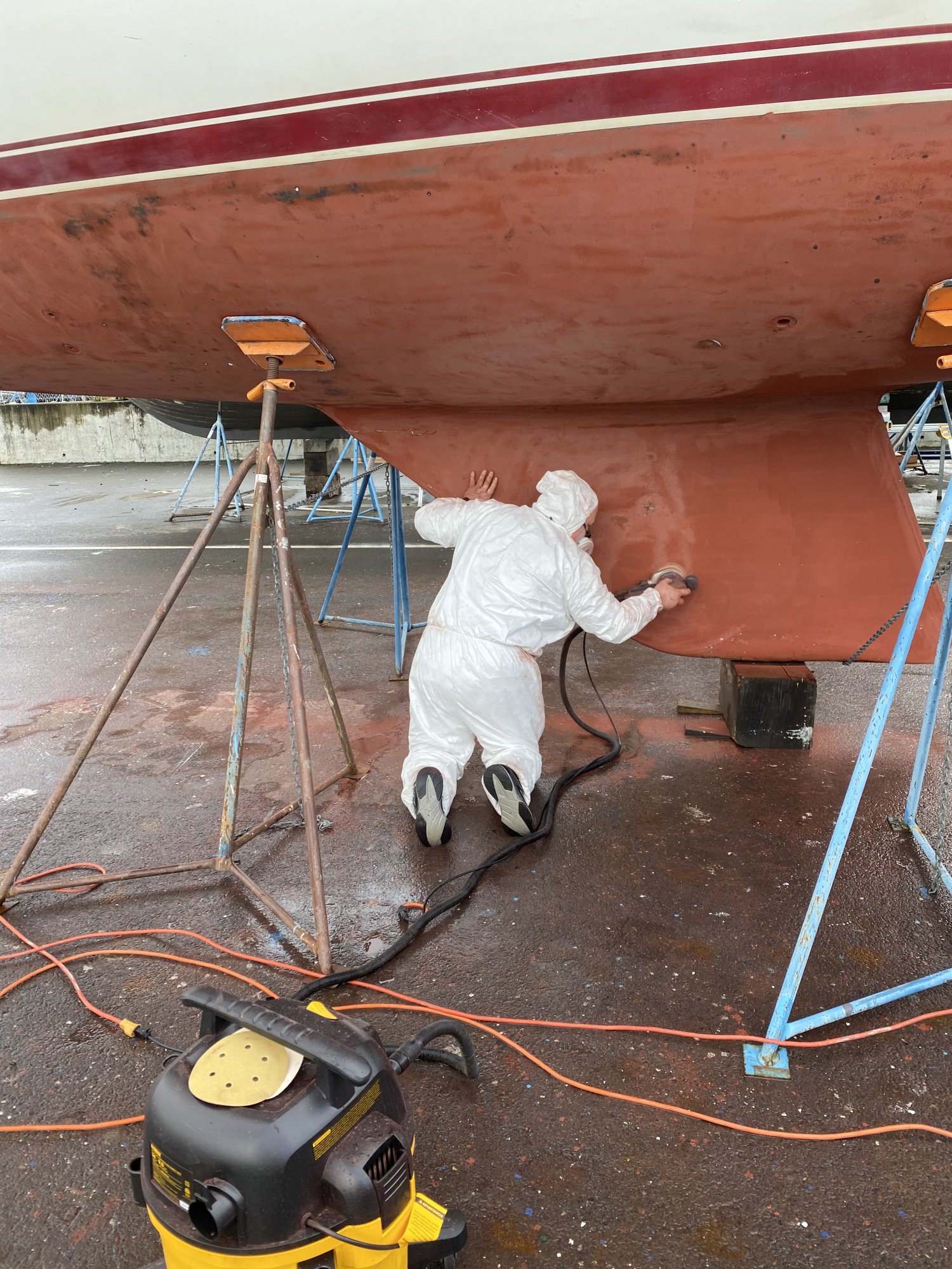

I have a Bosch Orbital Sander purchased from Lowes.
It has a vacuum hose connection that sucks most of the dust to a vacuum with a HEPA filter Bag.
Bottom jobs need to have some grain sanded into the existing paint so that the fresh paint will adhere. It does this either chemically of physically. You need to create a roughed surface for a physical bond.
I have used 80 grit sand paper. It is a job but it can be done. You have to throw the paper away constantly to keep it fresh and still working. You want to suck up as much of the dust you create as possible.
