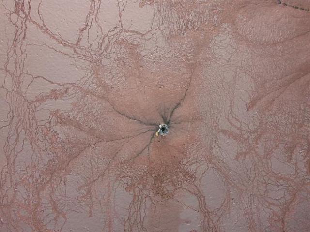

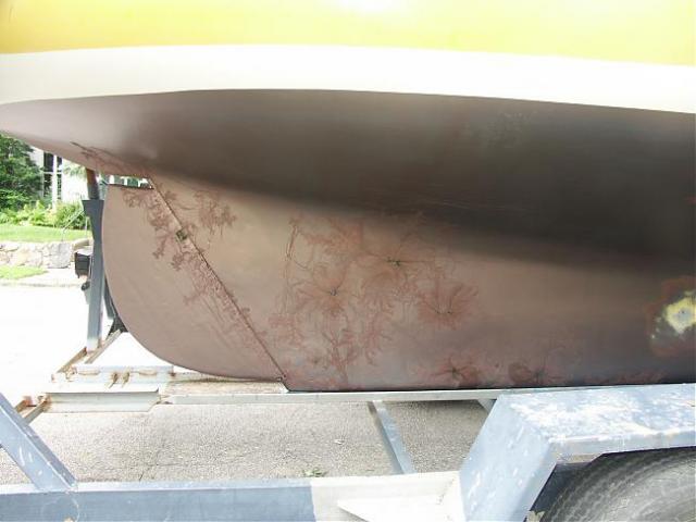

I'm doing something I consider pretty rude.. but I saved the attached pictures that someone else posted on a different forum (Sailnet I believe) and re-posted here. I cant find the original post - my apologies to whomever took the pictures, if you see this, please take credit for them.
From what I understand, the boat was in the water at the time of the strike, dont know if it was fresh or salt. The interesting thing is that the lines in the paint are a snap shot in time of heat and should represent the flow of current. You would think that a large piece of metal sitting in a conductive fluid would just have current punching through the paint and then "radiating" outwards into the conductive fluid. I.e., you might see a lot of pinholes where current blasted through the paint. Instead, it looks like there are current paths flowing in the paint between the water and the metal keel and form all the spider web patterns. I'm guessing that this is ionized flow in the paint as this is the lowest resistance path. Water is probably on the order of 40 times more difficult to ionize than the paint - so the flow is in little ionized "mini lightning bolt streams" in the paint (dielectric constant of paint probably about 2, water is 80 and air is 1).
Could be wrong however..

Do not count on the lead keel to be a giant capacitor. Electricity only flows on the outside of metal. .
I have to correct that statement somewhat. Only high frequency flows on the outside of metal. It's called the skin effect. An demonstration example is a Faraday cage.
Lightning is not high frequency and flows through the metal as well.
The rest of it stands on the keel not being able to absorb electricity in any form.
