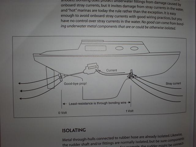

I could be wrong but I have a real hard time with the concept of stray current in the water at marinas (ie, the reference Hermit posted a couple posts back). An example..
Let’s say that one boat has an electrode in the water which is at zero volts potential and another boat 100 foot away has an electrode at 100 volts.
The resistance of the water very close to the hot electrode is fairly high as the effective area of the water in contact with the electrode is small. So electric fields and current right at the hot electrode are also fairly high.
But as you move away from the electrode, the volume of the water increases by the cube of distance - so the resistance "seen by the electrode" also decreases by the cube of distance (current in water doesnt flow in a stream - in this case, it will "radiate" outwards from the electrode in
accordance with ohms law). This results in the electric field falling off very quickly with the cube of distance (actually likely between the square and cube since the water volume seen by the boat is a half sphere). So at even a fairly small distance away from the hot probe, the "local" current and electric field are very small and both fall of very rapidly with distance.. The boat at 100 foot away shares the entire volume of water in a 100 foot radius from the hot boat electrode. Its electrode is effectively a single point on the outside a large sphere of huge volume and if the current falls off at the square of distance, the current at 100 foot would be 1.4 million times smaller than at 1 inch. If the current falls off at the cube of distance, it would be 1.7 billion times smaller than at one inch. I.e., I can’t see the hot electrode having any influence on a second electrode 100 foot away.
Also to point out.. an outboard motor with AC on it would also have the electric field increase very rapidly with distance as you got close to it which is probably why they can be so dangerous.
On the other hand, AC green earth wires at a marina not being at earth potential is very believable. But you can solve this with a galvanic ground isolator.
