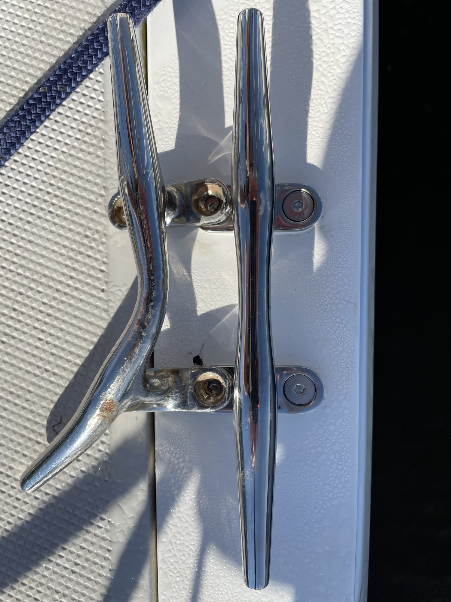

I had a tube aboard and used about half of it on small repairs. Then the remaining tube hardened and got thrown out. Much cheaper to get clear JB Weld or other quick mix epoxy. I used Maine Sail’s repotting technique and made large backing plates from 1/4 inch aluminum on mine. Probably overbuilt.
KZW
May 17, 2014
831
Catalina 310 #307 Bluewater Bay, FL
I found the following is a drop in replacement. It is close (not a perfect match) to the height, size (diameter), and taper of the existing cleats:
Suncor Stainless 10” open base cleat S-3110-0000-C
