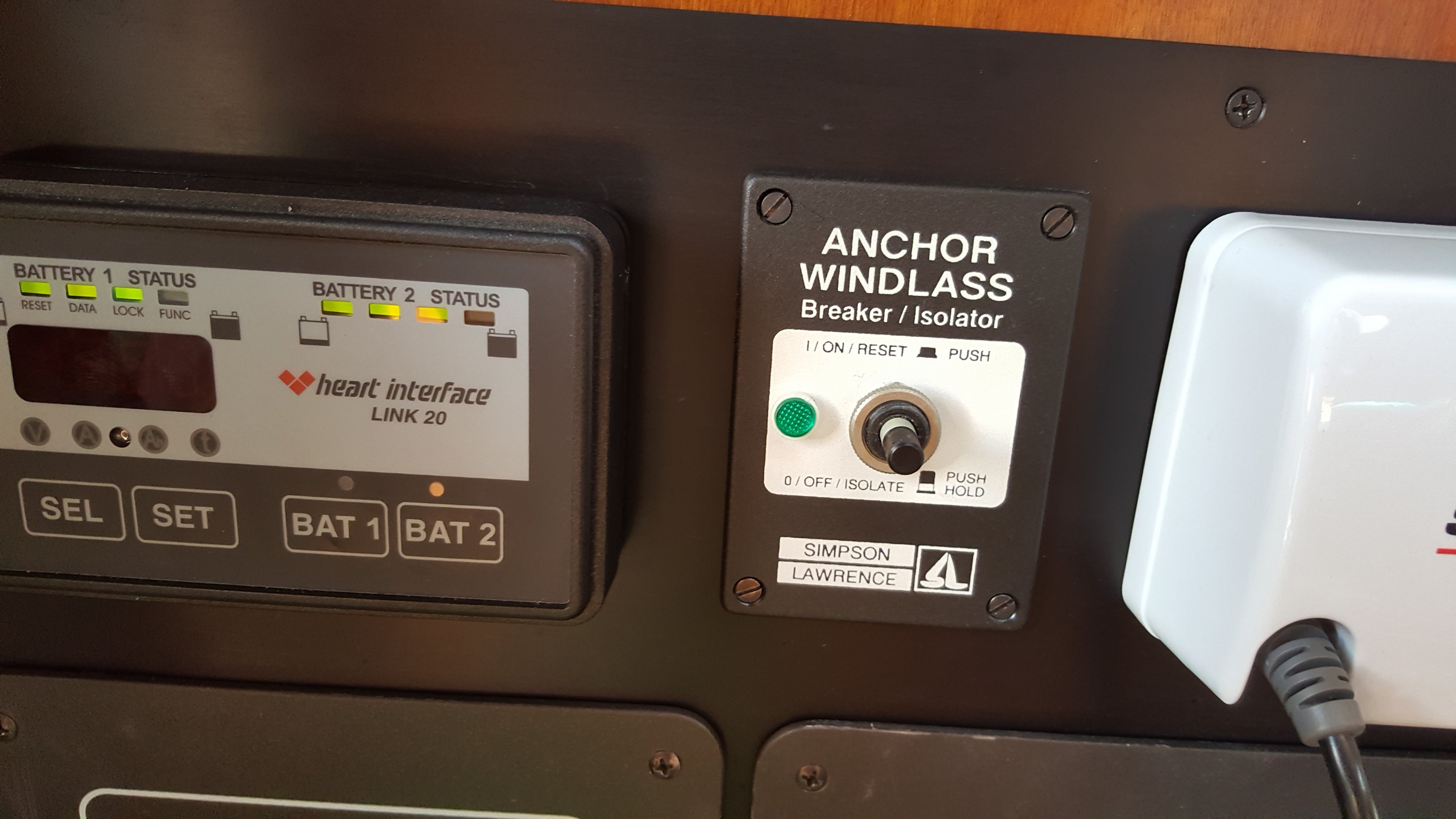

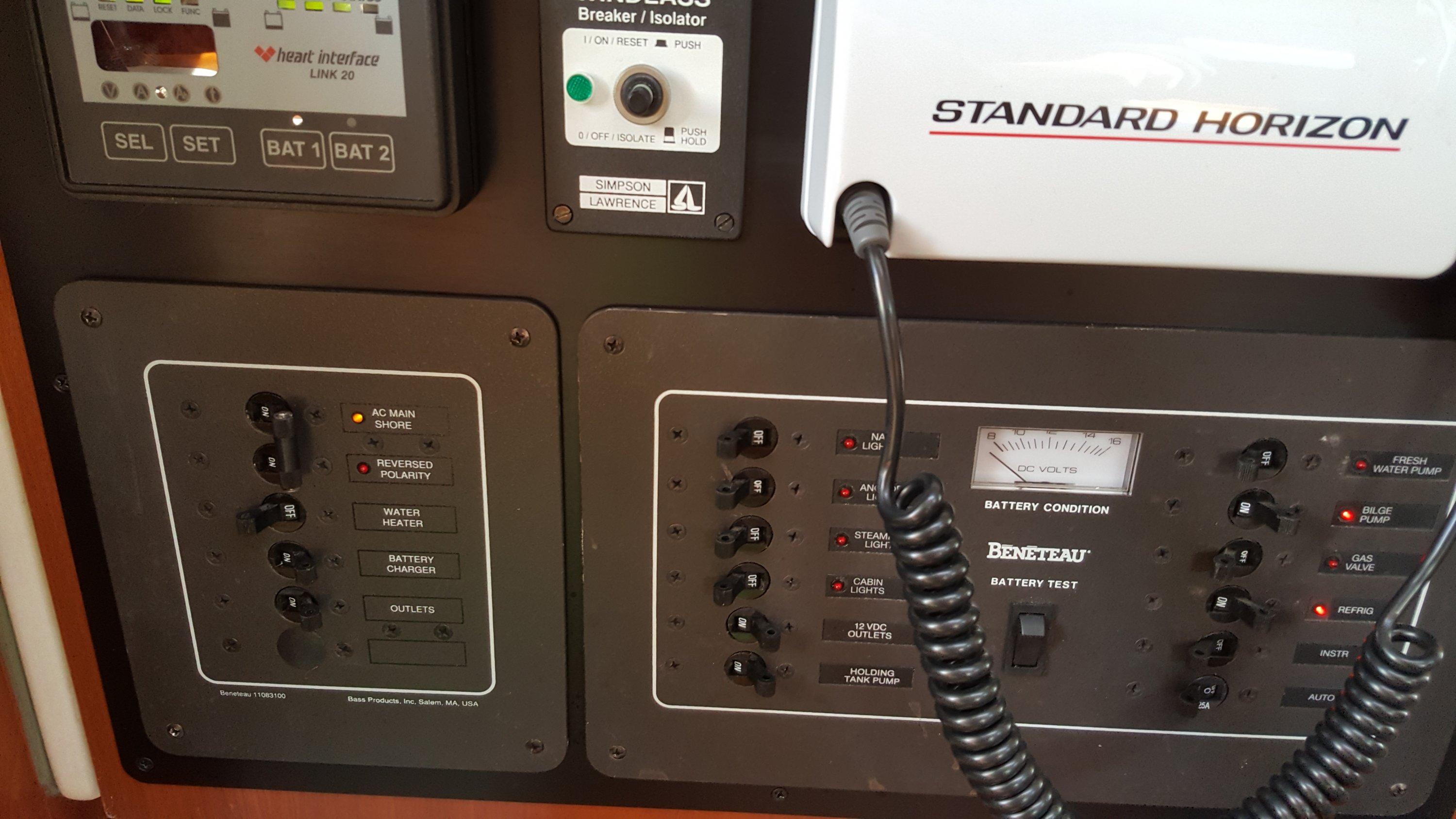

On question number one, you should have on your nav station a fuse/switch indicator that shows you have "good power" after you plug in your power cable (the yellow thing). That will tell you that you have power to the boat. There is such a thing as reverse polarity indicator, same place, which is red. There also should be a fuse/switch for your battery charger. I will post a picture of my panel as soon as I get to the dock. I have O321.

Here are the photos of my panel to give you a visual of what I was talking about. Note the AC power indicator with the reverse polarity indicator below. Ask other questions and I will try to answer what I can.
