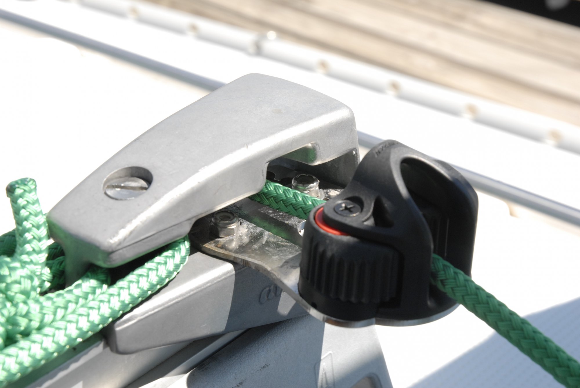

Depends on how your traveler is rigged, cleated. On my 310, I have exposed cam cleats and just have long tails on the traveler lines that reach back to the wheel. With those, I can "snap" the line out of the cleat and adjust accordingly. See the pic. That's not an OEM setup, I had to improvise when I discovered the OEM cleats inside that Amiot end cap were shot.

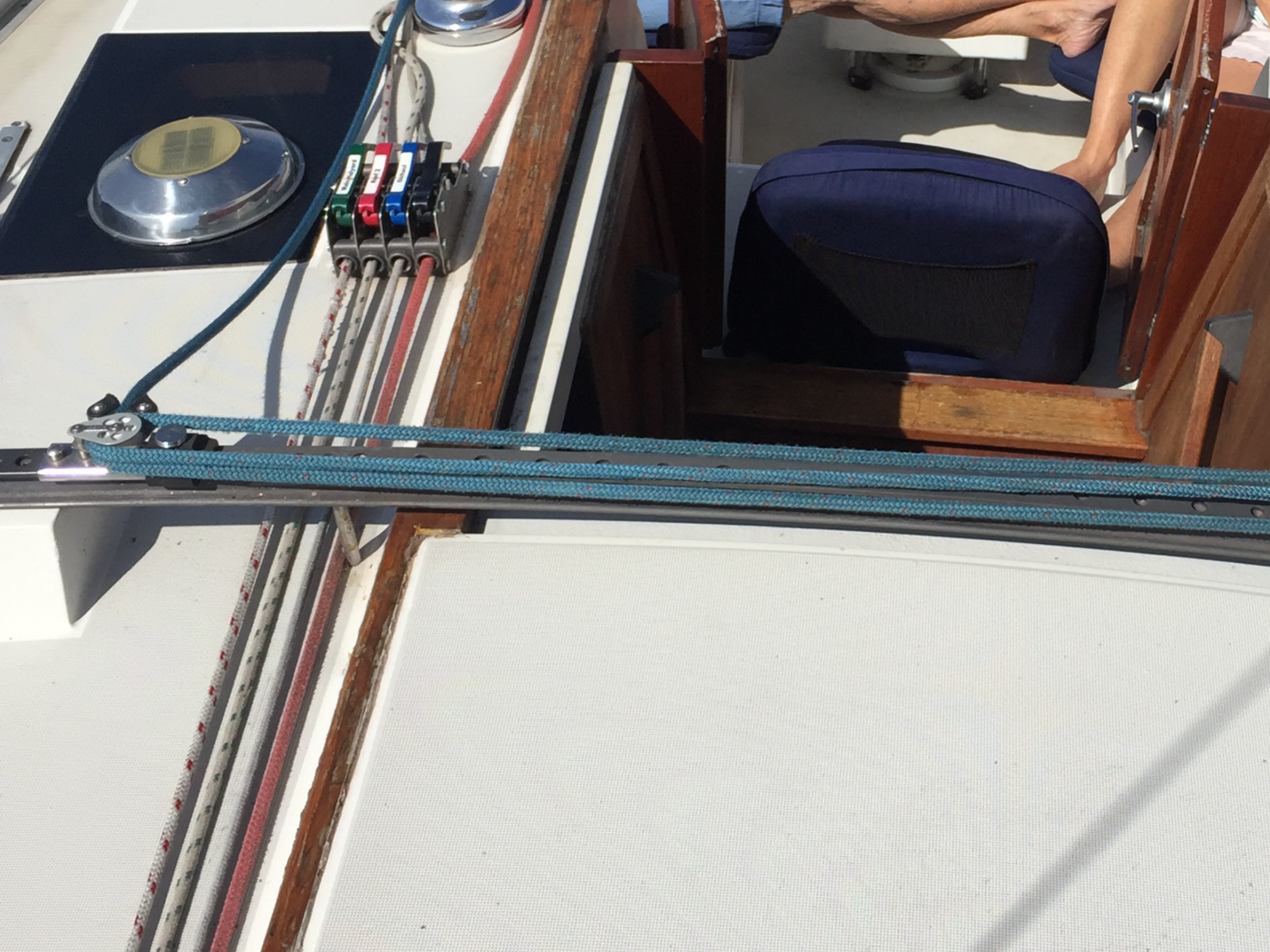

Like @JRacer,I have long leads on my traveller lines, so I can stretch them out on the cockpit seats, and grab them when needed.
My cockpit isn’t nearly as long as the B373 (one of my dream boats by the way)...but I can a hand on the line most of the time.
When I bought this boat (O’Day 322) the PO had set up a single-line traveller (like a loop). You had to literally stand in the companionway and reach over to the traveller to adjust it. One of the first things I changed.
You can see the port line in this video. I am not single handed (my mother snd sister were with me) but pretty close ;-)
Sometimes the lines end up on the cockpit sole, but then it means it was an exciting sail!

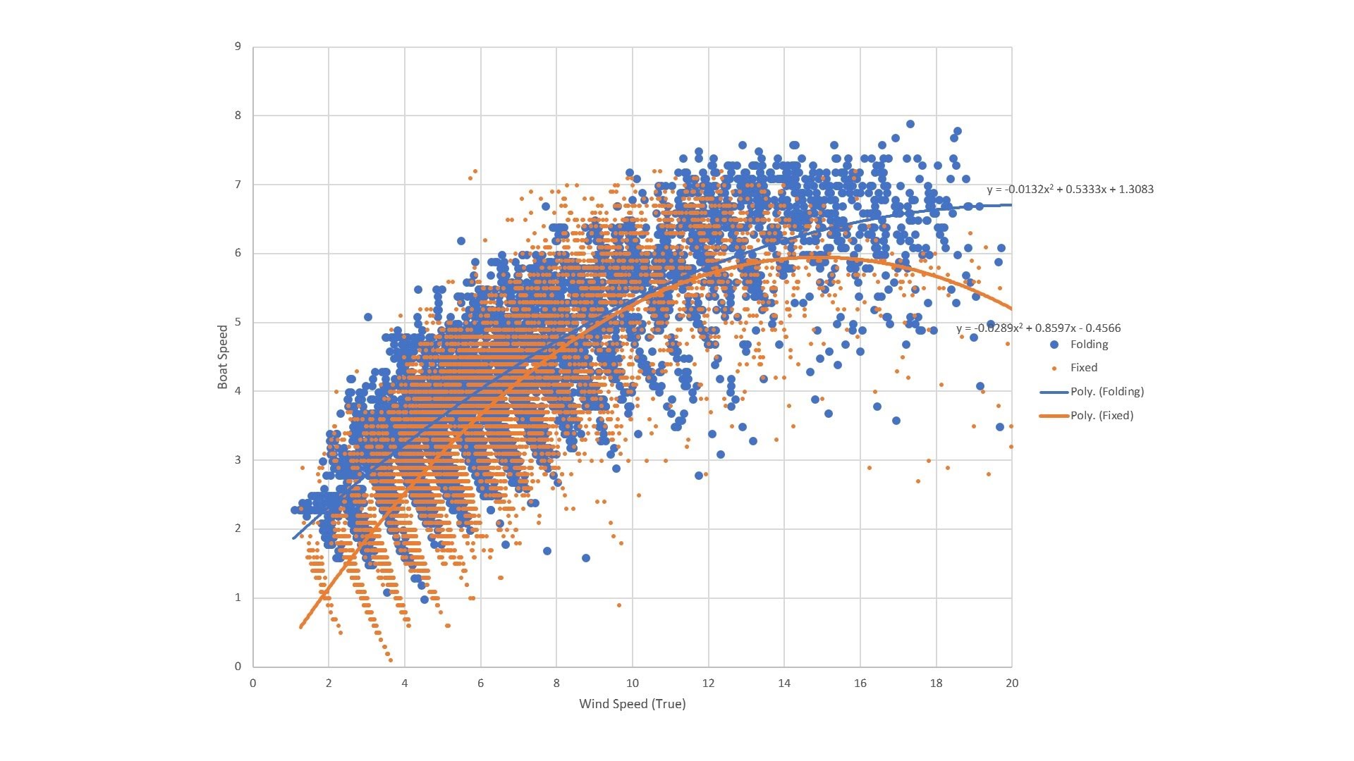

While this does not answer your question: the rounding issue on my 373 was significantly reduced by swapping the fixed 3 blade propeller for a self feathering 3 blade. At the same time I replaced the furling main with a vertical batten main and reduced the genoa to 110%
The net result was improved pointing, less heal and marked reduction in rounding.

Jose, what change of these was responsible for the reduction in rounding up or what is a bit of everything? At first I was having a hard time attributing any change to the prop but then wondered if it could be that the fixed prop was causing enough disruption in front of the rudder to cause it to lose grip? At first blush the reduction in jib size could certainly help pointing but the center of effort should move further back, wouldn't it? If you had problems with rounding up I would think you would not want to move the COE back.
Assuming you replaced the furling main with another furling sail, and the original was stretched out and baggy, I can see a new sail really changing the balance.
Thought provoking and interesting.
Dan
May 17, 2004
6,139
That was my experience with going from a fixed prop to Flex-o-fold on the Beneteau 37. With the fixed prop the rudder would stall relatively easily with winds in the high teens. After switching to the FOF (with no other changes to the sail plan) the turbulence from the spinning prop was removed and the rudder holds better.
See this comparison of my upwind boat speed -
Notice how the speed with the fixed prop dropped off at the high wind range, where the rudder would stall and become excessive drag.
