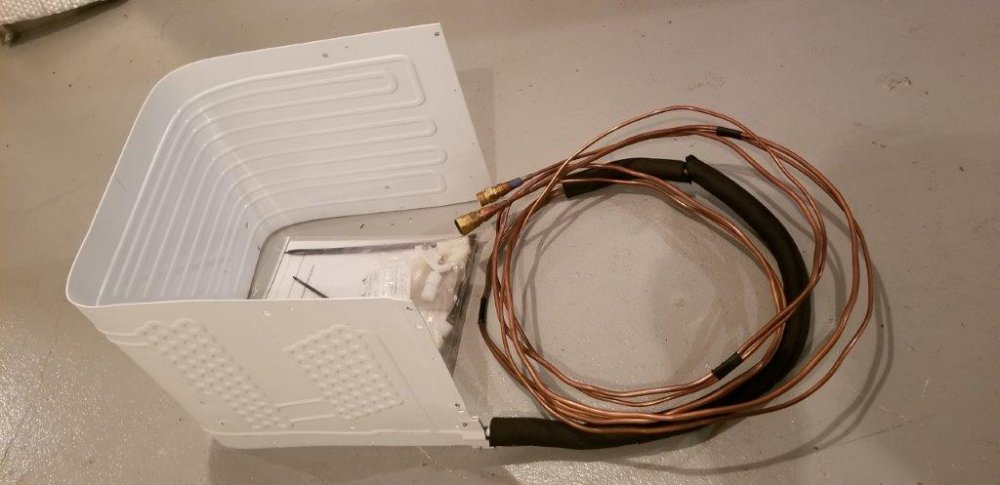

Does your evaporator look like the attached file?
No, the dimensions across the U shape I have is approx. 13 7/8" for each of the three sides. The rectangular image you show is available from Defender but I am not too sure how well that would work attached to the side of a 15" square ice box.

John, I had the evaporator that Joker posted installed in my B361. So far on year three and (knock on wood) it is working nicely. I didn't install it myself as I'm not confident in my handy man skills. The installer installed it with the open side pointing up. Mine didn't come with a door for the evaporator, and the installer crafted a "lid" for that little freezer compartment. I'm able to make ice for the G&Ts.

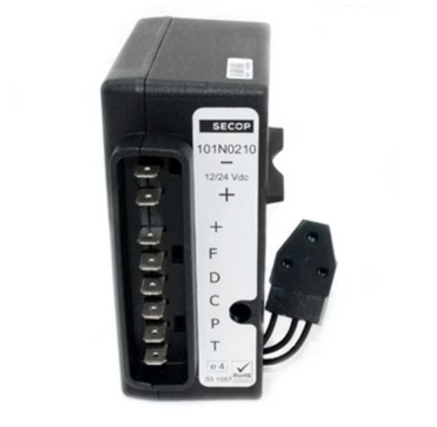

The fridge on our 331 quit last year. The fan would run but the compressor did not come on. I replaced the following part, Secop/Danfoss controller. Part No 101N0212. it cost about $89. It works perfectly now. See pict below. The module was plug and play.

Search online for 101N0210.pdf, the manual for the electronic module. You can connect an LED which will flash error codes that might tell you what's wrong.
"LED (optional, Fig. 1)
A 10mA light emitting diode (LED) (6) can be con-
nected between the terminals + and D.
In case the electronic unit records an operational
error, the diode will fl ash a number of times. The
number of fl ashes depends on what kind of op-
erational error was recorded. Each fl ash will last
1/4 second. After the actual number of flashes
there will be a delay with no flashes, so that the
sequence for each error recording is repeated
every 4 seconds."

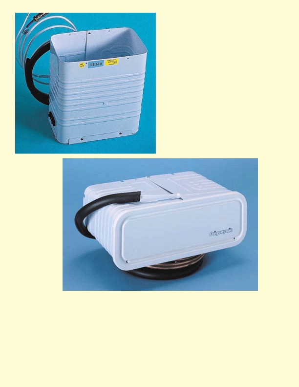

Defender has a bunch of different plate configurations offered by Isotherm. You may find it easier to purchase a different shape that is rated for the same cubic foot space. I highly recommend not purchasing the Smart Energy Control module it. They also offer "bendable" plates but that seemed a little error prone to me.

I did the LED lamp check and it was my controller that was bad but I couldn't find a reasonably priced replacement. Even past that, the compressor was 19 years old. The new controllers are 4-pin. The older ones are 3-pin. I elected to change out the compressor, controller and dryer. At a list members suggestion, I bumped the compressor size up one model (same bolt pattern) and bought a dual voltage Secop controller 12VDC and 120VAC.
