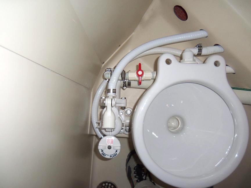

Would like to replace the Jabsco manual head in our 331-2003.
Considering a Vacuum head.
Any suggestions?

A vacuum head is complicated with additional vacuum vessel that takes up additional space and significantly higher cost VacuFlush Toilets | Marine Toilets | Dometic (environmentalmarine.com). I had vacuum flush toilets on a powerboat and liked them until visitors overloaded them with TP or dropped a cork in them and each repair was $1000. Why not buy a fresh water electric head with macerator like the Raritan Elegance Marine Elegance | Raritan Engineering? That is what I recently installed, albeit I already had power supply. This thread addresses electric vs vacuum head Electric Vs Vacuflush head | Sailboat Owners Forums.

Also our holding tank’s capacity is limited, aprox 18-20 gallons.

Maybe the first question here should be WHY as opposed to a conventional, shall we say Raritan ? Makes no sense on a boat of this size.
Jan 4, 2006
7,771
I am also considering replacing with a conventional Raritan.
Excellent choice. I recently changed over from a Jabsco POC to a Raritan PH Superflush model. The floor bolts are an exact match and only had to relocate the 1-1/2" discharge hose as it tightly exits through the rear wall. Went all out and also installed a fresh water rinse as well.
