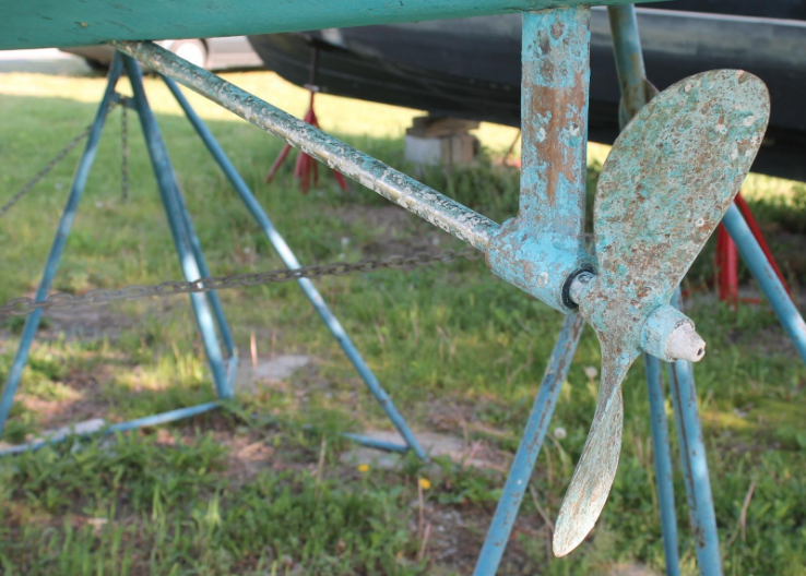

-In the second photo, the propeller looks very dusty. Do you thing I can sail her like that, or should I replace the propeller immediately? I know I will eventually have to do that, but can it wait?

I'll defer to others on the keel imperfections because I haven't seen U shaped cranks like that. For the prop, it's a little hard to tell whether it's pitted from corrosion or just coated with the residue of barnacles. If it is putting it looks to be prevalent enough that the shaft and prop would both be at risk. I'll add that the prop shaft doesn't seem to be centered in the strut, as if the Cutlass bearing is worn, so replacement may be in order depending on if there is play in the shaft or misalignment.

Nothing wrong with prop. Just a little corrosion. Now that keel smile. Is a common problem on sailboats. A little 3m 5200 bottom paint good to go. On a 1988 boat I'd be more worried about sails and the rig. New sails cost upwards $5000. And does the boat have any maintenance records. How old are the wires holding up the mast. And what do the haylards and sheets look like rope. Or cordage gets expensive to replace

The prop, shaft and strut aren't that bad... bronze will exhibit a blue/green patina over time... (statue for liberty, for instance.) so you can sand or stiff bristle brush it off if you choose. What's important is to maintain the anti galvanic zincs on a regular basis... Sea creature growth will be much more pronounced and I don't really see a lot.
The keel crack looks like fairing compound/paint originated. If it were horizontal it might be an issue related to the keel/hull joint/seam.... not an unusual problem btw.. but yours looks different.

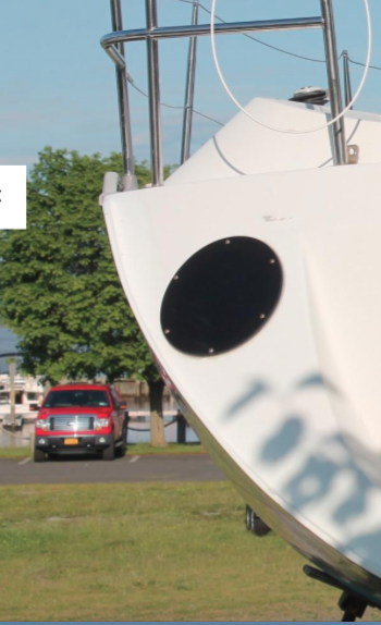

That black dot is just a (Lexan?) portlight. My B235 had one. After feeling like I was suffocating in the 1/4 bunk, I put in an opening port. It opened inward. I think it was a Beckson? I highly recommend doing that. The opening one has a raised lip on the outer side, over which I put a plastic piling cone-cap. Cut away some of the bottom of it, and you can leave it open in the rain (but not following seas).
