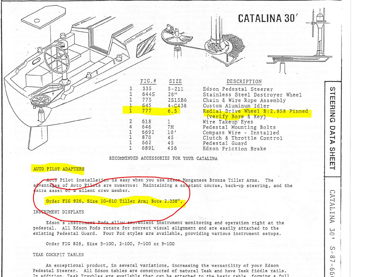

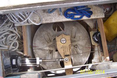

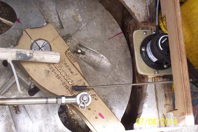

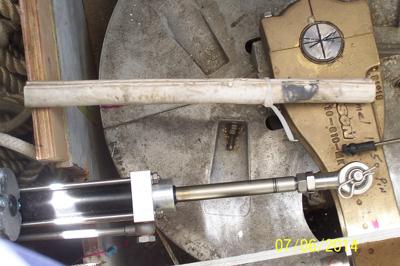

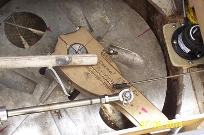

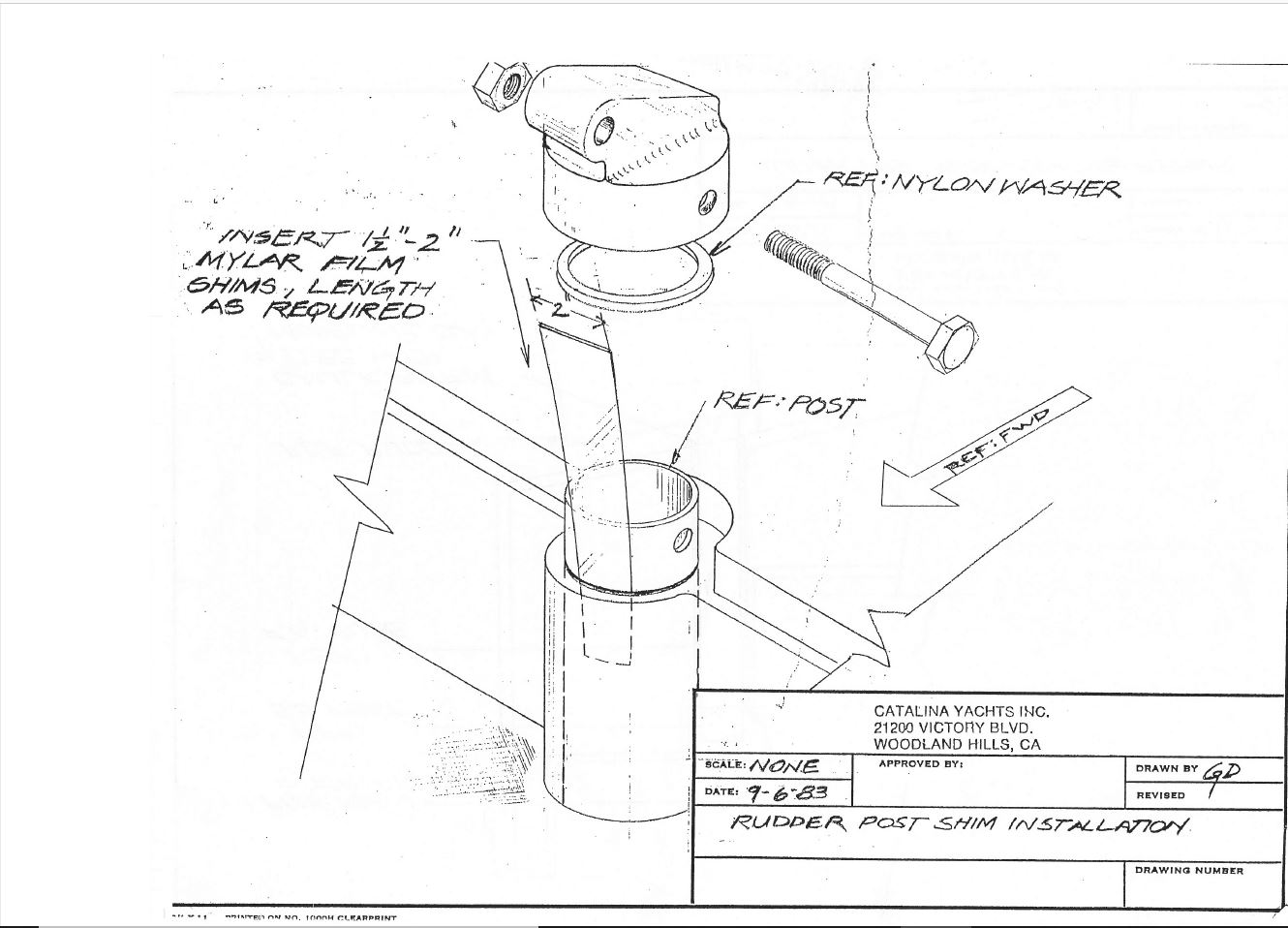

Thanks, guys, for the support. I'm adding some artifacts that give specs on the drive, the bronze tiller arm (Edson) that will connect the actuator of the arm to top of the rudder post, and the rudder. Based on the drawings, I believe I'm dealing with a radial drive steering system with the full wheel. I'm also including some images of a similar setup on a different boat.
Please let me know your thoughts and I welcome any encouragement. I also think this will be well worth the effort once it is complete.

Hey shemandr - I found that article you mentioned and it is SUPER helpful! Really outlines, mechanically at least, everything I need to do. Now I just need to inspect and do some measuring to see what I have to work with down there. I'm understanding there's significant differences between the Mark I, II, and III so we'll see if I get lucky. I read that with the Mark IIs they no longer put the 'cap' on the top of the rudder shaft where it comes out of its tube. If true, that's very fortunate since I'll need about 1.75 inches of shaft (insert 'That's what SHE said!' joke here) to attach the tiller arm. Going to go take a look this weekend to see what I've got to work with.

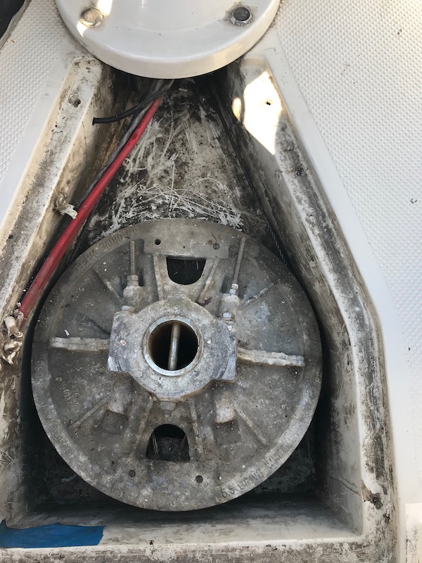

If it helps with your planning I here's a photo of my the radial wheel on my 93 C30. Only about a 1/16" of the rudder post exceeds above the radial wheel and the radial wheel it sits on the top of the fiberglass cone of the shaft tube.
Maybe if you cut the top of the fiberglass dome off and used the tiller arm to support the rudder post?

Catalina 30 Mk II Severna Park, MD
Thanks, Ward. Good pic. So is that a SEPARATE piece sitting on top of the radial wheel that's fastened around the shaft? Or is it actually part of the wheel casting? If it's just a separate piece that looks like it acts as a 'cap' to the top of the rudder shaft, I don't see why I couldn't just put the Edson tiller arm in its place. Please let me know if you can.
