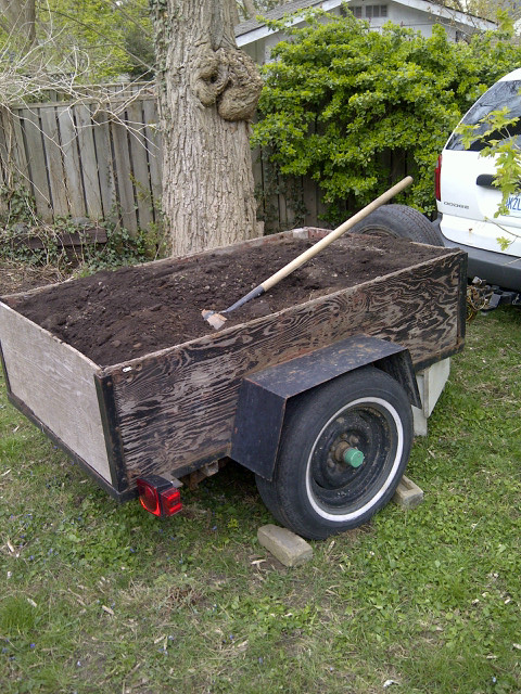

Here is what I did for my utility trailer. Its a spray paint can lid taped on with electrical tape. Fancy eh. It works. The other side has a red one. The can of black wasn't quite empty. If there is a small vent hole in the lid just put a screw in it.
