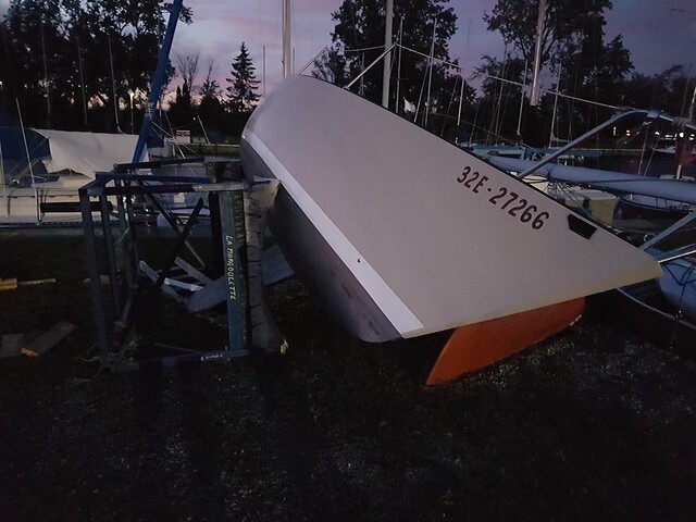

So sad. His first sailboat.
My last boat had a cradle. They are a tedious to work around, compared to jack stands. But I think of them as being safer especially compared to just two jack stands per side, which a boat that size might have used.
I copied the photo and lightened it a bit. It looks to me like the brace on the forward starboard post, let go. The weld may have failed? But even wouldn't seem to have precipitated the boat falling. The post weld must have let go, too.
And even then, if the keel is bearing flat on the cribbing (or cradle, in this case), the aft stand alone, should have held the boat. That is, unless the keel was able to rotate? Seems there should be curbs on the bottom rail of the cradle, to prevent the keel spinning. All useless thoughts now, but maybe something will be discovered that will save someone else having a similar incident with a cradle.

That cradle looks to be very lightly made. I’m no steel worker/welder/metal worker but I’ve stored my 28’ O’day with many other boats on cradles and I’ve seen lots of cradles over the years but I’ve never seen one made of such light weight parts.
Gunni
Mar 16, 2010
5,937
Those are not brownell jack stands and chains, that is some jack leg junk. Way under designed.
10,536
-na -NA Anywhere USA
Cradles are made specifically to the individual boat. Looking at the cradle the support braces are low with the jack screws way too high which is a major issue. Also age and use of cradle unknown to include maintenance as well

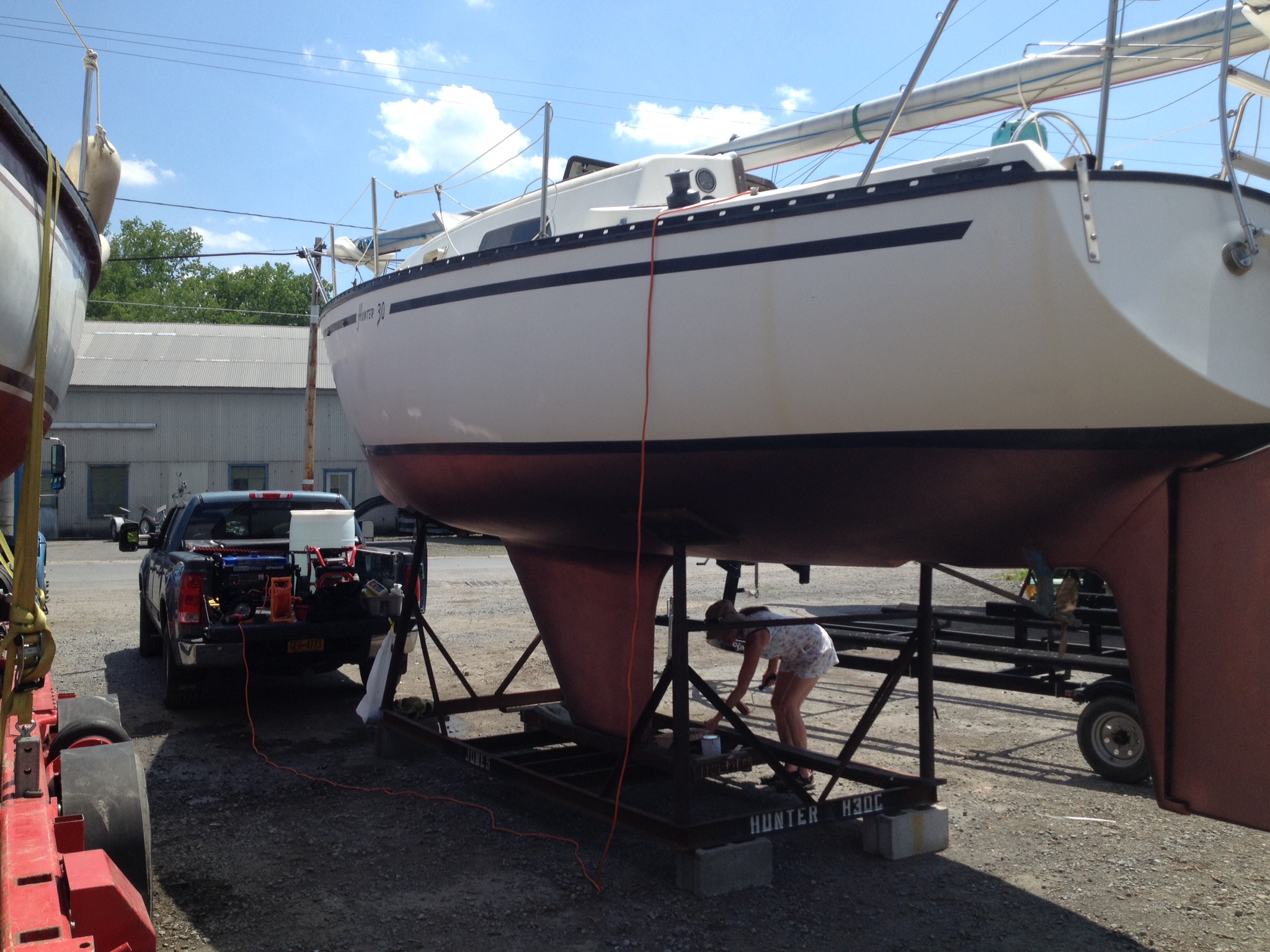

I think we don't know enough about the incident to make general statements about the safety of a cradle.
Clearly one of the supports failed, but we don't know if the boat was properly sitting in the cradle with the weight of the boat on the keel. We don't know the condition of the support, was it rusted? Was it cracked? What about that large blue tarp, was it covering the boat? Did wind catch and start rocking the boat? Had the owner lowered one of the supports in order paint under it? There isn't much information about the events leading up to the cradle collapse.
If there is a takeaway, it is that we can't take cradles for granted. They need to be inspected each year for any rust or damage. If there is damage, then it needs to be repaired properly.
Given the choice of a cradle or jack stands, I'll take the cradle any day. They are much more stable and less subject ground movement and heaving. Less chance of the boat falling off a cradle. It's hard to put a boat into a cradle incorrectly, not so much with jack stands.
@BlowMeAway Your cradle looks fine. Next year ask the yard to put a couple of blocks in middle to better support the keel, right about where your wife's feet are.

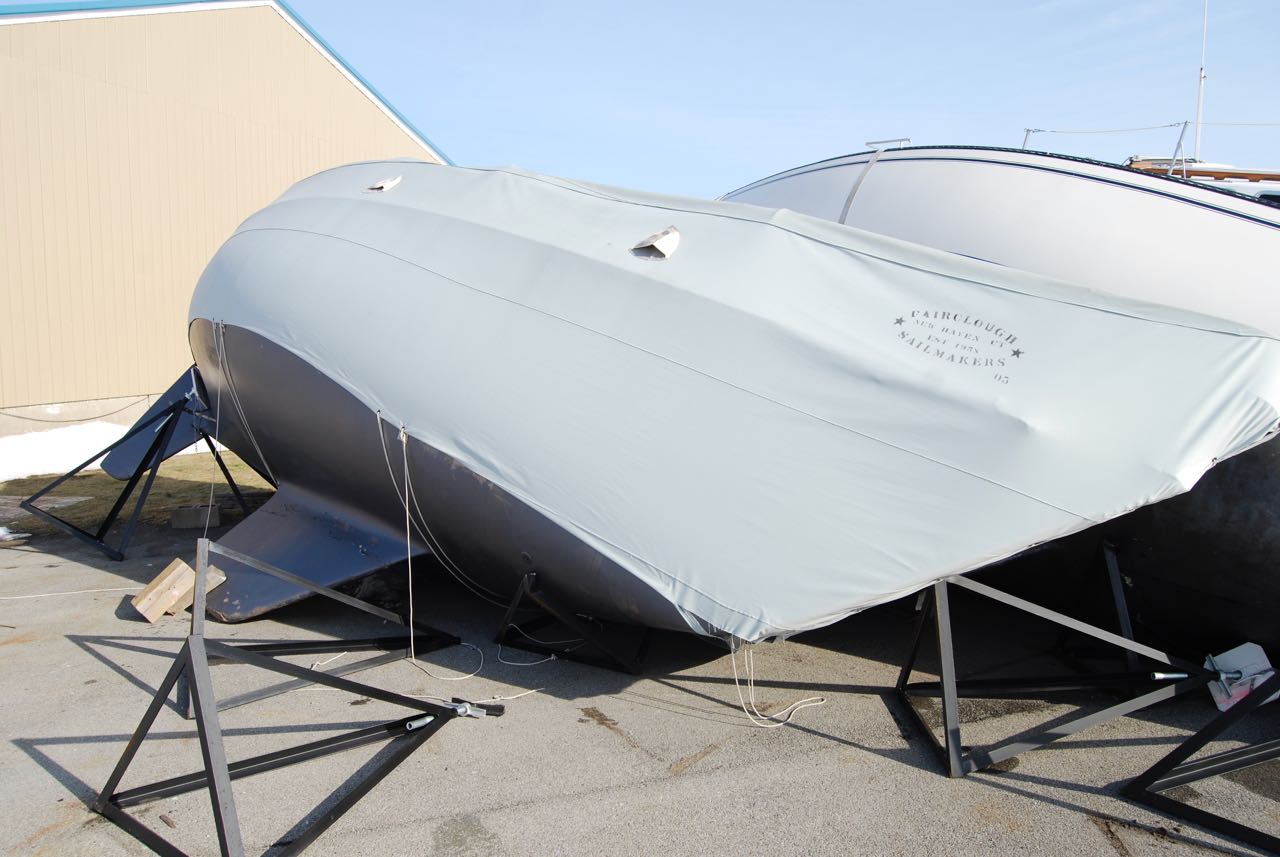

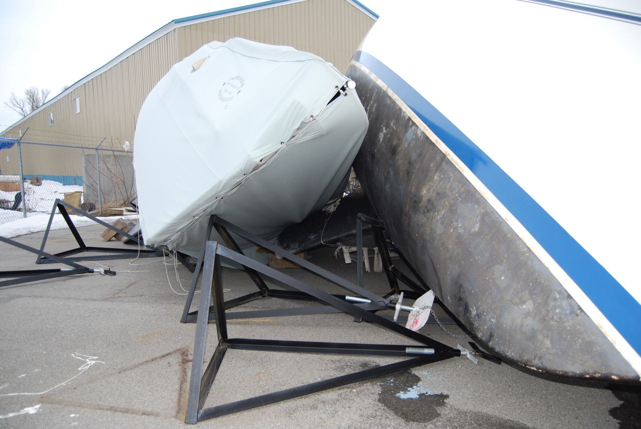

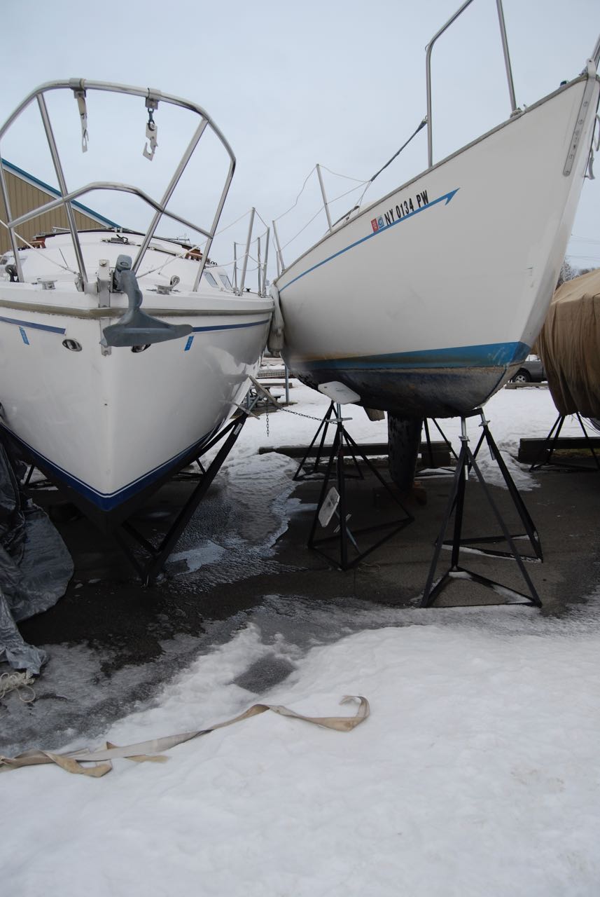

A windstorm took out 3 boats. Mine was the first one. That's not the phone call you want to get, "Hey Dave, you better go take a look at your boat. It fell over."
Nov 30, 2015
1,343
That would not be good. Was there much damage...those jack stands look fairly meager. Shouldn’t there be some lateral supports between the stands, like chains or straps?
Likes: BrianRobin
14,300
Yes there was a good bit of damage, about $14K.
The accident had multiple causes. In no particular order:
The keel was not blocked properly, it was only blocked in the middle and not at both ends, this allows the boat to rock fore and aft.
The jack stands were chained, but these are not Brownell stands and they were chained at the top of the stand at the pad. Chaining at this height allows the bottom of the stands to move and dance. Brownell stands chain at the middle of the stand, it helps prevent movement.
The boat sat in a very exposed location with additional windage from the cover. The extra windage no doubt applied extra pressure.
The boat is on asphalt which does not drain. After a freeze thaw cycle we believe some water and then ice got under the stands lubricating them.
The boat was very near the building in the background, there was probably some extremely high localized winds as they bent around the building.
The night it blew over, it was blowing around 40-50 knots.
We believe the wind caused the boat to start rocking and moving, eventually, one stand failed, either it moved or just collapsed, then she fell over, striking the next boat in line, knocking her over, which hit a third boat that laid up against a fourth boat.

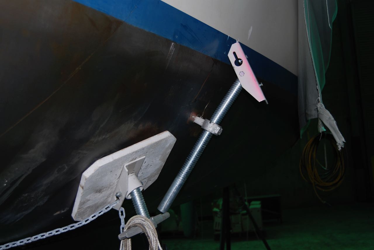

Here you can see where the chains were attached. This photo was taken after the boat was upright and in a warehouse. Notice the jackstand handle stuck in the hull. Of course the handle stuck in the only part of the interior that was not easily accessible. The boat is a Sabre 30. Sabre interiors are stick built, except for the sink and head, which are installed as a fiberglass pan. Guess what is on the other side of the hull here.
Nov 30, 2015
1,343
Wow, that really sucks. Thanks for sharing the images and sorry for your previous loss. Mother Nature sure has a lot of bitchy weapons in her arsenal. There’s no predicting something like this considering any cumulative weather contributions.
I’m gonna guess the head and possibly a holding tank below the waterline...just adds insult to injury.

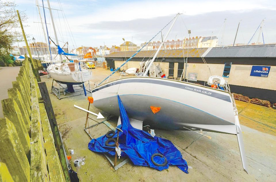

Even if the cradle is solid, boats can be blown over. The gravel ground probably contributed to the one below but there was quite a wind, gusting over 80 knots very briefly. This was with very little windage, the mast was down and there was no cover on the boat.

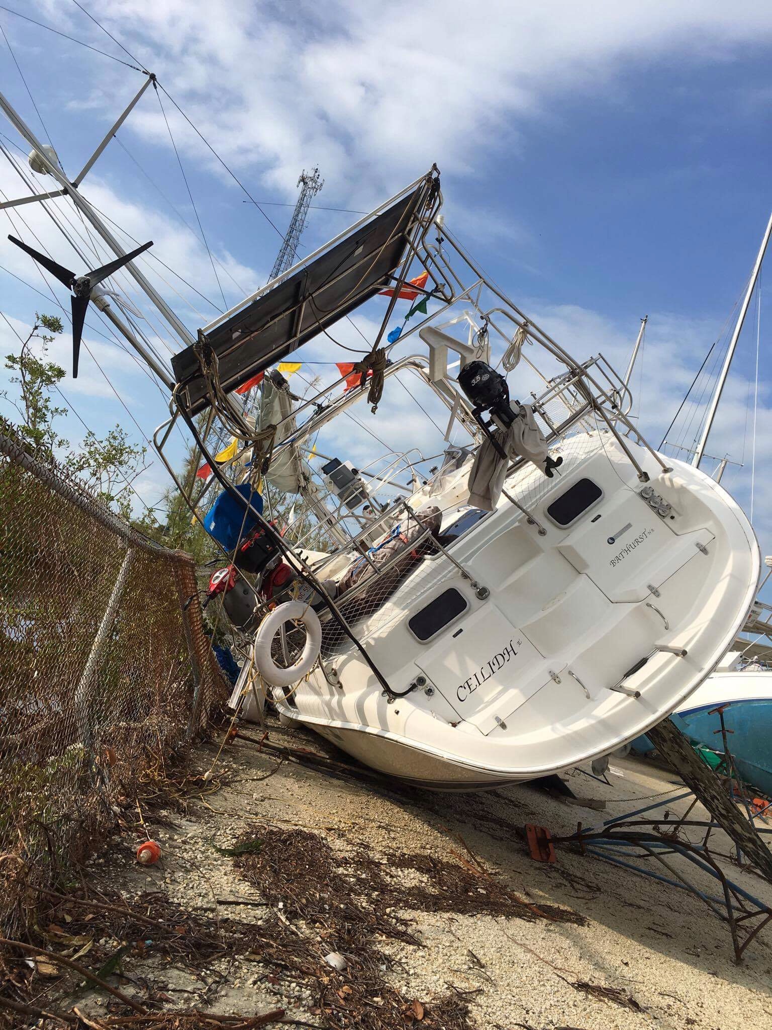

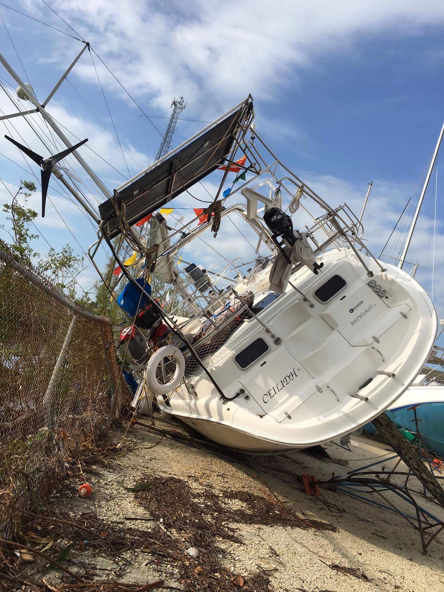

Irma gave us a nice gift. Im not sure the passaga 456 was braced solid in Marathon. Anyway I had it transported in Canada on a truck float. Over $125,000 cdn damage.
14,300
Irma gave us a nice gift. Im not sure the passaga 456 was braced solid in Marathon. Anyway I had it transported in Canada on a truck float. Over $125,000 cdn damage.View attachment 149282
Ouch!
I'm assuming the storm surge got you and not the wind. There is still a lot of windage on the boat that would have caused trouble.
