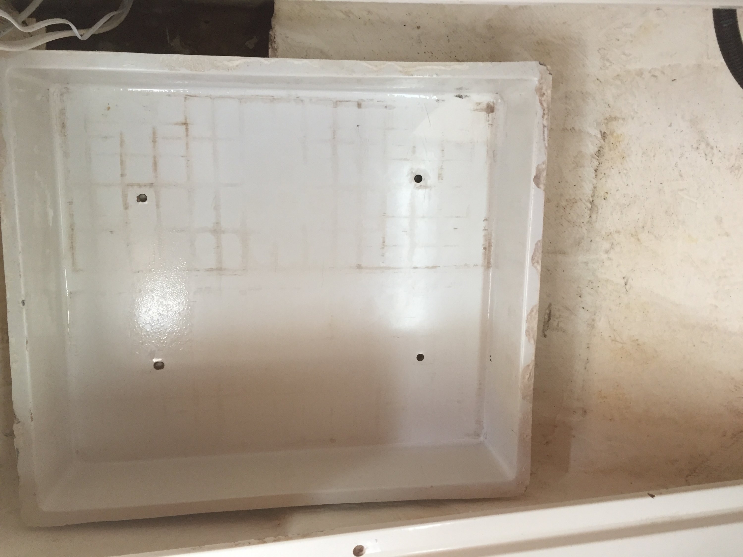

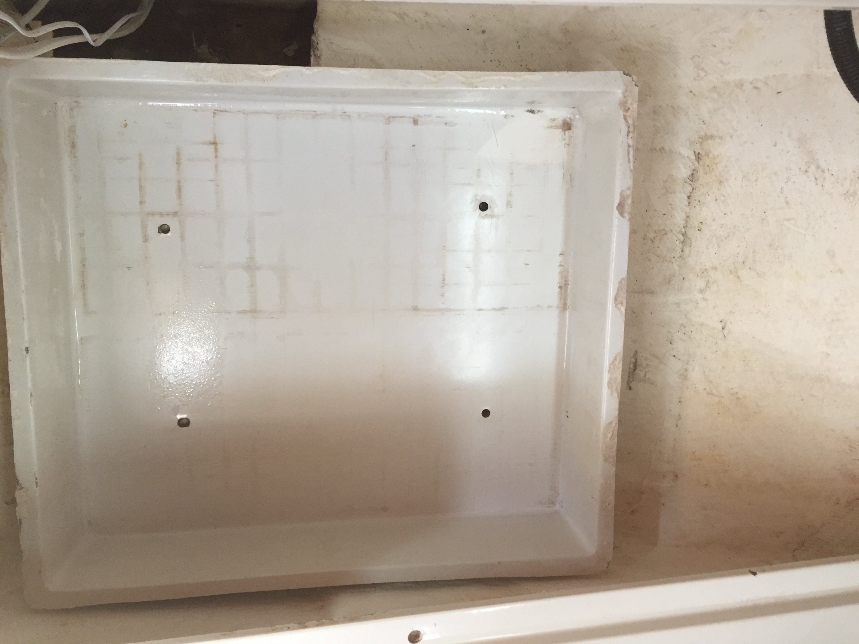

Those of you who have done battery upgrades on your C310: how did you manage battery tie downs? I'm installing 4 GC2s under the settee, replacing two 4Ds. There's a piece of 3/4" (?) plywood making a flat surface there and the 4Ds were sitting in a tray that had been screwed into it. The screws all had corroded away (no surprise) leaving 4 holes in the bottom of the tray, making it less than sealed. A 2x4 and 2x2 were jammed between the batteries and the top edge of the seat to hold them in place.
I'm tempted to use 4 GC2 battery boxes, and strap them down to the plywood (using proper straps). Ideally I would thru bolt the brackets for them, but there's no easy access under the plywood; so they'll have to be screwed in, I guess.

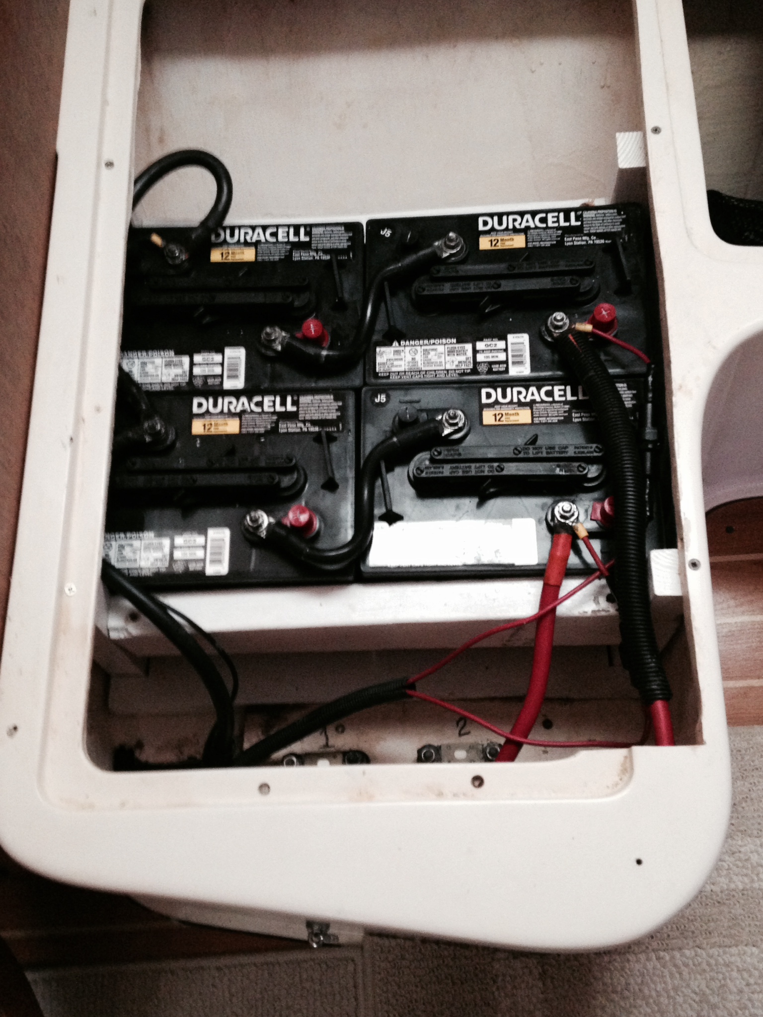

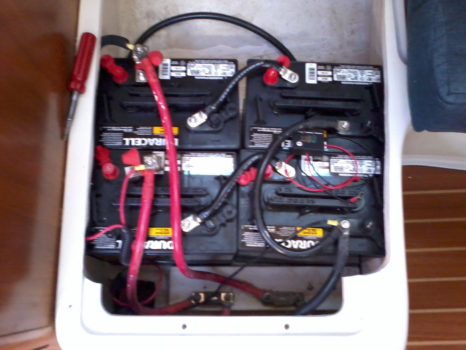

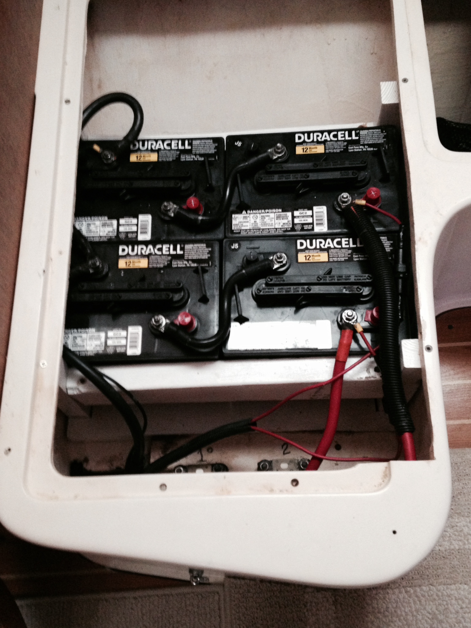

I'm informed my batteries are oriented incorrectly (they should be rotated 90 degrees). However the 2x4s inboard and outboard of the batteries hold them tight. Even if the boat went upside down, they could not slide out.

Are they in a tray for containment?

KZW, I think ventilation between the batteries is the concern, so yeah, if space allows, turn them
No, and neither were the two 4Ds they replaced. I couldn't find boxes that fit the batteries within the available space.

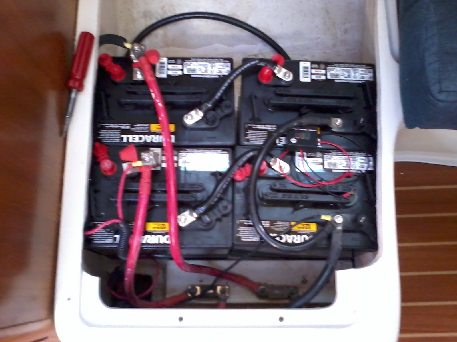

Ventilation? i.e. space between the batteries? Why? Heat dissipation?
I have a 20 Amp computer charger, constantly plugged in at the dock (to run the reefer and A/C) and heat has never been an issue, not even in the rather warm FL summer. Underway, the biggest draw is the reefer and the batteries don't get warmer than the ambient air.

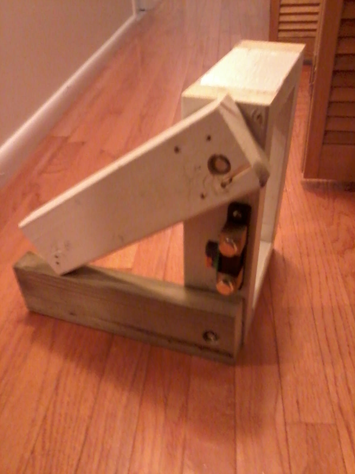

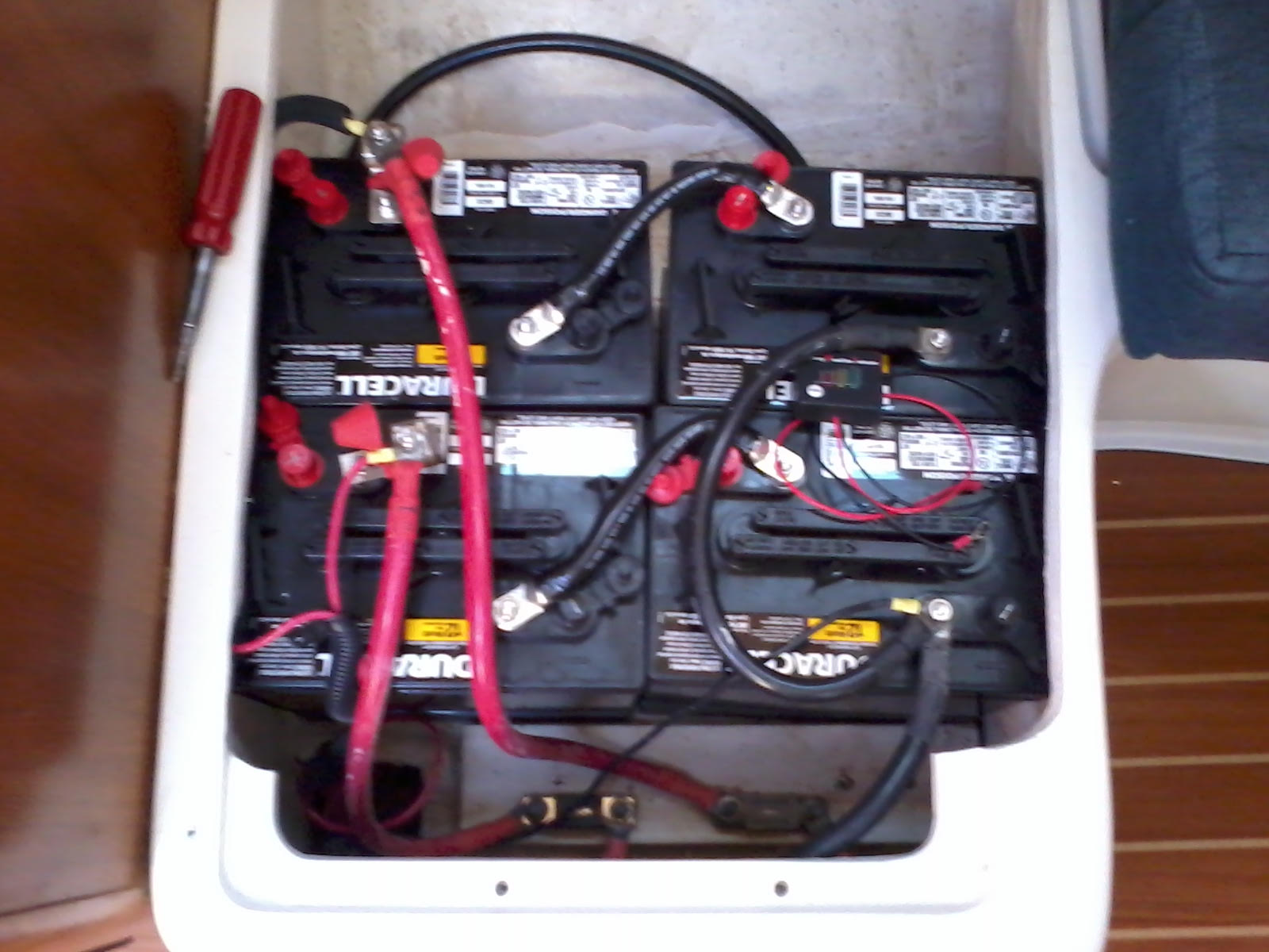

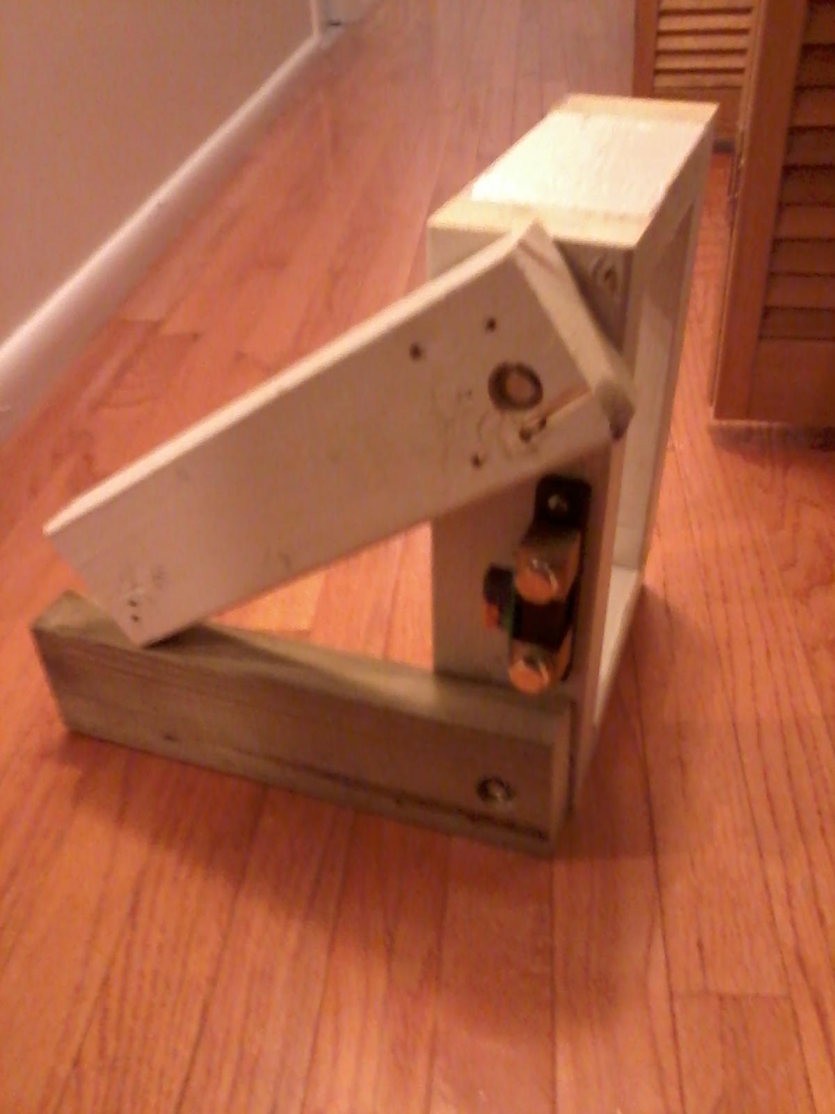

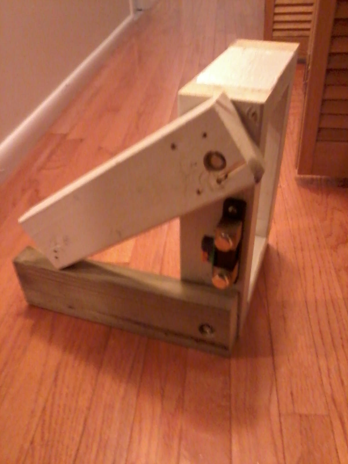

OK, mine are oriented the wrong way, but they fit and I don't spend all that much time heeled over which is the concern (e.g. if you are heeled over the plates could be exposed). They came that way from the factory and that is my story and I am sticking with it. When I swapped out the 4Ds the GC2s were about 1" higher so I could not use the 2x4 but they were also slightly wider so they did fit under the lip of the seat so they were not coming up. So I made up a new bracket to hold the batteries tight in their place that used the existing holes.

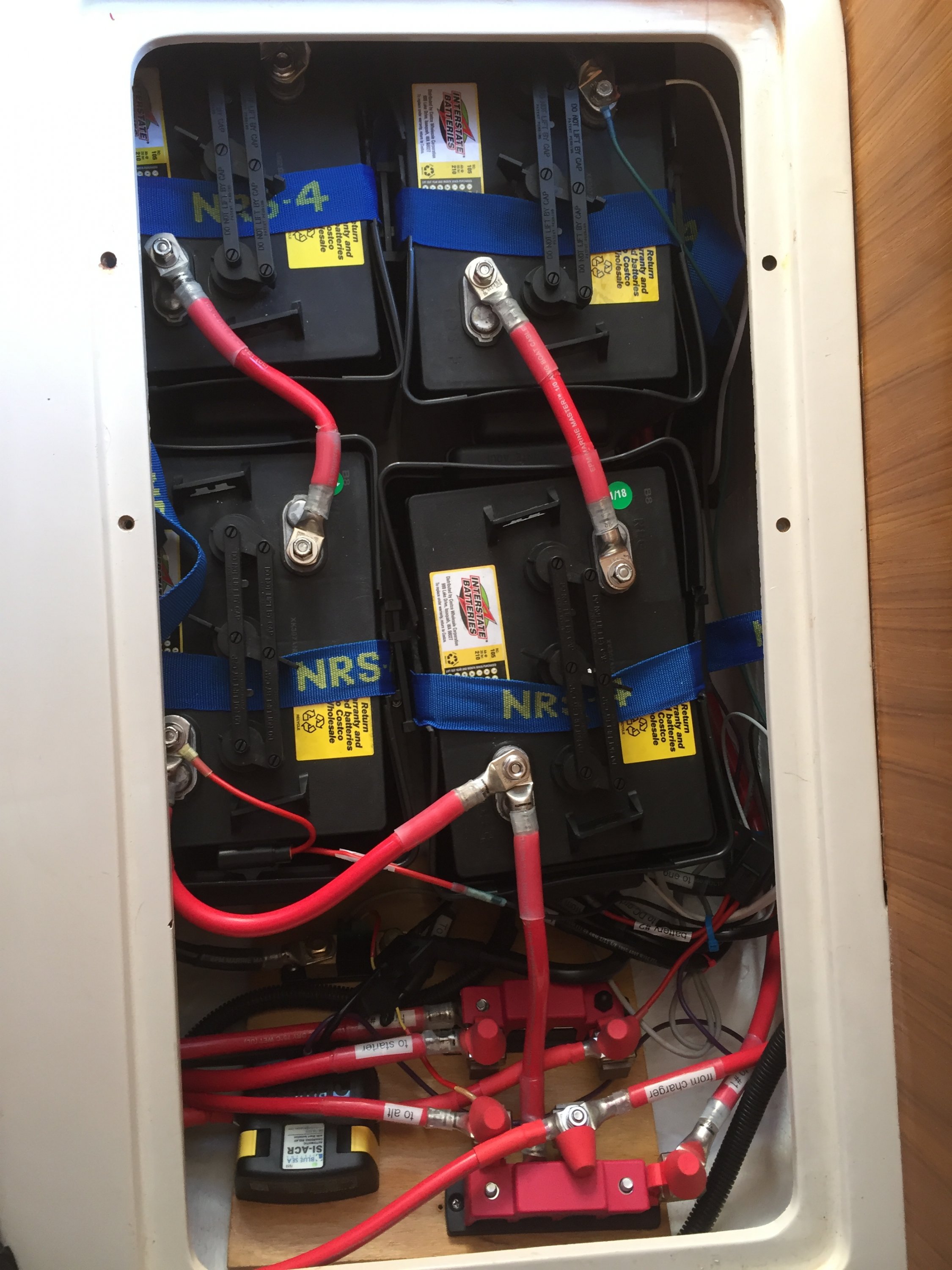

I remember that your compartment is cut out wider than mine. I was able to fit the 4 GC2s inside battery boxes with straps holding them down. Not beautiful, but I think it’s functional. Still trying to decide if I should install covers on the posts.
