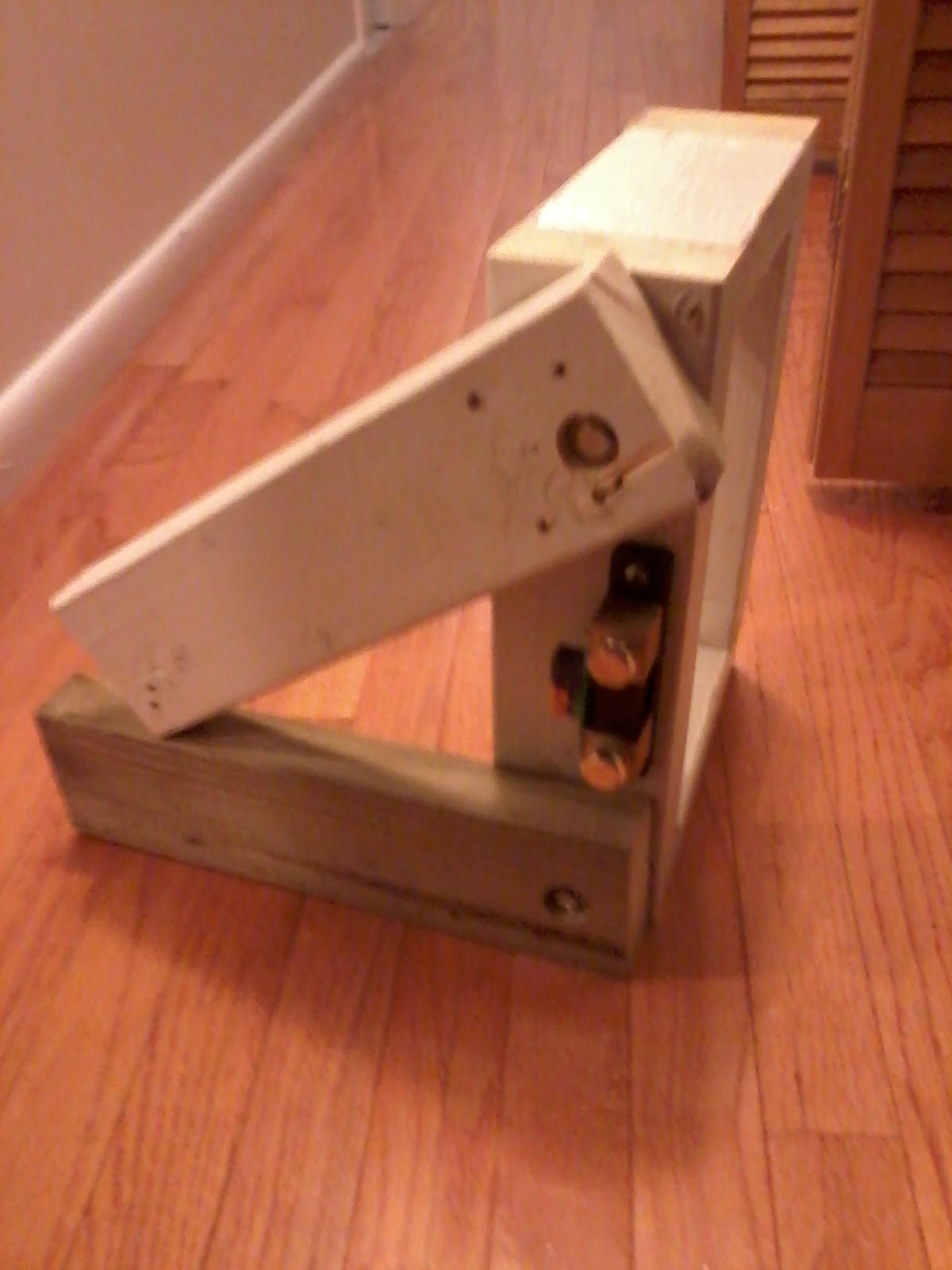

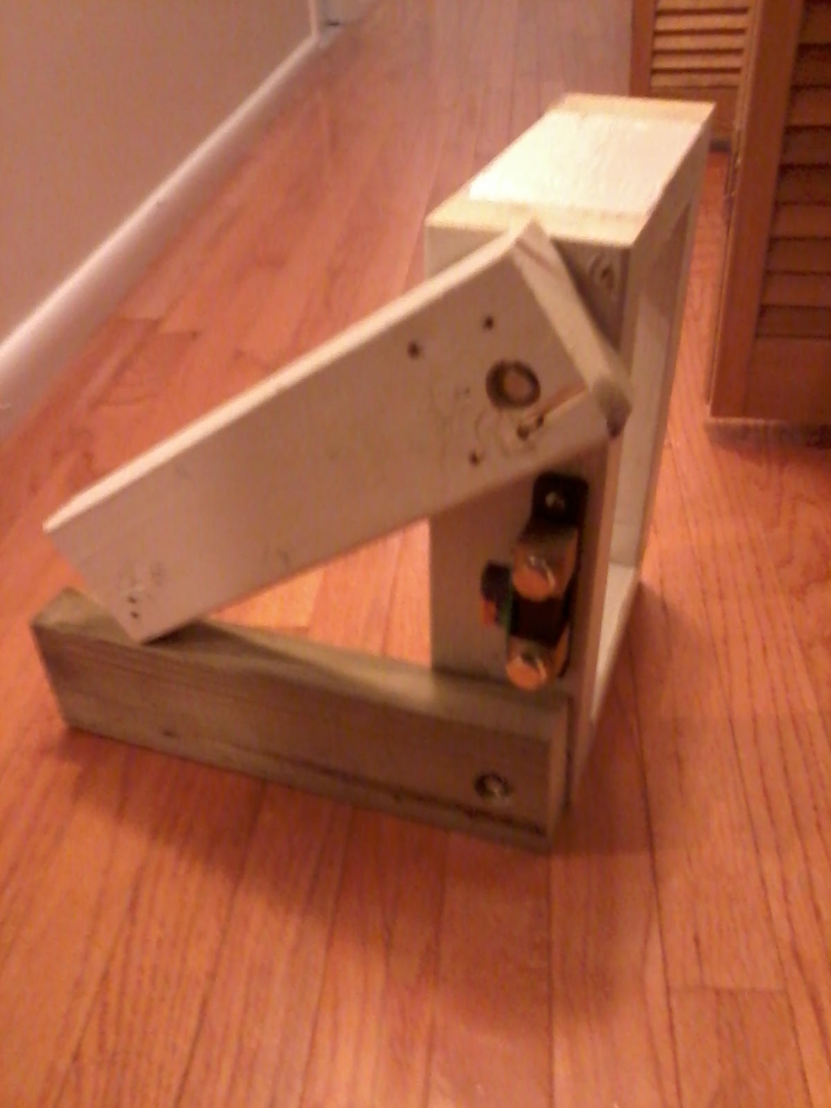

Ray, it looks like someone did some surgery on your seat to make it easier to get those batteries in/out! I also noticed that your batteries are not in the optimal orientation http://www.pbase.com/mainecruising/flooded_battery_orientation
You are correct about orientation, but I have never had a problem. Did not have to do any surgery, but since the golf cart batteries are about 1" higher than the 4D's I had to modify how the batteries are secured. So I came up with this so after the batteries were in, I could slide this in, extent the tops extensions and screw them into the holes in the settee bottom like the original board. The electronics you see in the middle are the shunt for the Victron monitor.
