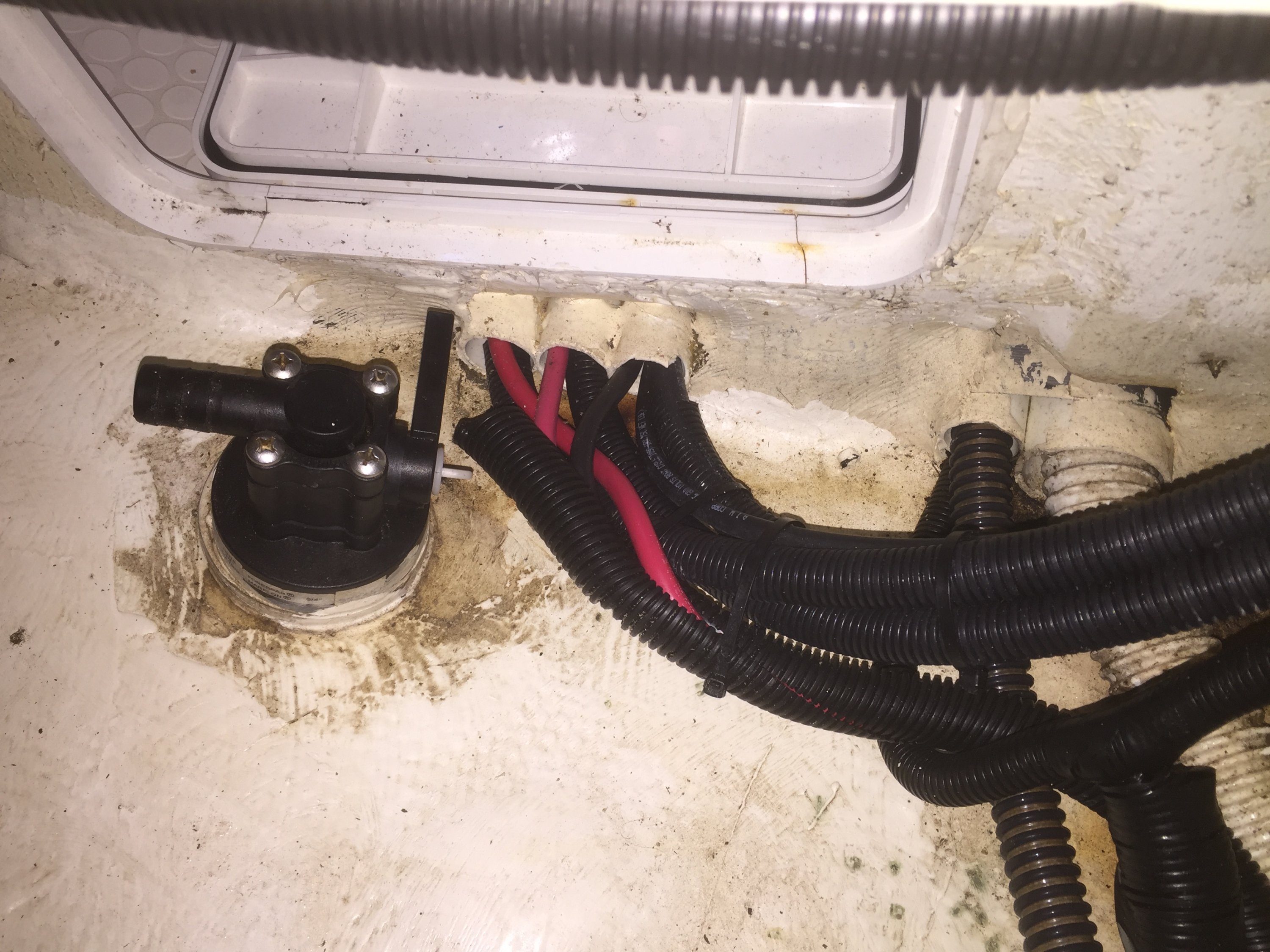

I ran another conduit next to the two factory conduits. At the time I was considering putting an inverter charger on but ended up going with separate units based on Mainesail's advice based on the redundancy of having two separate units. In hindsight I would do a combined unit. I gave up 1/3 of the settee locker next to the batteries for the inverter to get it to not have too much voltage loss. The inverter charger unit would have mounted in the back and would have saved space. Cruise small requires some sacrifices and that is one I wish I did different.
Interesting. Our 2000 310 has three conduits installed. Still tough getting everything to fit! Makes me think that adding a fourth might be a good idea.

Interesting. And I have two thruhulls there.
That’s the (now unused) head intake. I’ll bet your shower/reefer drain pumps out the other thru hull, while ours is under the galley sink. Not sure why they made the changes, or if one is any better than the other.

Nope. Our head intake, now used for our watermaker, and the macerator outflow.

Same here...Hull #48. I have the Macerator outflow and the head intake both there. I'd have to check the conduits...can't remember what I've got. Maybe I'll check on Sunday when I take the mast down for the winter.

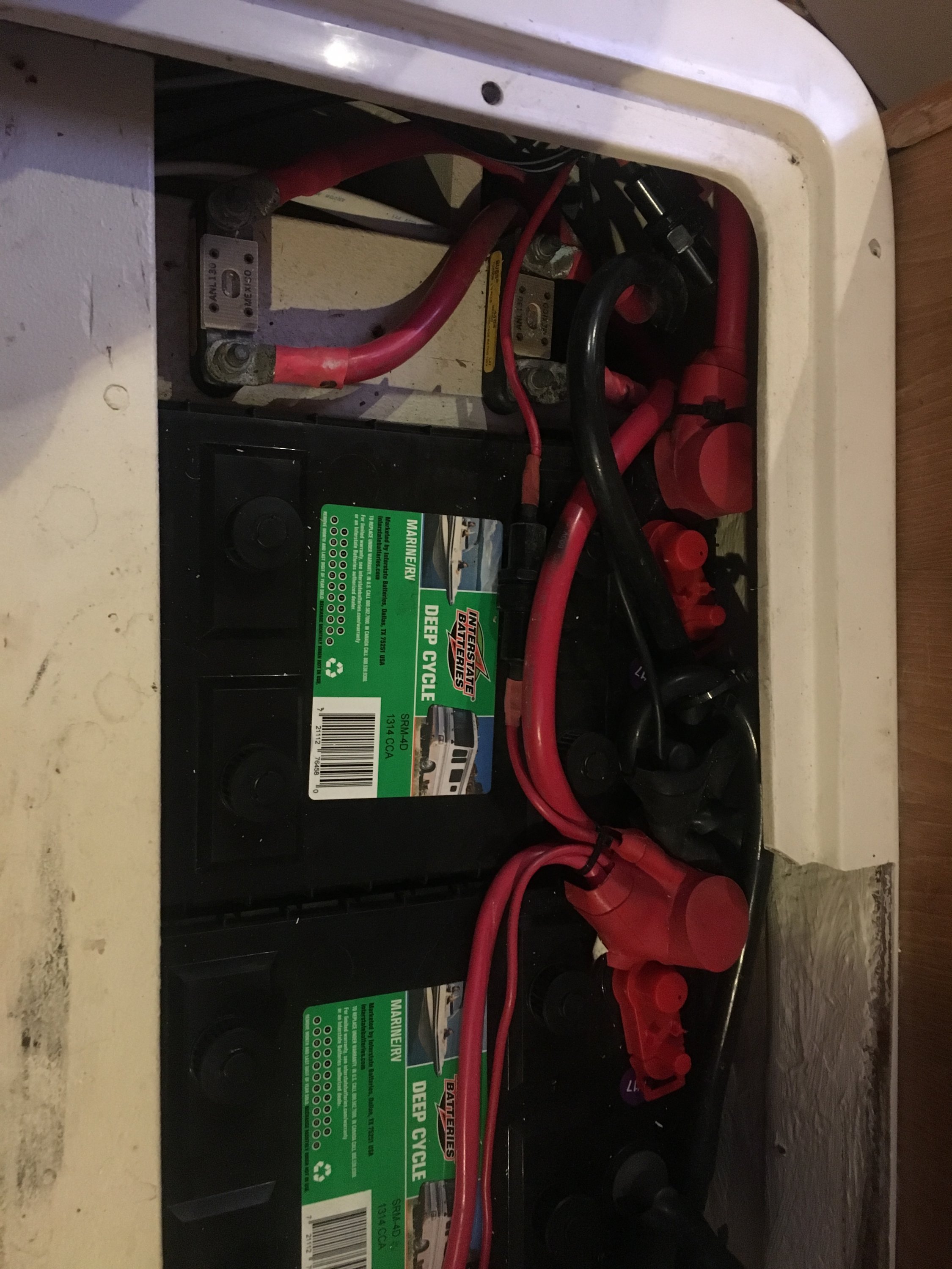

Down at the boat checking out the battery system. Two new in 7/17 interstate deep cycle marine/rv, SRM 4D, 1314cca, nothing about ah.
The charger is a Charles 20amp. The wires from the charger to the battery are 10 awg, there is a ktk 30amp in-line fuse on each positive leg.
There is a 1000w inverter in the port settee wired to the main panel with a transfer switch, that powers all 110vt outlets and microwave. That is powered by one battery directly through a 100 amp breaker.
There is a 400w inverter in the port cabinet in the v birth wired directly to one battery through a 40amp breaker.
So that’s my system, good, bad, ugly?
Thanks, Mike

The first thing that jumps out at me is what appears to be a burn on the main feeder wire near a small inline fuse.
While the batteries you have are labeled deep cycle, they aren't. They are truck starting batteries. And they are back breakers. About 140 pounds each. They are about 185 amp hours each new but will quickly decrease from there with the under sized, "dumb" egg timer charger that doesn't have the ability to equalize. Like I said in a previous reply many other owners have switched to four 6v golf cart batteries instead of these beasts. Mainesail has a great article on his site on deep cycle batteries. Oh, and the batteries are oriented incorrectly shortening their life and possible acid spills.
I guess the 400 watt inverter is to lower the draw while using a TV. Not really needed. Many of the 22 inch flat screens on the market are actually run on 12 volt with an inverter built into the plug. We have a Super Sonic from Amazon and I cut the wires and wired it directly into the breaker panel. It's redundant and could be eliminated.
The 1000 watt inverter seems a little small. Trying putting a load on it and see what happens. Like using a heat gun. I have a 2k watt and find it small at times.
It's a pretty standard system for the 310.

I seen the burn mark as well. Just on the surface. Not sure if a fuse blew or if it was done while heat shrinking the fuse holder.
Maybe it’s hard to tell but the batterys run bow to stern the long way. I searched mainesails site and according to what I read that is the proper orientation for 4D batteries.
Good. I was basing that comment on the factory setup but it sounds like someone already fixed that.
It's not a bad setup. Just can be improved. I would. Still recommend not doing much in the first year. Spend some time with the boat to see what you would like and what you would change. (Except the charger, I would do that before next year.)
We have owed the boat for 8 years, lived aboard for about 5 and been in the Caribbean for a bout 2 years. I still haven't decided on the best options for certain things. And that's just for us. Everyone has different wants and needs.
Good luck.

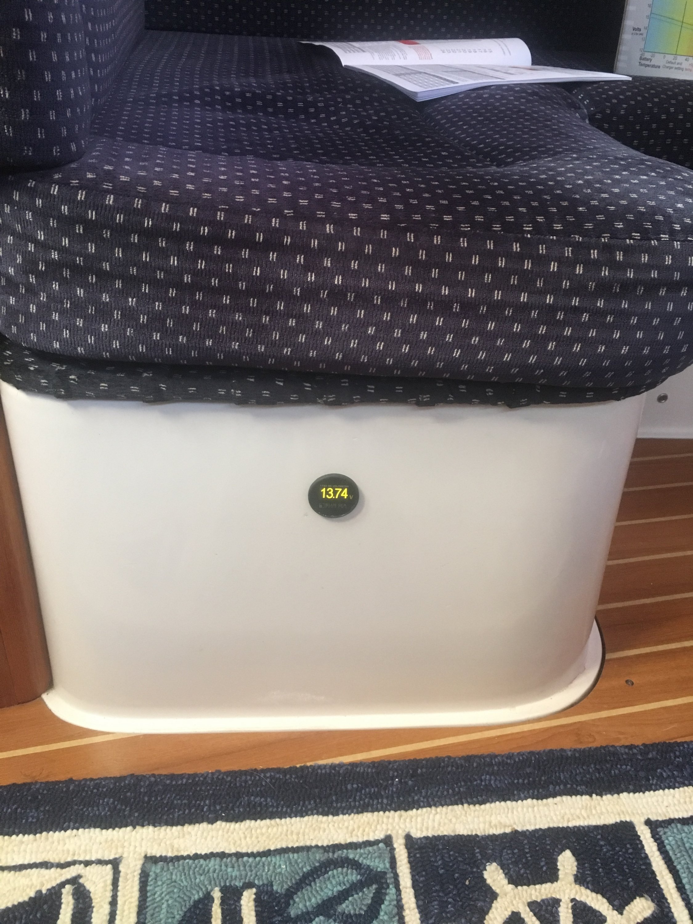

Got the volt meter installed last night.
Rob said keep it close to the batteries so I mounted on the side of the battery compartment facing the galley.

Mike, Question-Why the Blue Sea voltmeter model 1733 instead of the Blue Sea multimeter model 1834?
Besides the cost difference.
